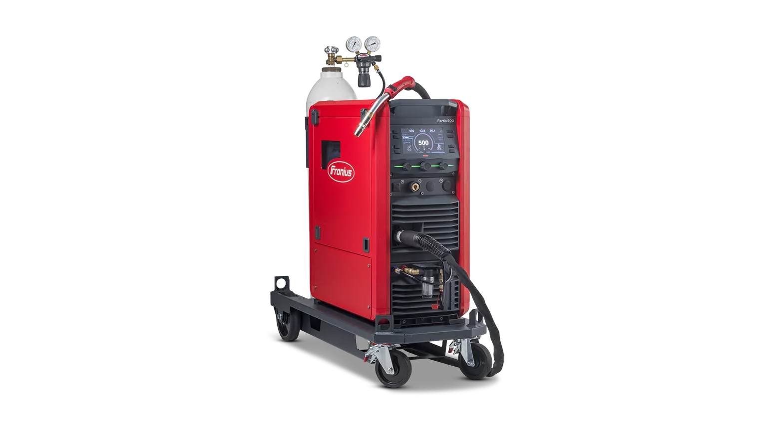

Fortis MIG/MAG
Technical Data
General Data
| Welding current min. | 3 A |
| Welding current max. | 500 A |
| Operating voltage min. | 14,2 V |
| Open-circuit voltage | 93 V |
| Dimension / length | 681 mm |
| Dimension / width | 368 mm |
| Dimension / height | 763 mm |
| Weight | 42,1 kg |
| Weight | 42,73 kg |
| Weight incl. packaging | 48,26 kg |
| Interference emission class | A |
| Schweißprozess | Wolfram-Inertgas |
| Maximum working voltage | 44,2 V |
Technical Data
| Power Factor (pf) | 0.99 |

Function overview - Fortis
| Features | Fortis 270 C/G | Fortis 320 C/G | Fortis 320 C/GW | Fortis 320 /GW | Fortis 400 C/GW | Fortis 400 / GW | Fortis 500 C/GW | Fortis 500 /GW | |
| System design | Compact | x | x | x | - | x | - | x | - |
| External wirefeeder | - | - | - | x | - | x | - | x | |
| Gas-cooled | x | x | x | x | x | x | x | x | |
| Water-cooled | - | - | |||||||
| Mains voltage variant | 400 V | x | x | x | x | x | x | x | x |
| Single-phase operation (XT variants only) | Up to 240 A | x | - | - | - | - | - | - | - |
| Up to 270 A | - | x | x | x | - | - | - | - | |
| Up to 320 A | - | - | - | - | x | x | x | x | |
| Generator-compatible | XT variants only | x | x | x | x | x | x | x | x |
| Multiprocess | TIG | x | x | x | - | optional | - | optional | - |
| MMA | x | x | x | - | optional | - | optional | - | |
| Connectivity | Bluetooth | x | x | x | x | x | x | x | x |
| NFC | optional | ||||||||
| Ethernet | optional | ||||||||
| Data management | WeldCube Air WeldCube Premium | optional | |||||||
| WeldCube Navigator | optional | ||||||||
| Options | Duo | - | - | x | - | x | - | x | - |
| Wired remote control | x | x | x | x | x | x | x | x | |
| Wireless remote
control |
| Toolbox |
| Organizer | x | x | x | x | x | x | x | x | |
| Flow Sensor |
| Welding torch holder | x | x | x | x | x | x | x | x | |
