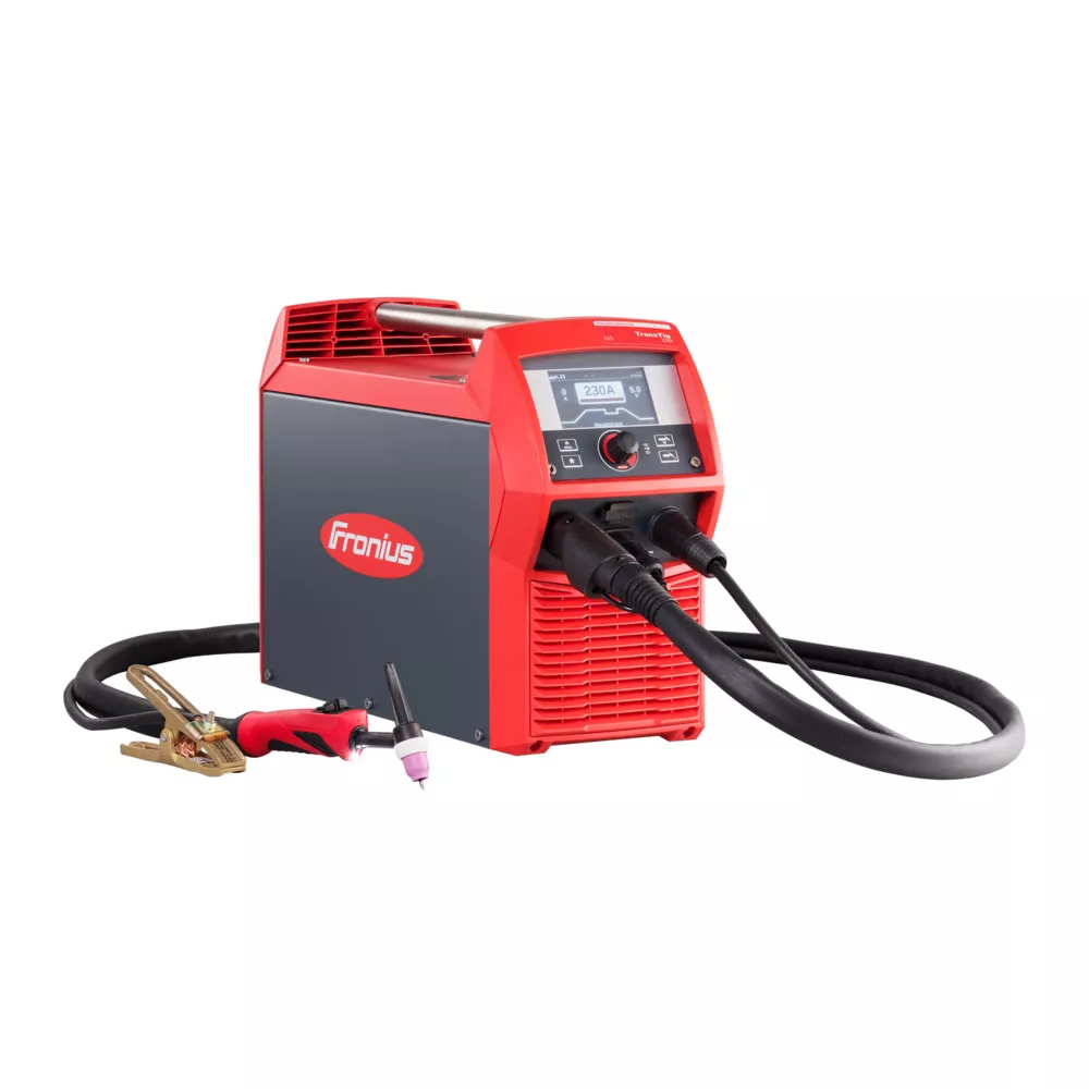

Manual welding in container construction
Typical applications
Welding systems
For manual welding in container construction
MagicWave series
  • AC TIG welding system
  • Intuitive and self-explanatory menu navigation
  • Can be expanded with optional function packages
TransTig series
  • DC TIG welding system
