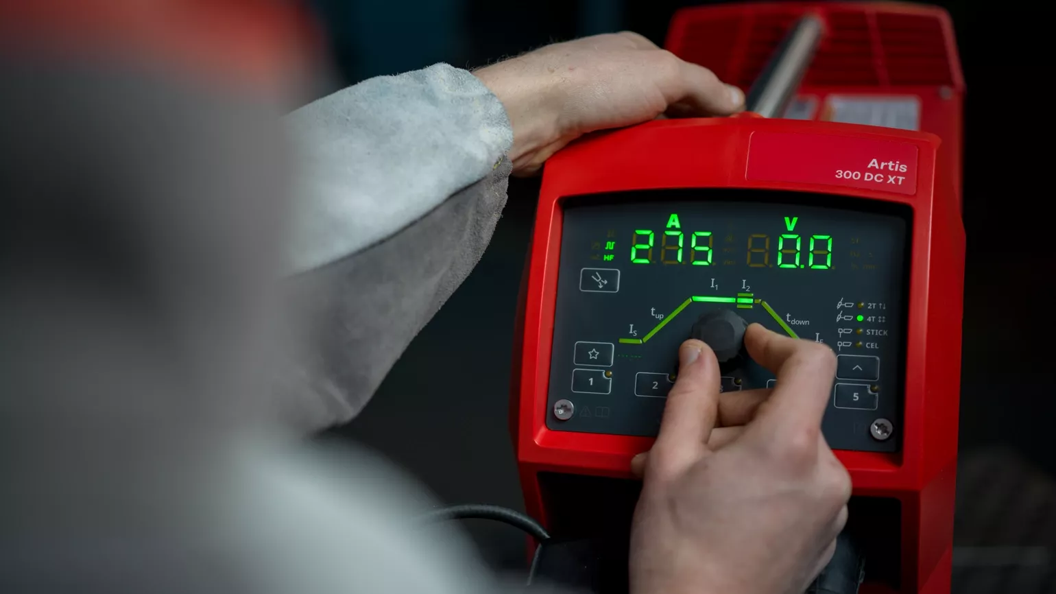

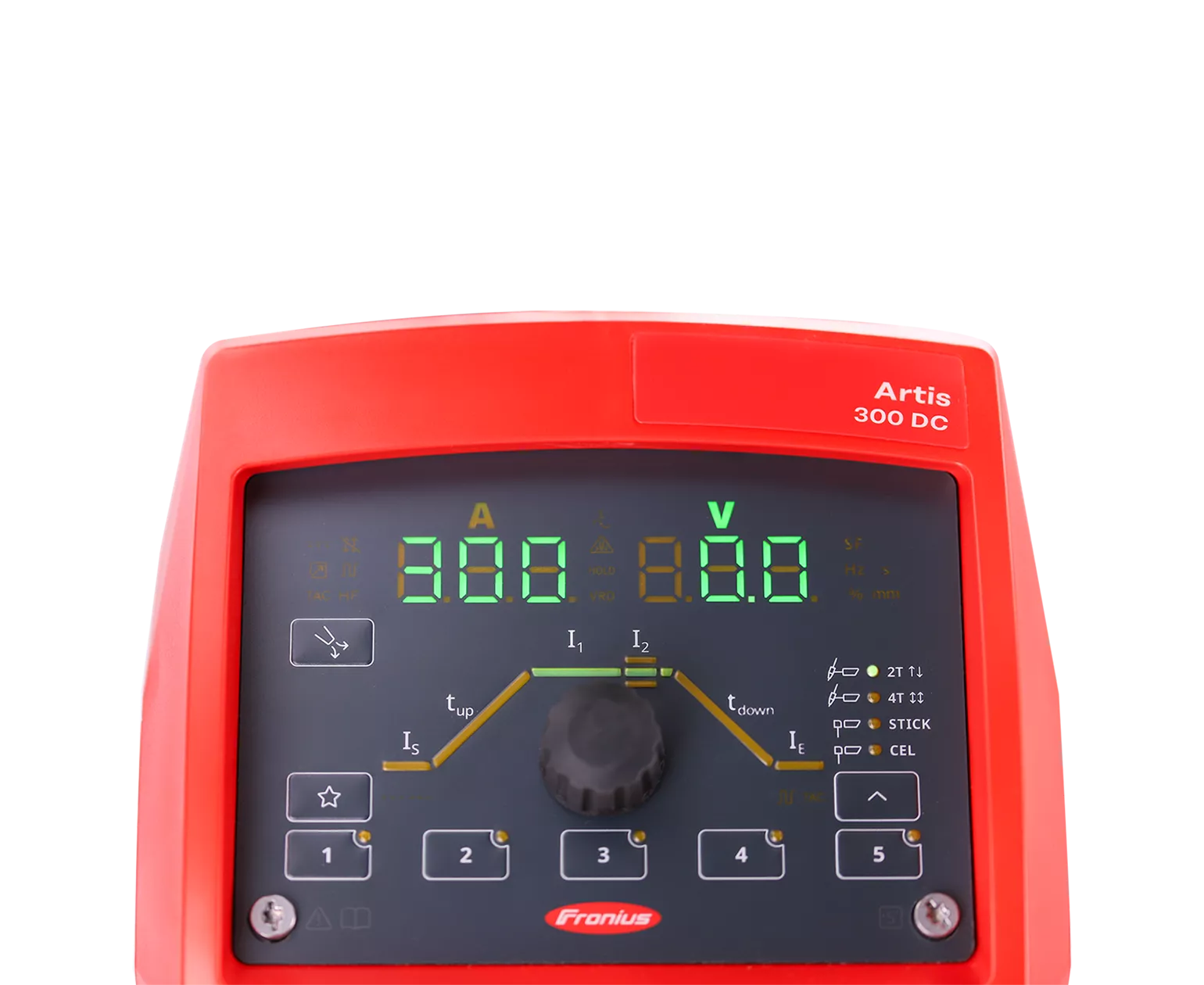

Favorite button
The Favorite button allows you to access the most important background parameters in one easy-to-use step.
5 EasyJobs
5 EasyJobs simplify repetivie welding.
Welding current display
A clear welding current display allows precise control over the entire welding process.

Artis welding machine—operating concept at a glance
Clear function display and intuitive navigation using rotary and push button. Over 10 parameters can be selected directly and without a background menu.
