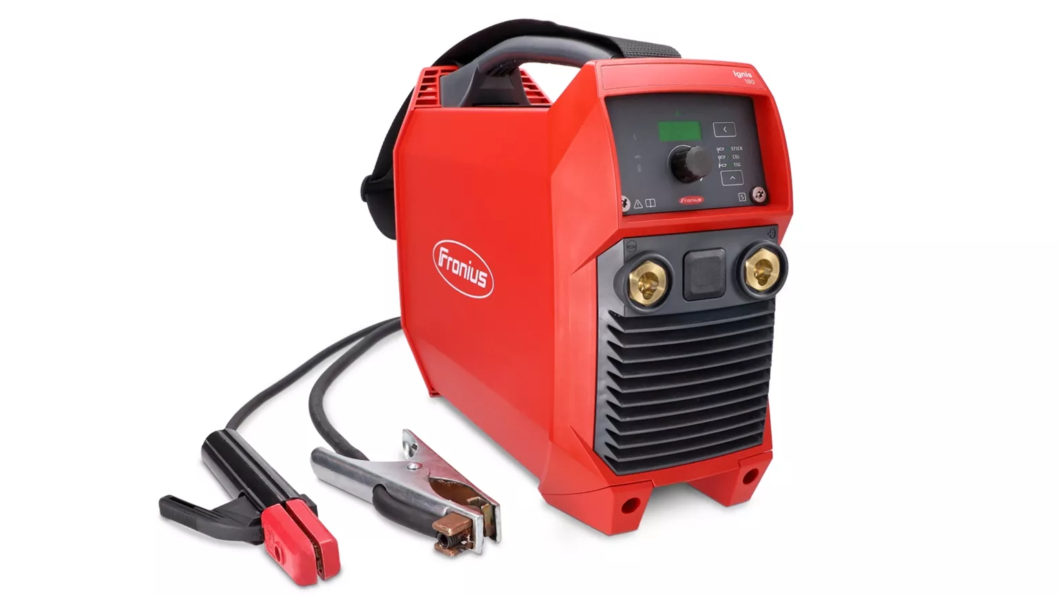

Ignis 150, 180 and 250
The Ignis is available in the power categories 150, 180 and 250 A.
In addition to the robust housing and the simple, intuitive operation, the Ignis also has numerous functions that make MMA welding easier for the user: HotStart, SoftStart, or anti-stick provide support when starting welding as well as during the welding process. The MMA Pulse function enables better-looking welds and even faster welding.

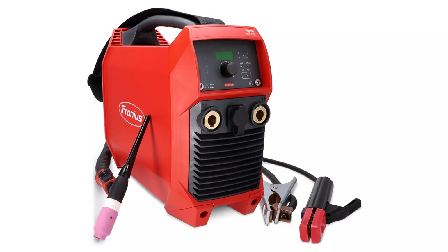

Ignis 150 TIG and 180 TIG
The TIG series is available in the power categories 150 and 180 A.
Thanks to its additional functions, professional TIG welding is an option in addition to MMA welding. TIG Comfort Stop prevents annoying arc breaks at the end of welding, while TIG pulse offers better control of the weld pool in out-of-position welding and when bridging gaps. An integrated gas solenoid valve has also been added.

The Ignis TIG version offers you extended TIG welding functions:
  • TAC tacking function
    One spot to tack is all it takes. The pulsed arc sets the two weld pools in motion, making them “jump together” in next to no time, forming one single weld pool. The TAC function is also very useful when welding light-gage sheets without filler metal.
  • TIG Pulse
    This function (up to 990 Hz) enables precise control over the weld pool and ensures excellent seam jointing. The pulsed arc makes it easier to work with very thin materials, because the temperature is slightly lower in the phases with less current.
  • TIG Multi Connector
    One solution fits all: this universal connection for system components, such as welding torches with special functions (Up/Down, potentiometers) or remote controls, gives the user cross-product advantages.

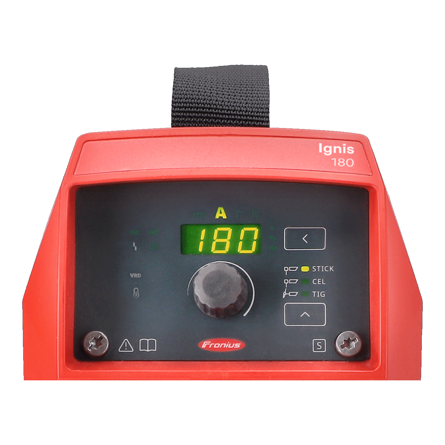

Intuitive operating concept
The clear operating concept and 7-segment display on the user interface make it possible to quickly read the parameters and simplify handling.
