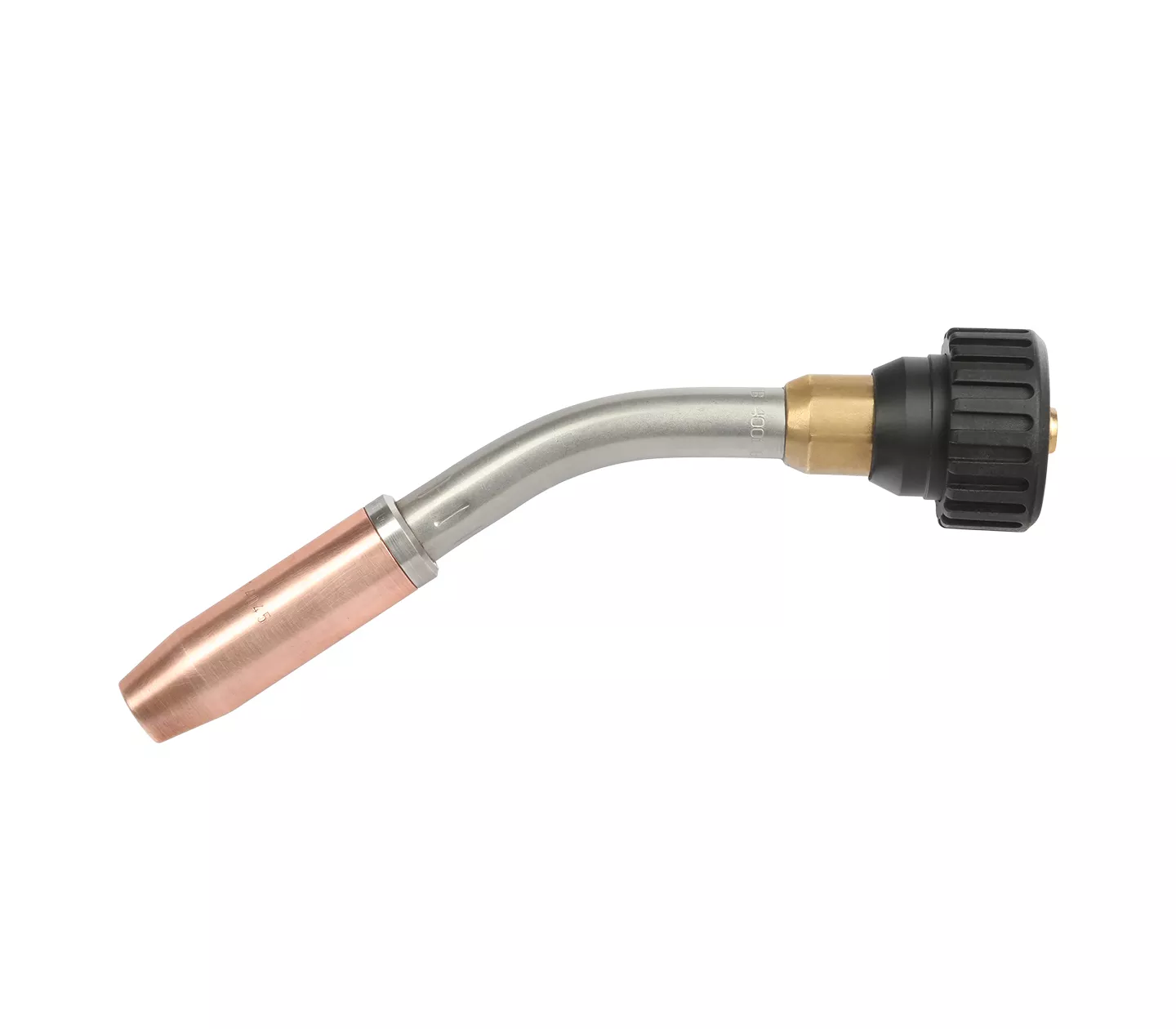

Long wearing part lifetimes
Designed and manufactured for the longest service life and for optimal heat dissipation. High-quality materials guarantee a long lifetime.
Long service life
Top-quality components maximize the service life of the welding torch.

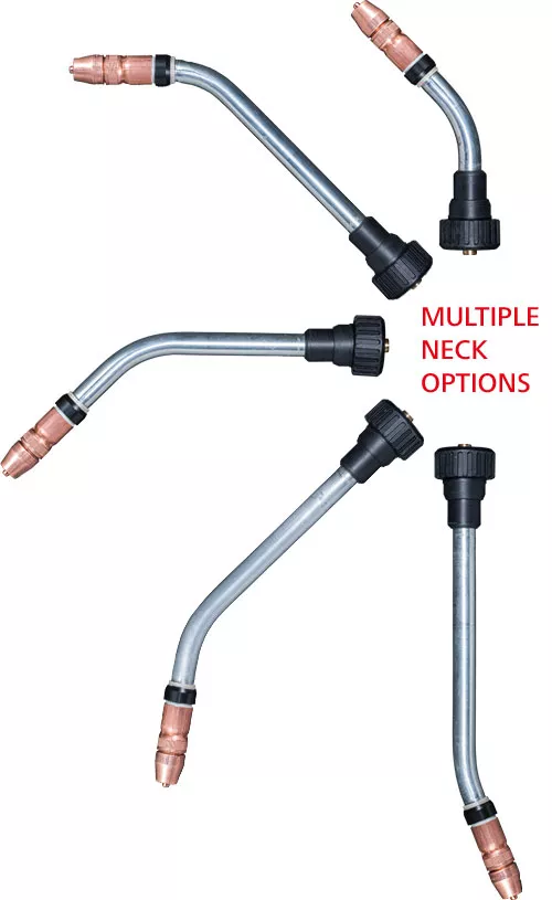

Flexible
We offer torch bodies of different lengths and angles, giving you the best flexibility for your application.

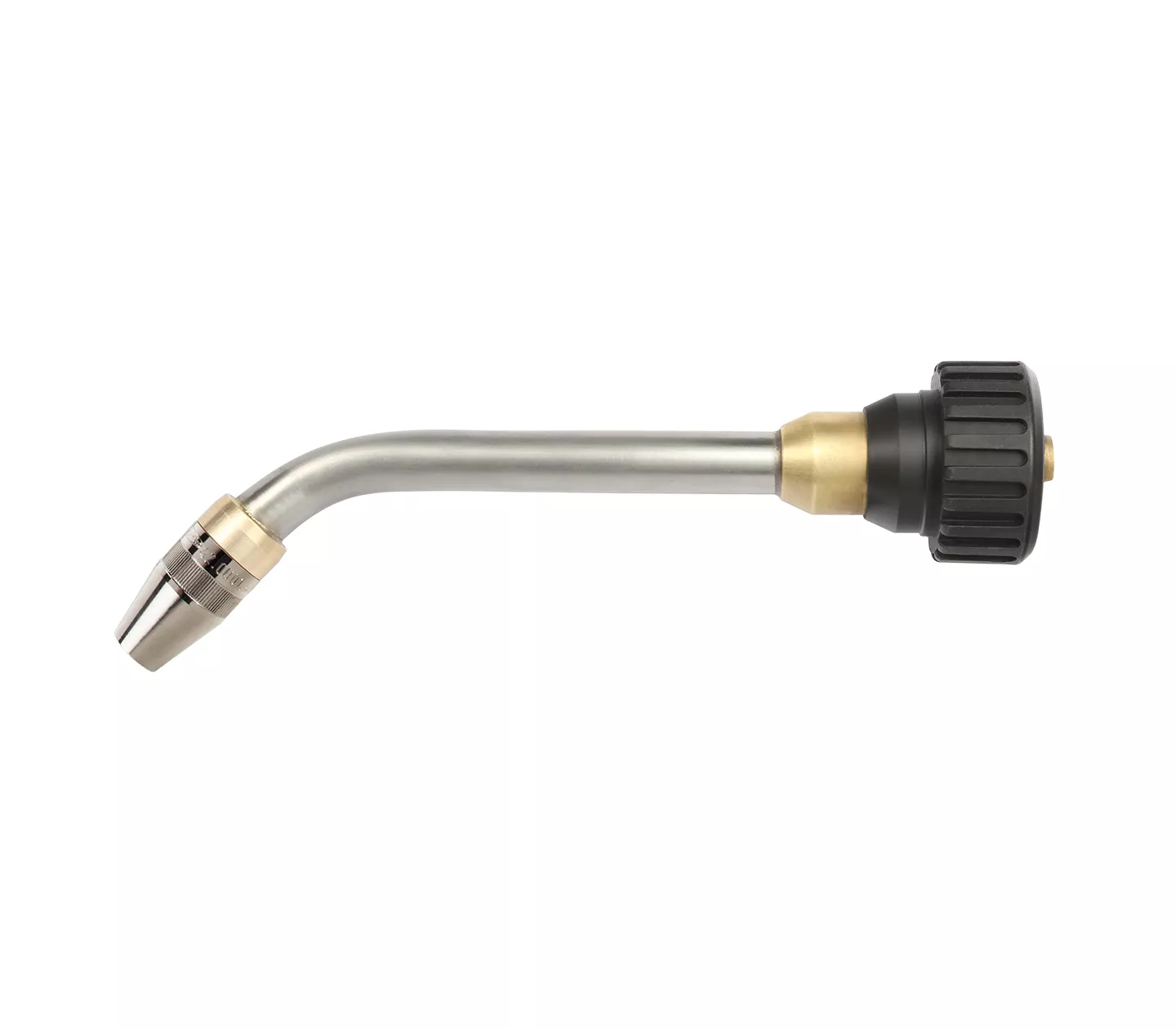

Water cooling system
On water-cooled systems the cooling system has been brought forward and outward as far as possible. The shape of the contact tip means that less radiant heat is now absorbed.
This alone brings a temperature reduction of up to 70 °C / 158 °F  for the wearing parts.

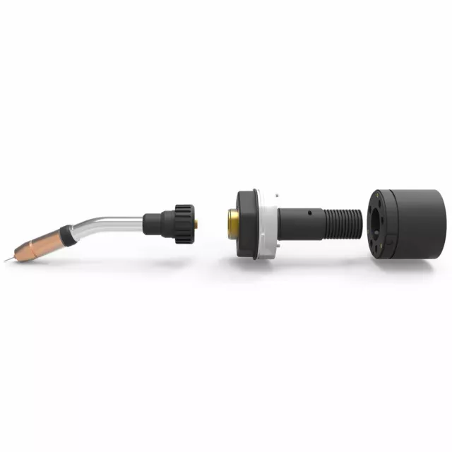

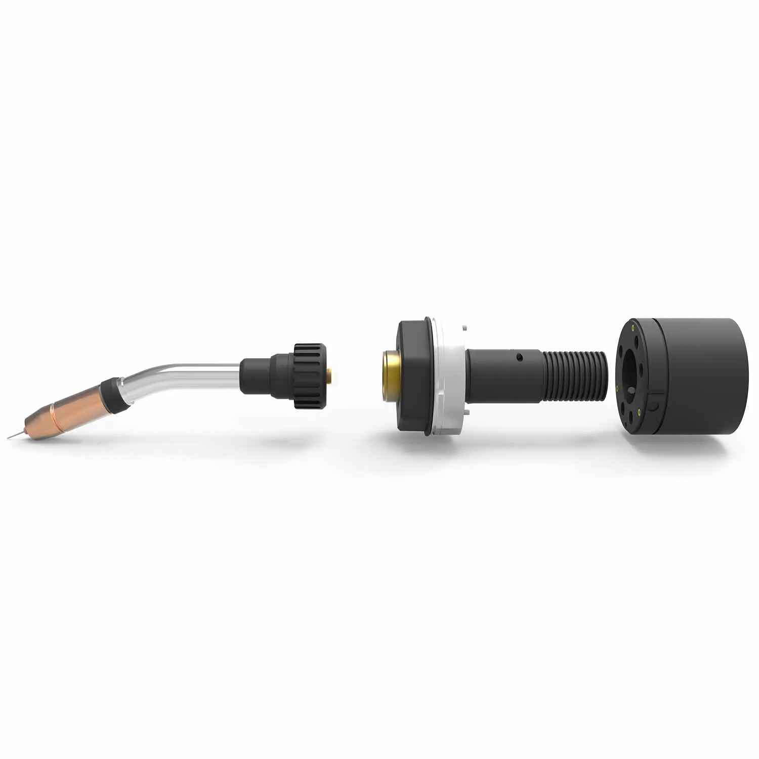

Contact Tip Changer available for following torch bodies
Robacta TX/i
Automatic torch body changeover in just 30 seconds
The complete torch body is changed automatically without the need for human intervention while production continues. This ensures that all wearing parts that impact on the TCP and weld seam quality are replaced
