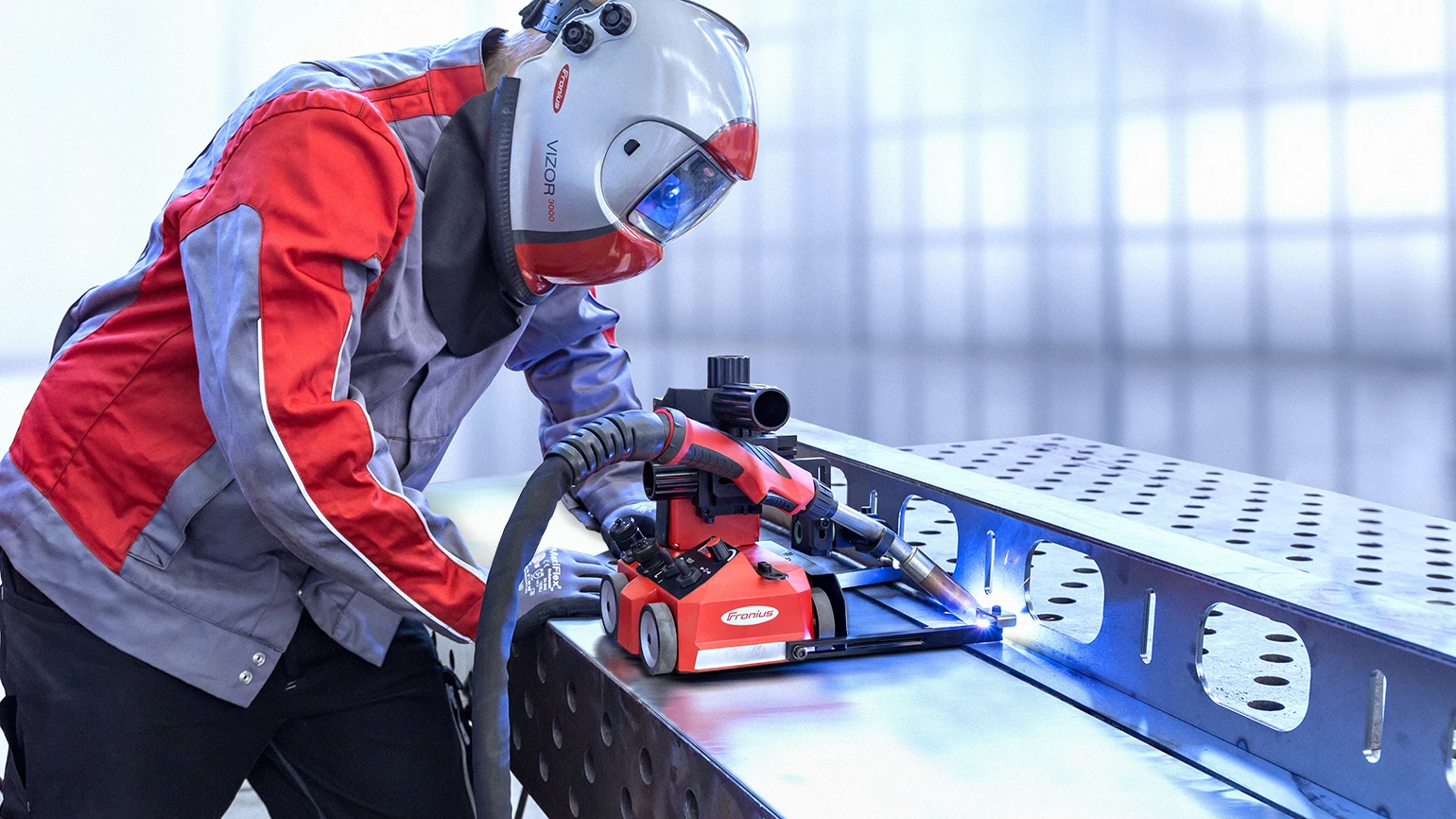

The compact welding tractor can be used in a wide range of applications. Depending on the requirements, one of three different rail types can be selected. The FlexTrack 45 Pro is perfect for all-round use in industries where surface geometries vary, such as in shipbuilding or container construction.

Welding tractor FlexTrack 45 Pro, longitudinal seam welding - overhead application

System highlights:
  • Flexibility: Modular rail concept for different welding applications on different component geometries
  • Comfort: Quick and easy set-up of rails and carriage
  • Precision: Precise movements and constant welding speed
  • Quality: Perfect reproducibility of welding results, particularly in conjunction with TPS/i power sources
  • Robustness: Compact cast aluminium housing, ideal for use under harsh conditions
