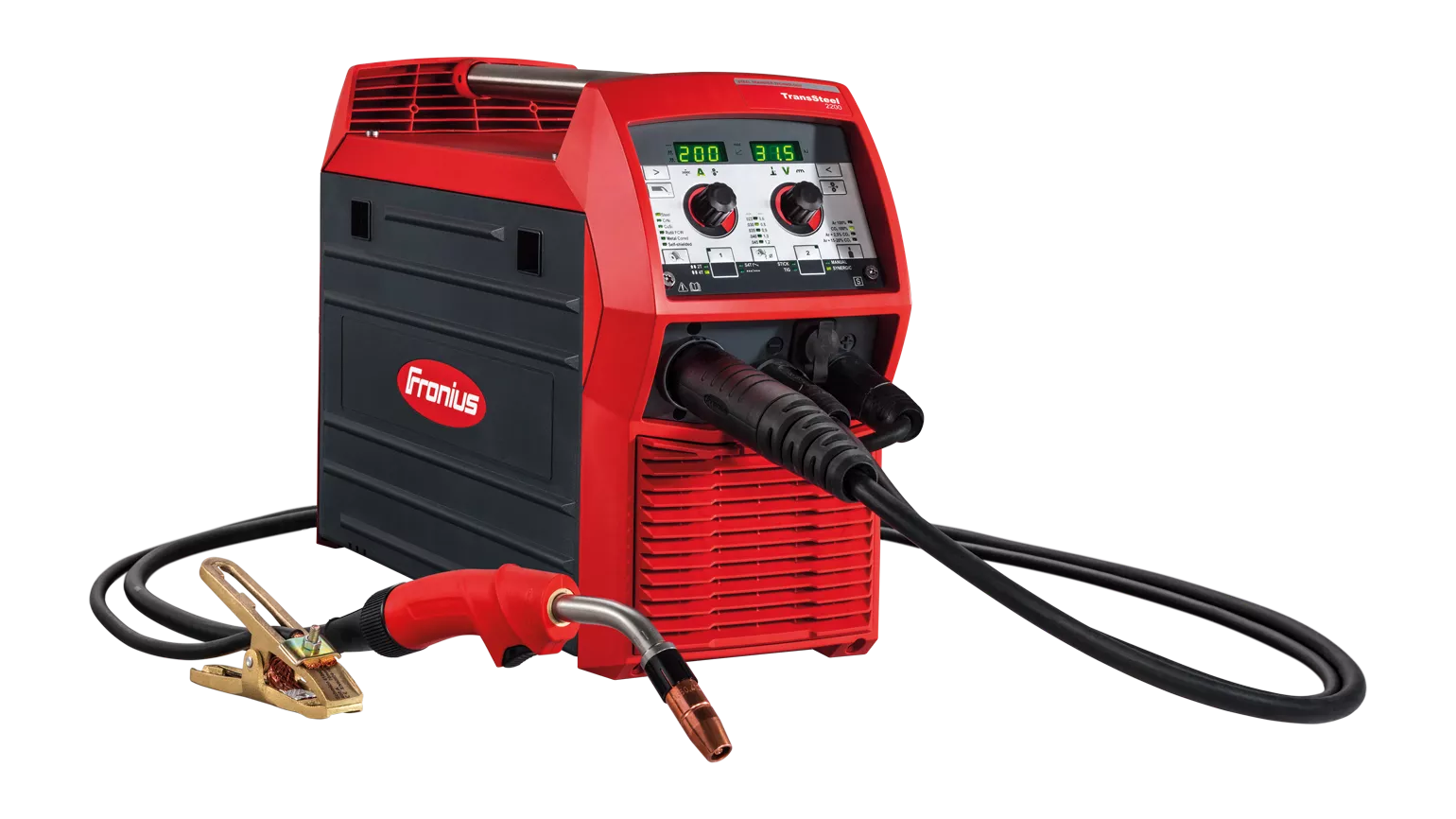

The TransSteel 2200 is a compact, 3-in-1 solution. It is the first single-phase inverter power source from Fronius that is also multiprocess-capable, bringing together MMA, MIG/MAG and TIG in a single device. The TransSteel 2200 is characterised by the intelligent design of the device, ease of use, robustness and a high level of reliability. Weighting only 15.5 kg, it is also one of the lightest devices on the market.

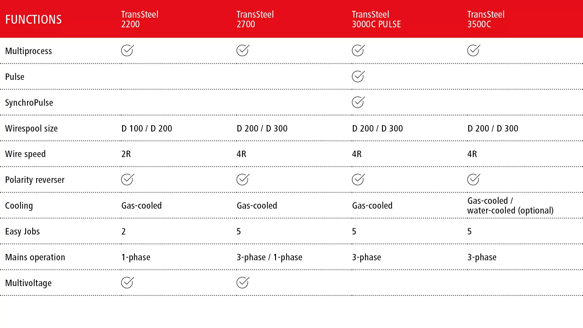

Technical Data
General Data
Mains voltage230V / 120V
Mains voltage tolerance-20% / +15%
Mains Frequency50-60Hz
Welding current min.10 A
Welding current max.230 A
Welding current / Duty cycle [10min/40°C]210A / 30% MAG, 180A / 35% MMA, 230A / 35% TIG
Welding current / Duty cycle [10min/40°C]170A / 60% MAG, 150A / 60% MMA, 200A / 60% TIG
Welding current / Duty cycle [10min/40°C]150A / 100% MAG, 130A / 100% MMA, 170A / 100% TIG
Operating voltage min.14,5 V
Open-circuit voltage90 V
Degree of protectionIP23
Dimension / length1,84 ft
Dimension / width8,46 in
Dimension / height1,21 ft
Weight38,58 lb
Weight incl. packaging45,17 lb
Mains cable includedYes
Earth connectionDinse
Einschaltdauer 2 (bei 40°C)30 %
Einschaltdauer 2 (bei 40°C)60 %
Einschaltdauer 2 (bei 40°C)100 %
Schweißstrom 2 (bei 40°C)135 A
Schweißstrom 2 (bei 40°C)115 A
Schweißstrom 2 (bei 40°C)105 A
