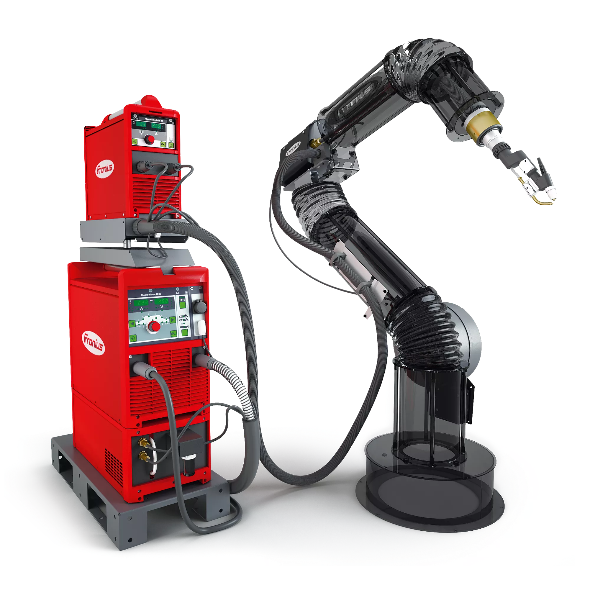

    The system – keeping the focus on the big picture
    At Fronius, every welding process is looked upon as a system, right from the outset. This is the only way of ensuring that all the components (each of them of top quality, of course) are compatible and work in perfect harmony. The plasma welding system comprises four main components: a digital TIG power source with a cooling unit, the PlasmaModule 10 and a plasma torch. The exact system configuration can be tailored to individual requirements.
    MagicWave 3000
    Digital TIG power source
    The fully digitised MagicWave and TransTig TIG power sources from 0.5 to 500 A are ideal for plasma welding. With these TIG welding systems, you can configure your plasma system at any time.
    PlasmaModule 10
    Plasmamodule 10
    This retrofittable attachment keeps the plasma gas flow rate between 0.2 l/min and 10.0 l/min, meaning that any welding result can be reproduced in the best quality. In addition, the PlasmaModule 10 assumes digital control of the pilot arc in the 3 - 30 A power range.

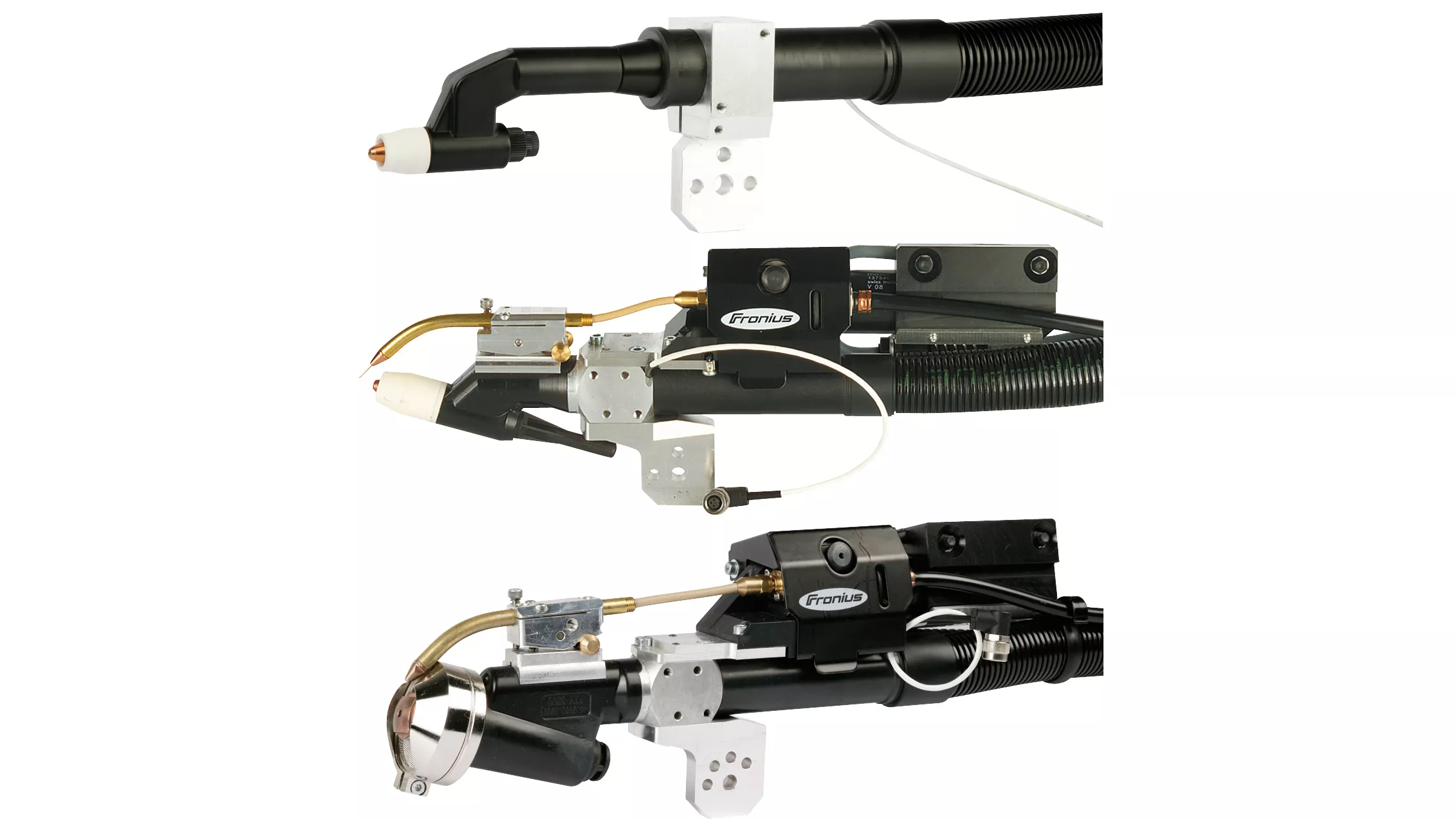

    PTW 500/1500/3500
    Plasma welding torch
    Torch models are available for both manual and robot applications. The flexible robot welding torch can be mounted directly on the robot in up to four positions. The tool centre point (TCP) is firmly fixed and is identical to that of TIG robot welding torches of the same design.

    Systembeispiel Softplasma
    Example of a soft-plasma/plasma brazing system
    1. MagicWave/TransTig 2200/2500/3000
    2. PlasmaModule 10
    3. Robacta PTW 1500
    4. Kühlgerät FK 2500 FC
    System components
    2. PlasmaModule 10
    3. Robacta PTW 1500
    4. FK 2500 FC cooling unit
     Applications  Manual & mechanised
     Sheet thicknesses  Up to 3 mm
     Welding current range  3 - 300 A
    Systemkonfiguration Softplasma
    Example of a plasma-keyhole system
    1. MagicWave/TransTig 4000/5000
    2. PlasmaModule 10
    3. Robacta PTW 3500
    4. Kühlgerät FK 9000-R
     System components
    2. PlasmaModule 10
    3. Robacta PTW
    4. FK 9000-R cooling unit
     Applications Mechanised
     Welding current range  3 - 500 A
