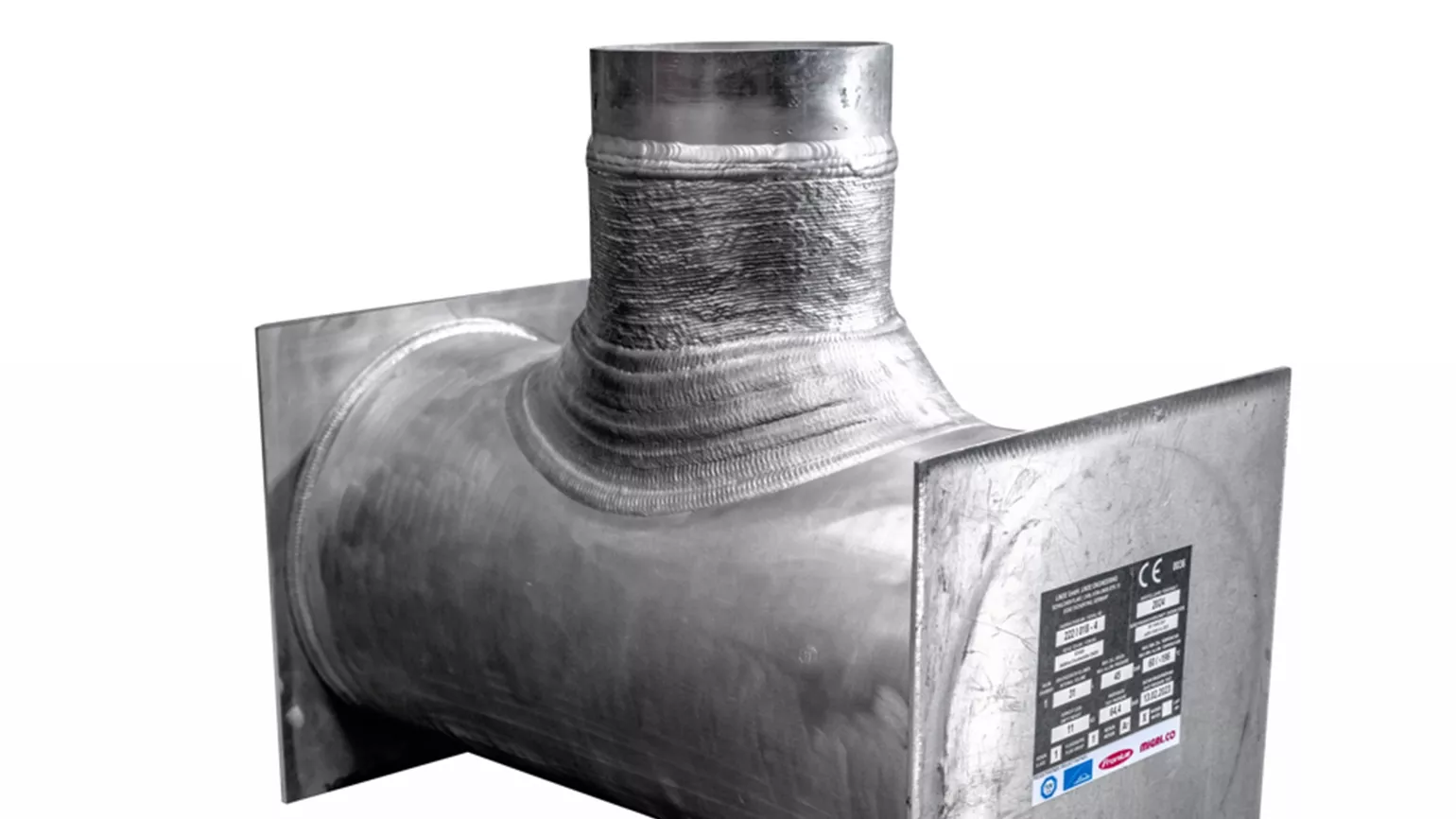

Fronius assists with the development of standards
As a member of the “Joint working group for additively
manufactured components under the Pressure Equipment Directive of the German
Institute for Standardization (DIN),” Fronius participated in the model
qualification of an additively manufactured component in collaboration with
MIGAL.CO, Linde Engineering, and TÜV SÜD. The working group assessed the
applicability of the draft standard prEN 13445-14 to the components of unfired
pressure vessels.

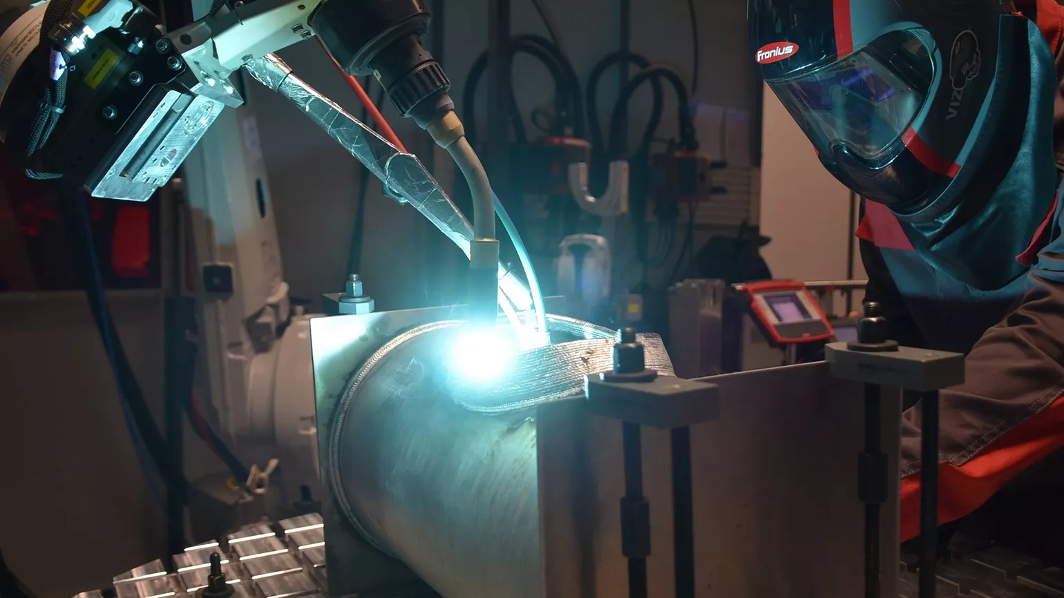

The entire process chain was checked using a pressure vessel in the form of a pipe branch. As per the design template, the branch (additively applied area up to the stub) was formed on a conventionally manufactured aluminum base pipe with a cut-out provided for this purpose.
Aluminum, the naturally hardened wrought alloy, is
mainly used in plant construction because of its excellent low-temperature
toughness down to minus 273 °C. However, it places high demands on the welding
process. It is not only the process selection and the process parameters that
are decisive for the result, but also the choice of filler material, which
plays a fundamental role in metal 3D printing. Tight tolerances apply both to
the wire diameter and to the chemical composition, with the aim being to include
as little hydrogen as possible. Furthermore, the wire must be free of
inclusions and neatly wound onto a spool to ensure that the manufacturing
process runs smoothly. Based on the requirements, CMT Mix was chosen for the
additive build-up of the first weld layers and CMT Additive Pro for the
subsequent wall build-up, where the power correction function significantly
influenced the heat input.
The individual test pieces were subjected to non-destructive and destructive testing as per the requirements of prEN 13445-14. Visual and dimensional tests (VT), volume tests (RT-D), and surface tests (PT) were used as non-destructive testing processes to provide evidence that the pieces were free from faults both externally and internally.
The following video provides detailed information on the model qualification of the pressure vessel: LindeEngineering, TÜV Süd, MIGAL.CO, Fronius
