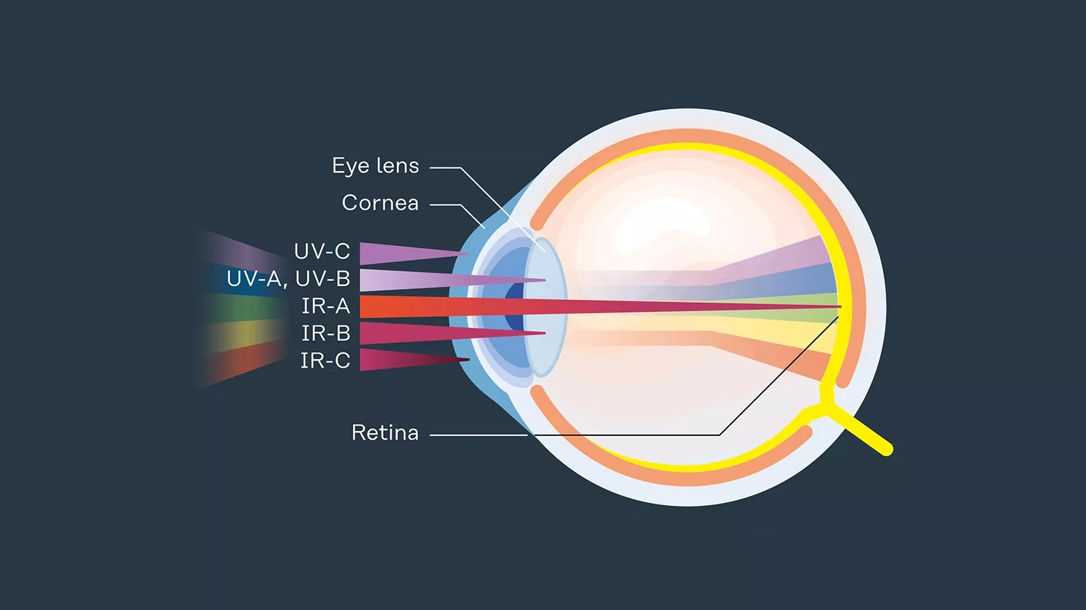

Types of light in the arc—radiation and effect
The arc emits different types of radiation, each of which carries its own health risks. Handling these types of radiation with care is crucial to safety in the workplace.
1. Visible light
This type of light has a strong dazzling effect and can significantly impair vision. This poses a safety risk for welders, especially during precision work.
2. Infrared radiation (IR)
This radiation penetrates deep into the tissue and is often only perceived as heat. However, prolonged or intense exposure can lead to serious thermal damage—including skin burns.
3. Ultraviolet radiation (UV)
This is considered the most dangerous type of radiation during welding. UV rays can cause acute inflammation of the cornea and conjunctiva—colloquially referred to as “arc eye” (see above). It also poses a risk to the skin, as UV radiation can cause sunburn and significantly increase the risk of skin cancer with repeated exposure.

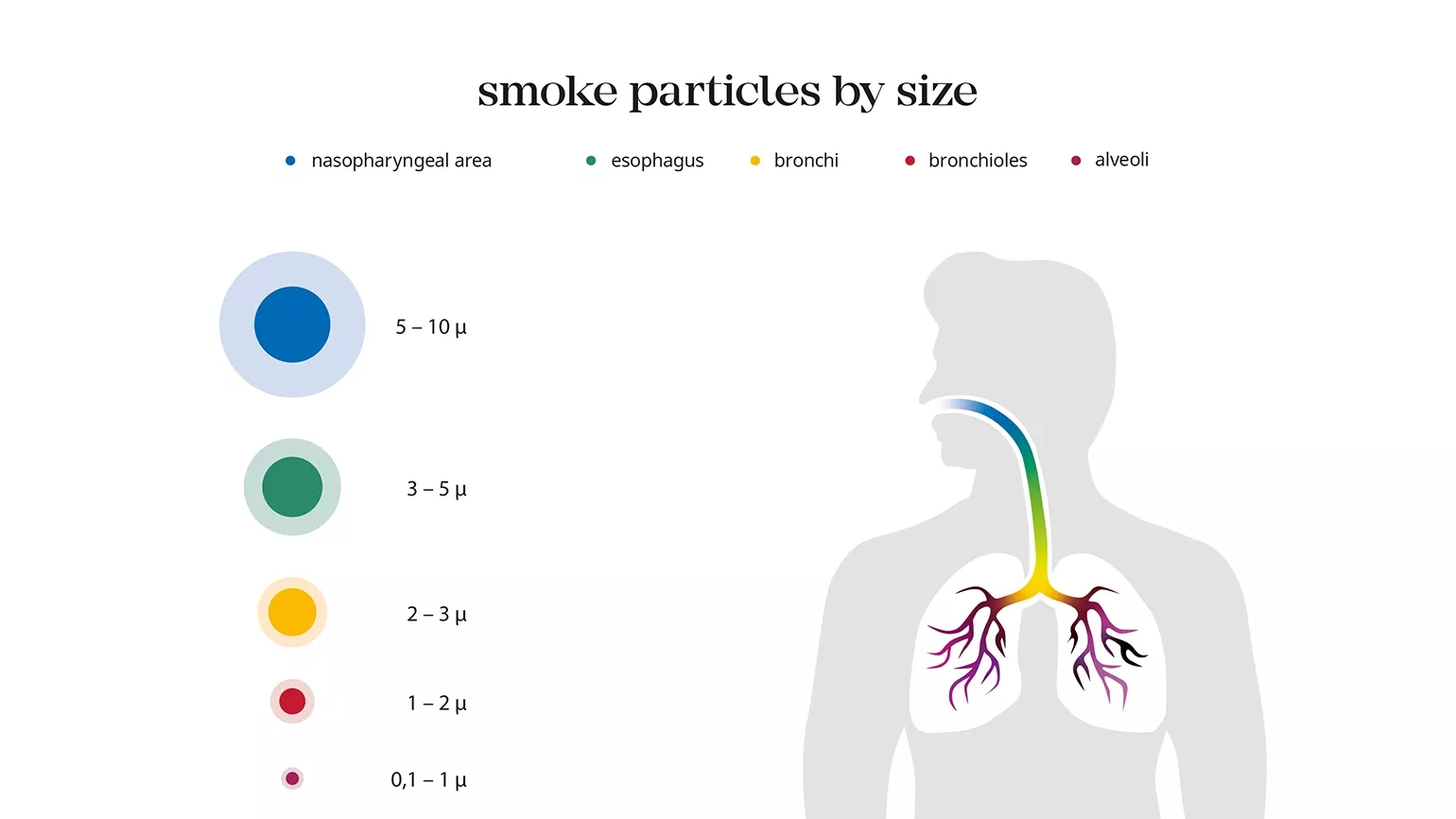

Particle sizes and their effects
The composition and quantity of harmful substances depend on several factors: the welding process, the process parameters, the filler metal, and the properties of the workpiece surface.
Harmful particulate substances are broken down into two subgroups:
  • Inhalable fraction (I dust): Particles with a diameter < 10 µm
  • Alveolar dust fraction (A dust): Particles with a diameter < 2.5 µm
One particularly critical aspect is that the majority of particles produced during welding are alveolar—and many are even smaller than 1 µm. Ultra-fine particles (< 0.1 µm) pose a particular hazard. Because they are so minuscule they can penetrate deep into the alveoli, where they are harmful to health.
