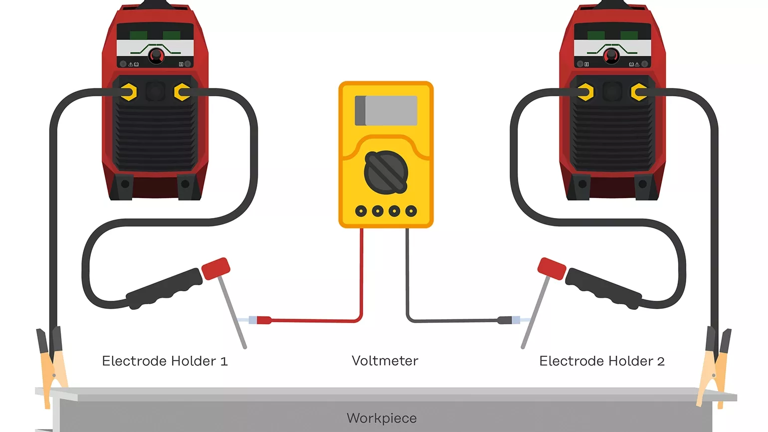

Caution when welding with several welding machines
If welding specialists are working on a workpiece with several welding machines at the same time or on components with a conductive connection, the contact voltage that occurs—especially the open circuit voltage—can reach levels higher than permitted. In many cases, this hazardous situation is not immediately evident.
But the situation becomes especially critical when welding with different polarities at the same time. In this case, the total open circuit voltages of the welding machines can lead to dangerously high voltage levels when welding with direct current (DC).
“This happens fairly often, especially on construction sites,” reports Franz Bichler, a welding trainer at Fronius International. “In the past, we often worked in pairs or threes when welding components several meters long—and even with different polarities, to get the best results on complex components. If the grounding is faulty in a situation like this, the accumulated voltage can pass through the welder’s body—with life-threatening consequences such as electric shocks, cardiac arrhythmia, or severe burns.”
When welding with alternating current (AC), both the polarity of the circuits and the grid-side connection of the devices influence the resulting open circuit voltage. Under less favorable conditions, the contact voltage can increase to the total of all open circuit voltages of the devices used. Therefore, it is essential to measure the voltage between the welding torches or electrode holders before starting work. The measurement is carried out with a voltmeter by placing both measuring tips directly on the welding torch (electrode holder)—see drawing 2.

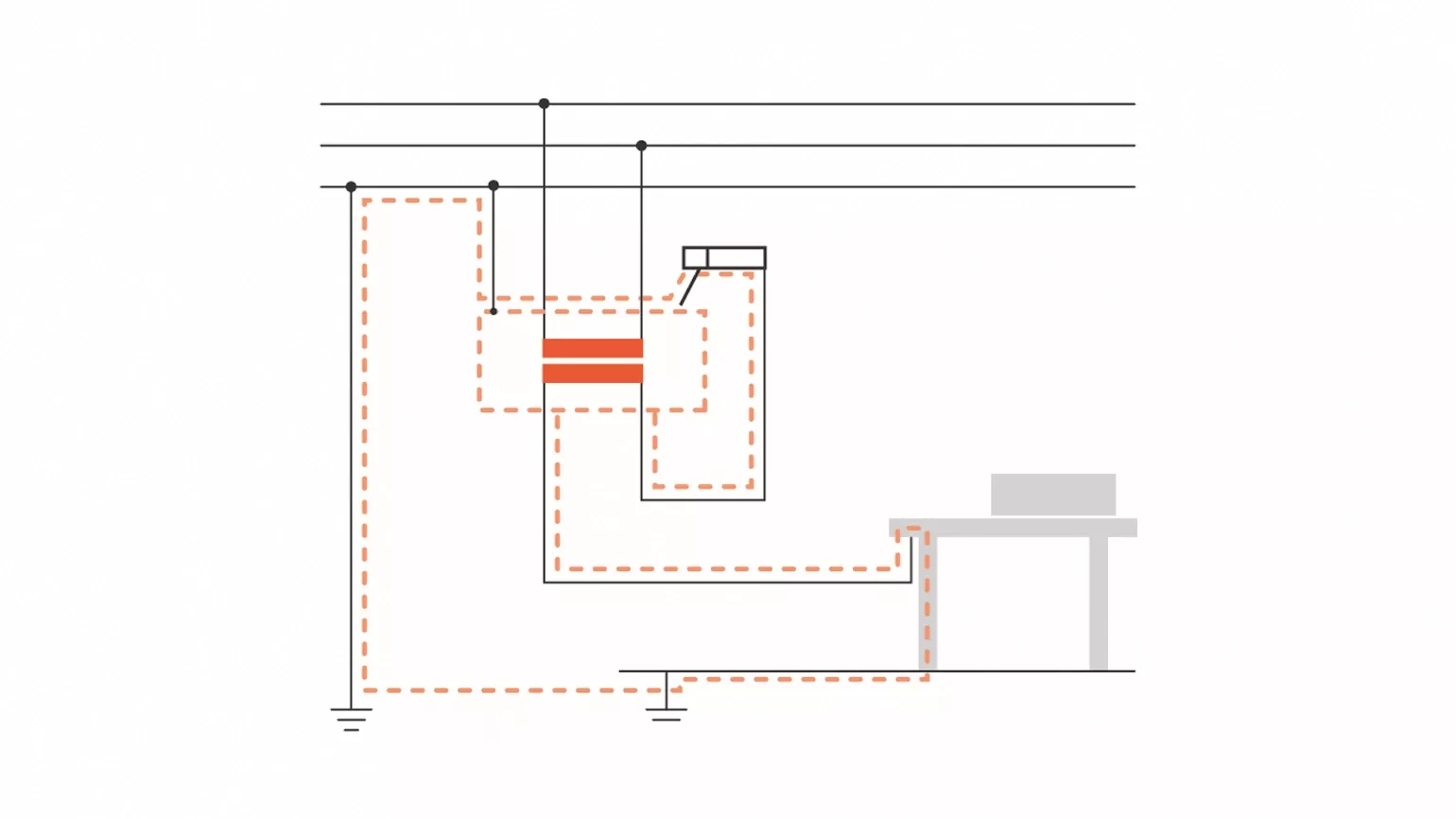

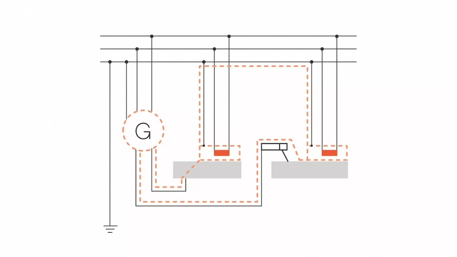

Hazards due to stray welding current
Improper handling of welding machines can result in considerable risks. Incorrectly connected return lead cables or carelessly placed electrode holders are particularly critical aspects. Faults of this type can cause interruption of the ground conductors, welding machines, or other electrical devices. As breaks in protection are not usually evident from the outside, they pose a considerable risk for anyone working with damaged devices.
Carelessness and inattention are the most common causes of breaks in the ground conductor and resulting accidents. Typical examples might include uninsulated electrode holders that are set down on the welding machine or power hand tools left on the welding table during welding work (drawings 3 and 4).
However, those who pay attention to the protective measures stipulated by the applicable standards can ensure they are effectively protected against stray welding current. The welding current return cable (ground) should be connected directly to the workpiece or its support—by clamping it or using adhesive magnetic poles. Other parts such as metal poles, chains, or crane ropes must never be used as return cables.
If, in exceptional cases, workpieces have to be welded while suspended from a crane hook, they must be carefully shielded—for example, using dry textile ropes or an insulated swivel hook. In cases where suspended work baskets are used while welding, these must be fitted with suitable insulation. Only insulated equipment may be used when welding and working with power tools at the same time.

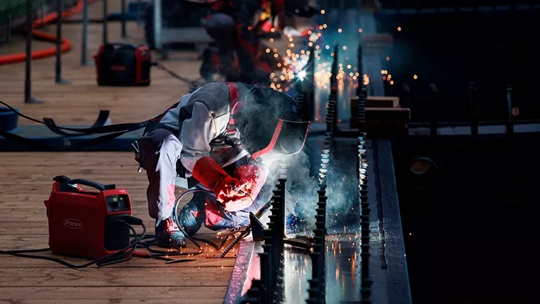

Working in conditions with high electrical voltage
There is an increased risk of electrical hazards in workplaces with restricted freedom of movement. This applies in particular when welding specialists have to work in forced postures—such as kneeling—and come into contact with electrically conductive parts. Areas that are completely or partially surrounded by electrically conductive materials also present hazards. Even contact that is unavoidable or accidental can lead to electric shocks.
You can use the following rule of thumb to assess whether there is an increased risk during arc welding: If the free space between electrically conductive parts positioned opposite one another is less than two meters—in length, width, height, or diameter—you should assume that there is an increased electrical risk.
Make sure to take particular care in wet, damp, or hot workplaces, as the resistance of human skin, protective clothing, and protective equipment may be significantly reduced by moisture or perspiration in these environments. Workplaces should be considered “wet” if workwear is soaked with moisture and can therefore conduct electricity—which significantly increases the risk of an electrical accident.
