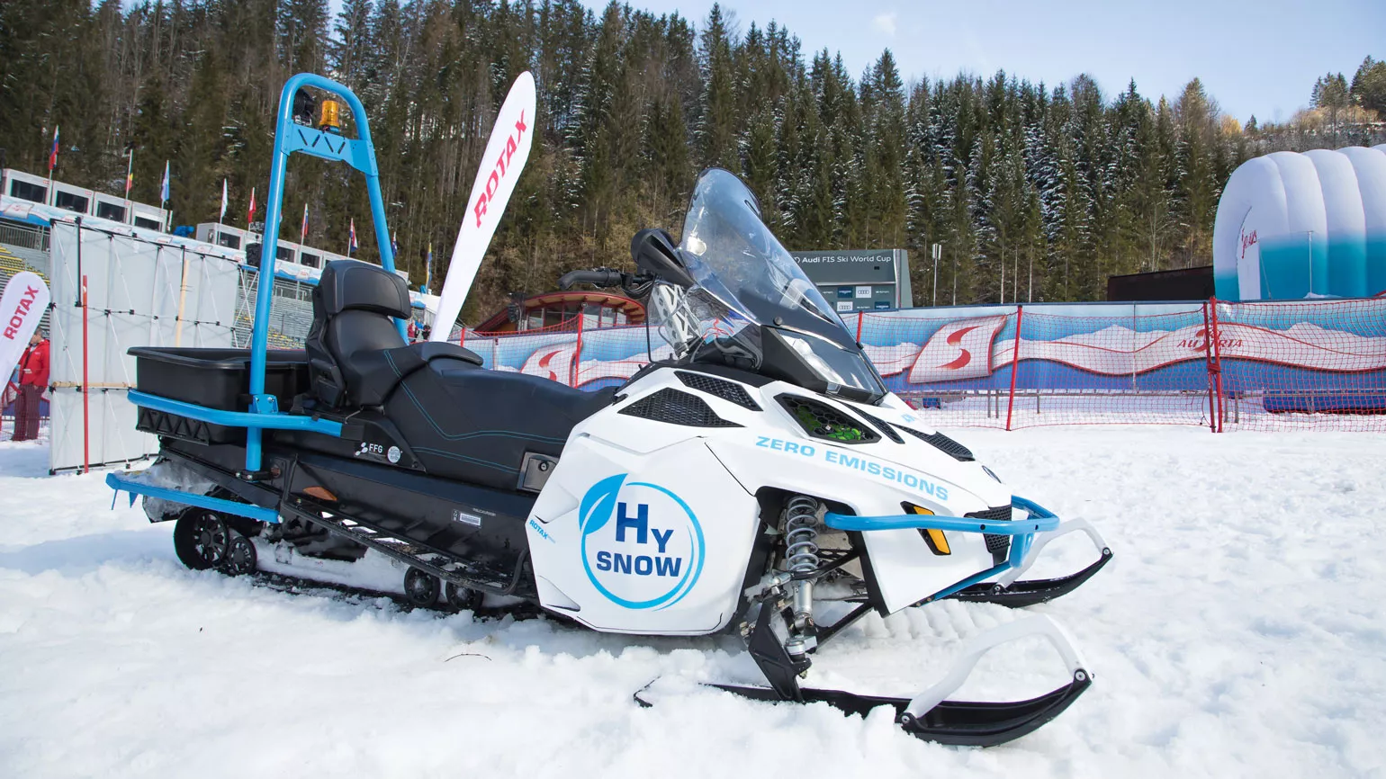

Zero-emission winter tourism using hydrogen technology
Several project partners,
including Fronius, combined their know-how for the “HySnow” flagship project,
which aims to significantly drive forward the decarbonisation of winter tourism
using an innovative hydrogen refuelling system and the associated “Lynx HySnow”
snowmobile. The zero-emission, low-noise and powerful hydrogen drive once again
proves its great potential when replacing conventional combustion engines in
different types of vehicles.

It is crucial that snowmobiles provide as much power as possible at a low weight and are reliable in low temperatures. Short refuelling times and comparatively high ranges ensure high vehicle availability for mountain rescue or maintenance service employees. The fuel required – green hydrogen in this example – is generated using a 34.5-kWp PV system. This is directly coupled with an electrolysis module with a downstream compressor, thus establishing a 350-bar tank infrastructure. Fronius provides the project with important components for the refuelling system infrastructure and the two Fronius Symo inverters are the energy source for producing hydrogen from solar power.
