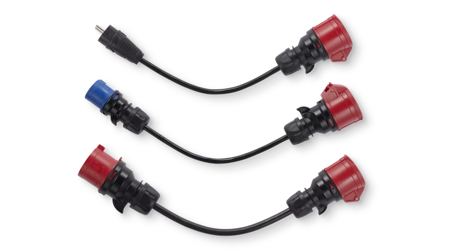

Depending on your wishes, you can choose between different accessory components for the Wattpilot Go and Wattpilot Home. The offer ranges from adapter sets to mounting brackets and additional ID chips.
With the adapter set for the Wattpilot Go 11 J, the CEE 16A plug can be adapted to the following plug types: CEE plug red 32 A (3-phase), CEE plug blue 16 A, camping plug (1-phase), Safety plug 16 A (household socket) With the adapter set you are maximally independent and can charge with your Wattpilot at any socket.

Weight | 1,18 kg |
Nominal voltage U/U0 (450/750V, etc.) | 230/400V |
Test certificate / mark of conformity (VDE, SEV, etc.) | CE |
Overall component width or overall diameter | 90 mm |
Overall component height / space requirements | 270 mm |
Maximum charging current of the charging plug/charging terminals acc. to data sheet | 16 A |
Number of conductors / number of cores (3-pin, 5-pin, etc.) | 3-pin / 5-pin |
Connector types | CEE plug red 16 A (3-phase) / CEE plug blue 16 A, camping plug (1-phase) / earthed plug 16 A (household socket) |
Length of adapter cable CEE blue 16 A | 295 mm |
Length of adapter cable, earthed plug 16 A | 295 mm |
Length of adapter cable CEE red 32 A | 295 mm |
Cable cross-section | 2,5 mm² |
