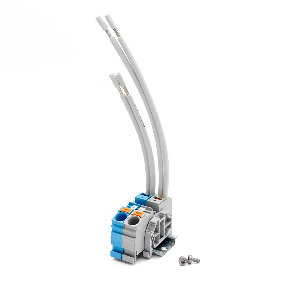

Connecting MPP trackers
When MPP trackers are combined, the currents are added together, which makes it possible to connect strings with higher amperages and cables with a cross section of up to 16 mm². The Connector Kit therefore provides complete flexibility when selecting solar modules.
The DC Connector Kit GEN24 has been specially developed for use with the Fronius Primo and Symo GEN24. The terminals used are safe to touch and no ferrules are needed.
Technical Data
General Data
Width55 mm
Height90 mm
Depth90 mm
Weight0,13 kg
Connection cross section4 mm² bis 16 mm²
Cable typecopper cables - strand or wire, sector or circular (PV cables must be used)
Clamping area of the screw joint2,5 mm² - 16 mm²
StandardsIEC 60079, EN 60947, CSA C22.2 No. 158
Max. voltage1000 V
Max. current (Isc_pv) with Symo GEN24 6.0-10.056,26 A
Max. current (Isc_pv) with Primo GEN24 3.0-6.0
51 A
