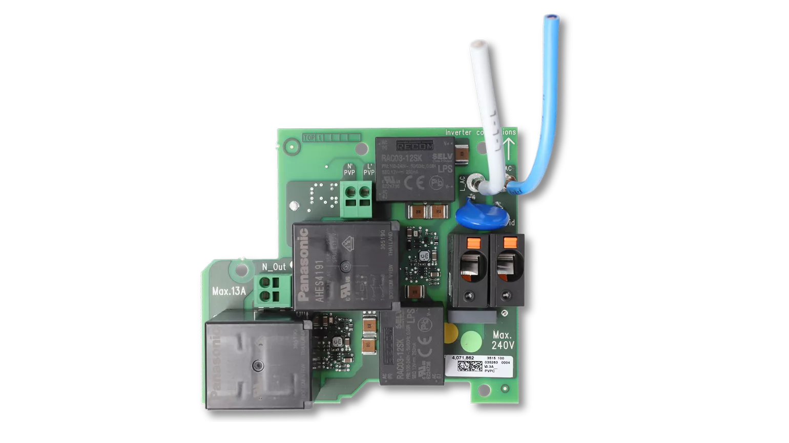

The PV Point Comfort ensures protected sockets or small circuits have a permanent power supply, not only during a power failure, but also in parallel grid operation.
Unlike the PV Point, the PV Point Comfort automatically switches to backup power mode when required, thereby ensuring a continuous mains supply for important loads such as refrigerators, freezers or alarm systems. As an accessory, it can also be easily retrofitted into all Fronius GEN24 and GEN24 Plus inverters.
