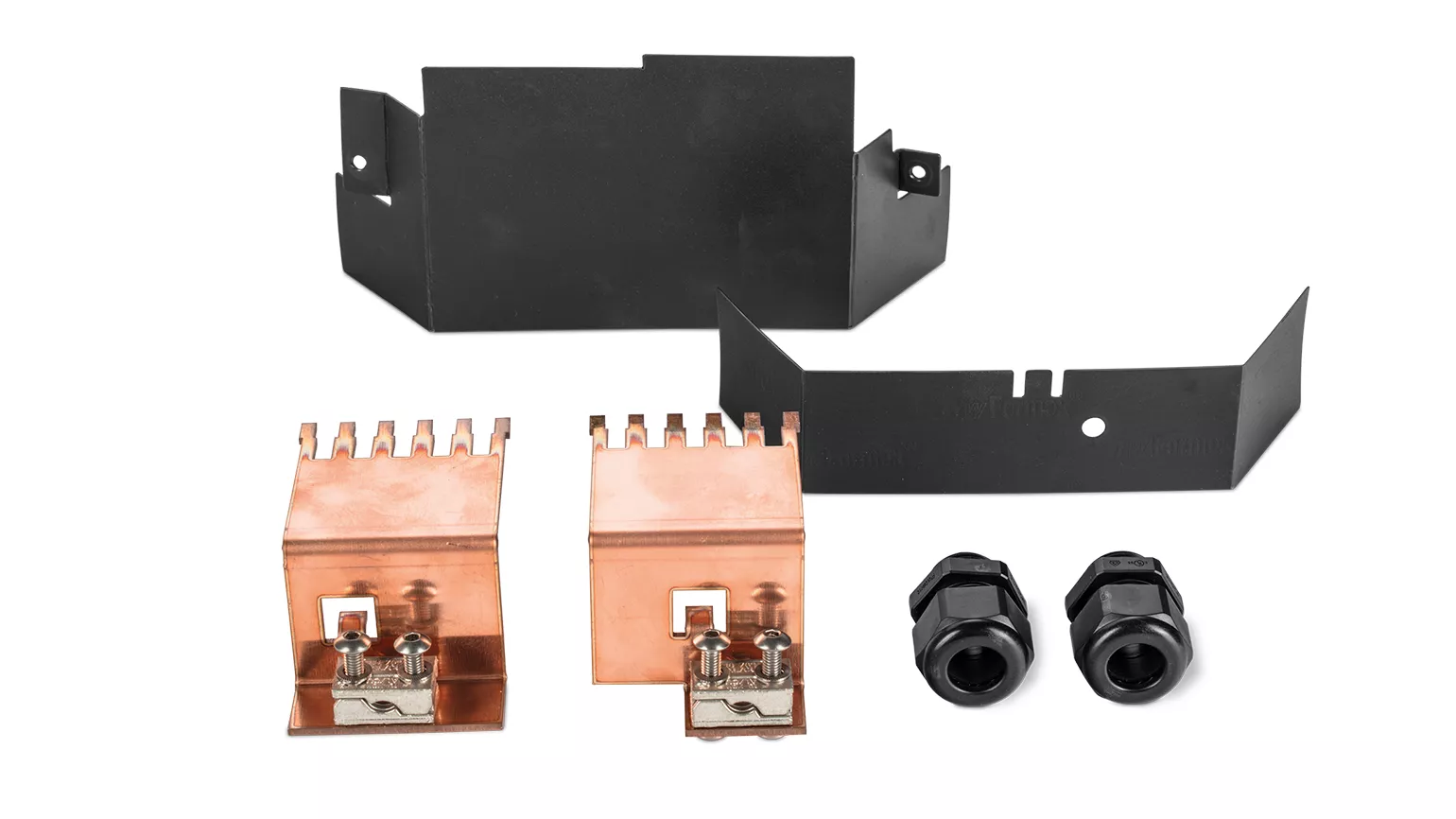

Fronius Eco inverters can be conveniently fitted and ordered with various options such as a surge protection device, a DC connector kit or an MC4 solar connector.
The DC Con Kit enables the connection of both inputs in the event of MPP currents above 35 A and a cable cross section of more than 16 mm², for example when using a DC Box. With the DC Con Kit 35, cross sections of up to 35 mm² are possible, allowing the largest possible distance between the inverter and the solar modules to be achieved. The terminal is safe to touch and the DC Connector Kit is particularly suitable for use with the Fronius Symo 10.0 – 20.0 kW and Fronius Eco inverters.
Technical Data
General Data
Max. current100 A
Connection cross section35 mm²
Cable typeUsed for copper and aluminium cables, single or multi-strand, sector or circular
Torque2x 0,5 Nm, 2x 3 Nm
Clamping area of the screw joint10 mm - 14 mm
StandardsIEC 60999:2000
