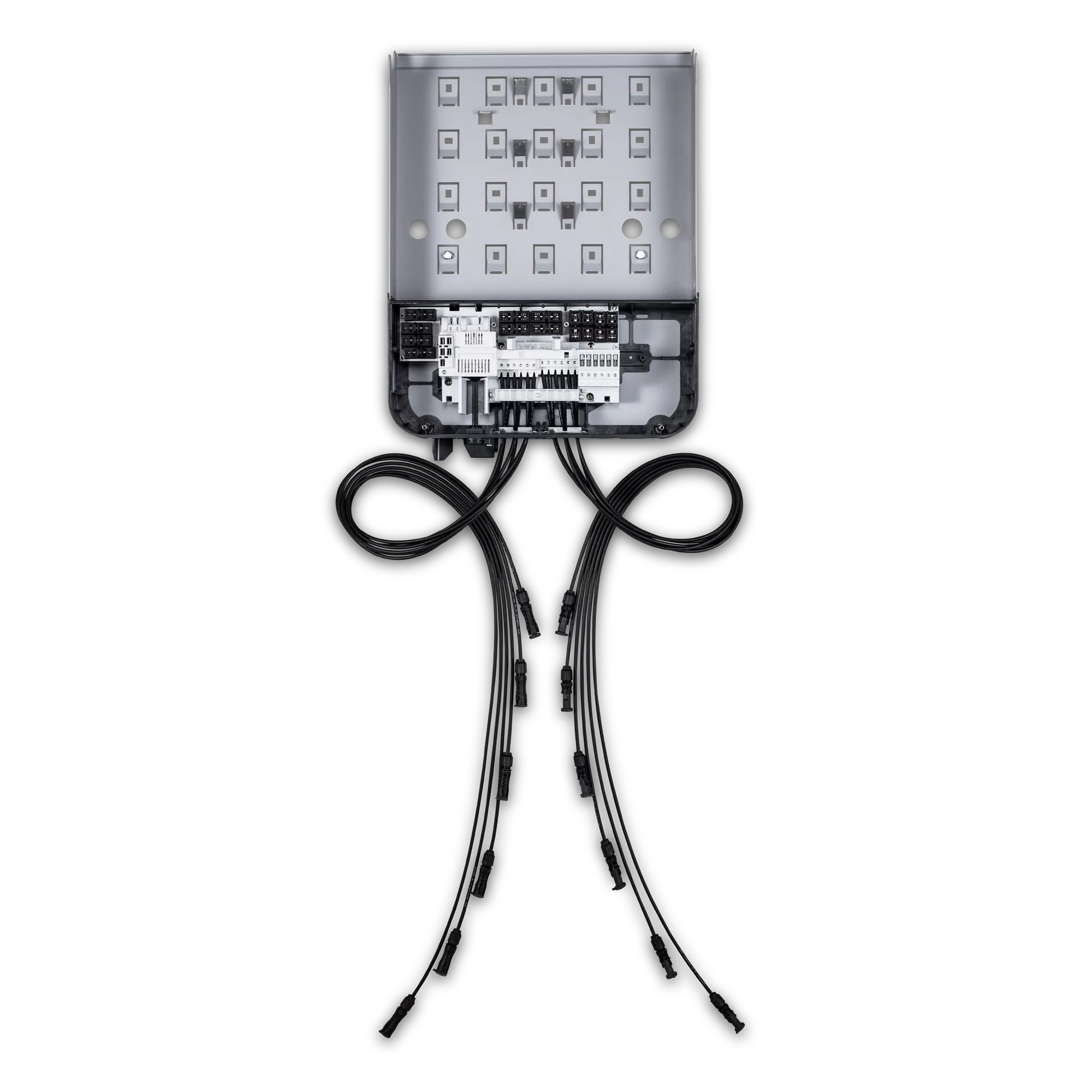

Simplify the installation of your Fronius Symo 24.0 inverters and get the Fronius MC4 Connector option. The inverter with pre-installed MC4 Connectors enables the quickest inverter installation by simply connecting DC wires through MC4 connectors, saving time and minimizing design complexity.
The option is part of the Fronius Rooftop Solution and is available for the Fronius Symo 24.0 inverter. The Fronius Rooftop Solution consists of the Fronius Symo 24.0 inverter with MC4 Connector option and the Fronius Shade Cover, providing the easiest and most cost-effective solution for NEC 2014 and 2017 requirements in commercial rooftop systems.
