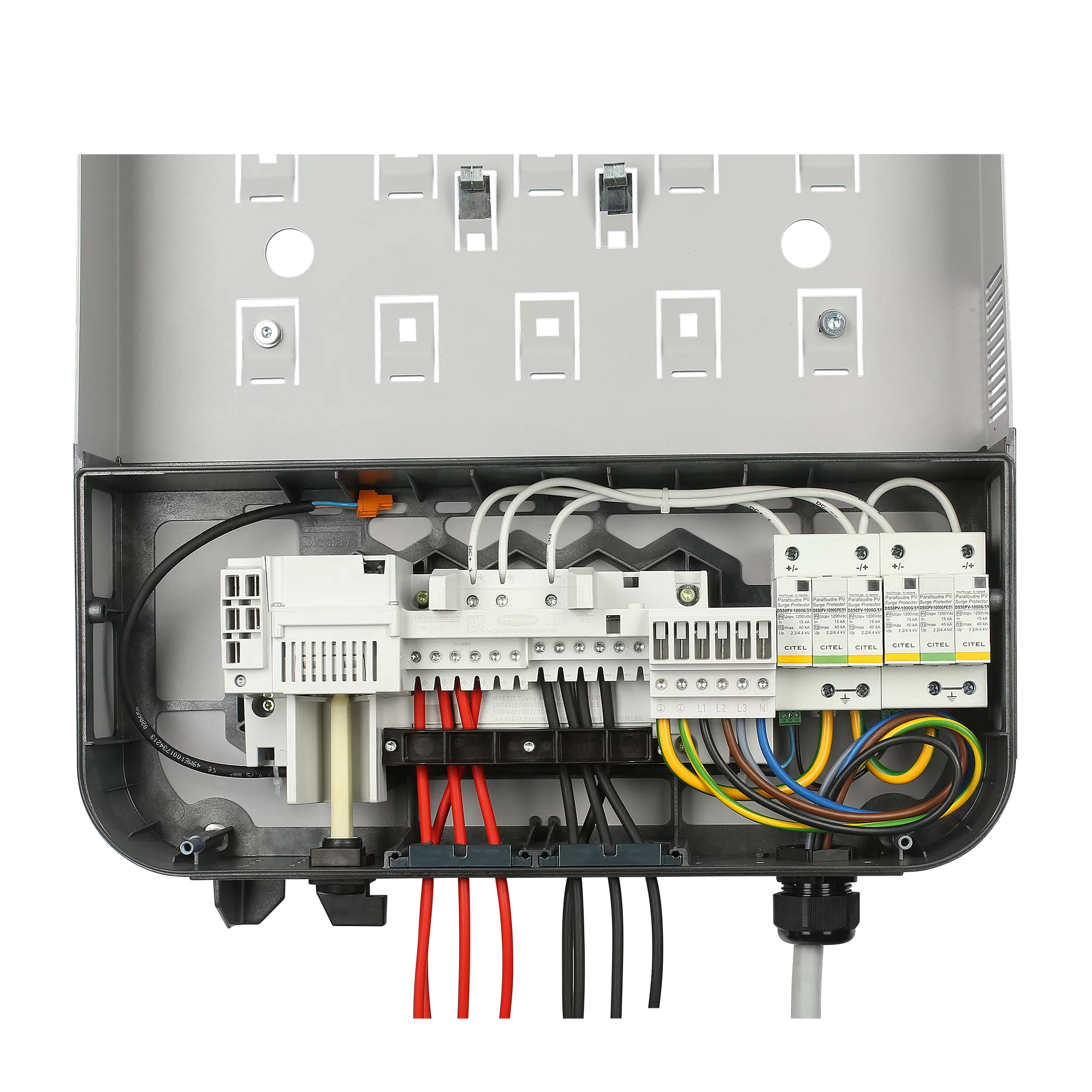

Fronius Symo inverters can be conveniently fitted and ordered with various options such as overvoltage protection, a DC connector kit or an MC4 solar connector.
The DC connector kit enables the connection of both inputs in the event of MPP currents above 35 A and a cable cross section of more than 16 mm², for example when using a string collection box. A cross section of 6 mm² - 25 mm² can be connected using the DC connector kit. The terminal is safe to touch and no ferrules are needed. The DC connector kit is particularly suitable for use with the Fronius Symo 10.0 - 20.0 kW and Fronius Eco inverters.
Technical Data
General Data
Max. current | 100 A |
Connection cross section | 6 mm² - 25 mm² |
Cable type | Used for copper and aluminium cables - strand or wire, sector or circular (PV cables must be used) |
Torque | 5,5 Nm / 50 lb-in |
Clamping area of the screw joint | 8 mm - 13 mm |
