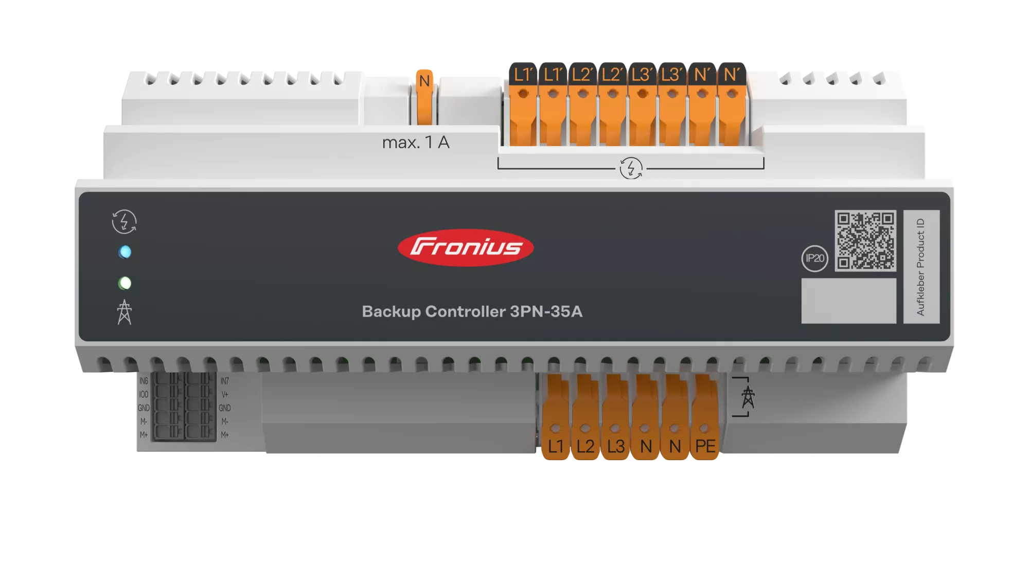

Fronius Backup Controller
Automatically switch to Full Backup mode
The Fronius Backup Controller is a switching unit that enables automatic transition to Full Backup mode. In the event of a power failure, it automatically switches to backup power operation and back to parallel grid operation as soon as the grid is available again. This solution ensures that the entire household is always supplied with electricity as long as there is enough power available from the PV system or storage - even when nobody is at home.
As a space-saving solution, the Fronius Backup Controller* can be installed quickly and easily on a top-hat rail in the control cabinet. This minimizes installation effort and costs, as an additional switchover box is no longer required.

Product details
General Data
Nominal voltage400/230V
Nominal Power24 kVA
Nominal current35 A
Mains Frequency50Hz
Grid typesTN-S, TN-C-S, TT
Dimension / width198 mm
Dimension / height100 mm
Dimension / depth66 mm
Degree of protectionIP20
Min. permissible ambient temperature-20 °C
Max. permissible ambient temperature60 °C
Permitted humidity50 %
Min. cable cross-section (neutral conductor to smart meter)1 mm²
Min. cable cross-section (phase/neutral conductor)2,5 mm²
Max. cable cross-section (phase/neutral conductor)10 mm²
Min. cable cross-section (data communication)0,14 mm²
Max. cable cross-section (data communication)1,5 mm²
FRT capabilityYes
The Fronius Backup Controller 3PN-35A will be available from July 2025.
