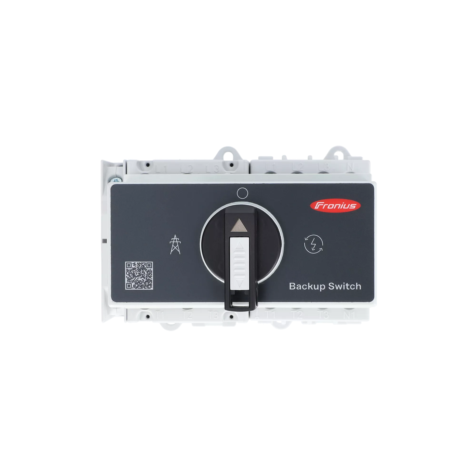

Fronius Backup Switch
Manually switch to Full Backup mode
The Fronius Backup Switch is a cost-effective 3-way switch for manual activation of emergency power operation. This solution supplies the entire household in full backup mode and therefore offers maximum security and independence.
As a space-saving solution, the Fronius Backup Switch can be installed quickly and easily in the switch cabinet. This minimises installation work and costs.
