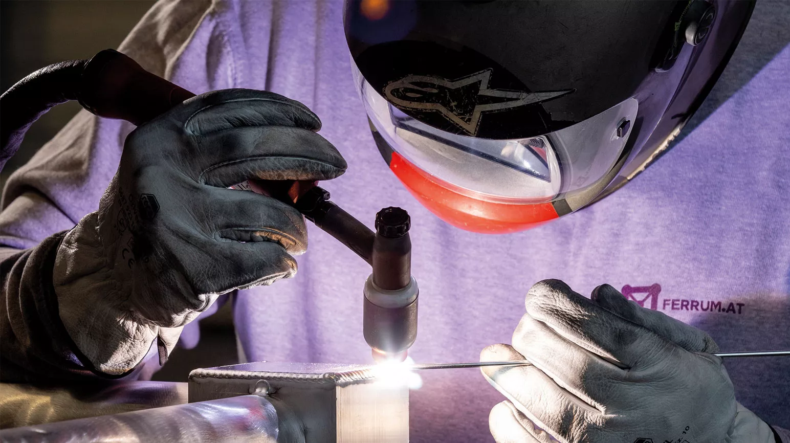

Time savings of up to 50% when tacking
With the help of the tacking function, the weld pool briefly oscillates at the beginning of the welding process. As a result, tacking takes place in a single step because both component edges merge beautifully—without burning the edges. Very little to no temper coloration occurs at the tacking points. In addition, the filler metal is not required for air gaps up to 1.5 mm. Particularly for chrome-nickel and steel applications, the tacking function leads to a significant increase in efficiency.

Top-quality manual welding requires years of experience and dexterity. This is especially true for TIG welding. The more intuitive and convenient a welding system is to operate and the more it supports welders with their welding work through intelligent functions, the better they can focus on the actual task: the perfect weld result. The iWave makes things much easier for the professionals at FERRUM.AT. The menu navigation is self-explanatory and available in more than 30 languages. Operating the touch display and adjustment wheel even while wearing gloves is easily possible.
“RPI auto” takes TIG welding ignition behavior to a whole new level. Adapted to the different electrode diameters, this function enables fast and reproducible ignition without any manual adjustment of the ignition parameters, regardless of the material characteristics.
