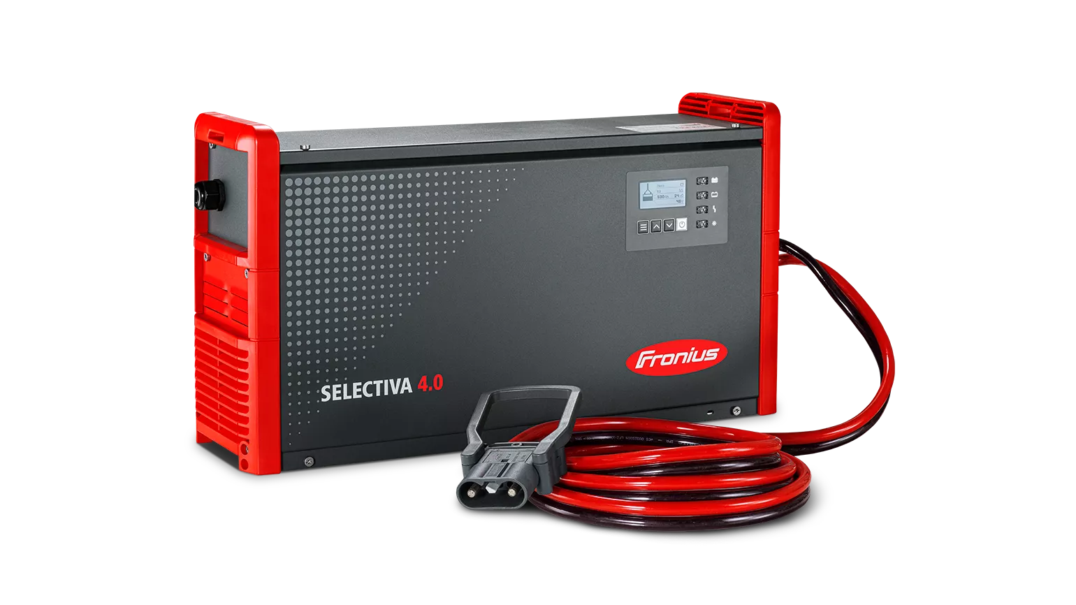

Battery chargers 4.0 for 80 V / 72 V batteries
One battery charger for every battery
The battery chargers from the Selectiva product family offer flexible charging of batteries with different voltages and capacities. Among the benefits for you are the simple and standardised operation and amount of space needed as well as low operating costs.
Tekniske data
General Data
Mains Frequency | 50 Hz |
Dimension / length | 633 mm |
Dimension / width | 180 mm |
Dimension / height | 344 mm |
Weight | 20,6 kg |
Weight | 20,6 kg |
Weight incl. packaging | 23,9 kg |
Max. altitude | 2000 m |
Interference emission class | B |
Technical Data
Mains frequency maximum | 60 Hz |
Mains fuse | 16 A |
Residual current Circuit Breaker | Typ B |
Minimum Mains Lead Cross Section | 2,5 mm² |
Nominal output voltage | 80 V |
Charging current / output current nominal | 40 A |
Maximum Relative Humidity | 85% |
Degree of protection | IP20 |
