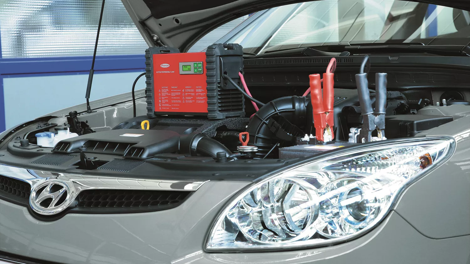

Owing to the increasing number of electronic systems, the energy requirements of modern vehicles are constantly growing. The alternator alone can no longer compensate for this, particularly if the vehicle is mainly used for short journeys. This results in battery problems due to the negative charge balance. Low ambient temperatures in particular mean that drivers are encountering battery failures and difficulties starting the vehicle on a more regular basis. If the vehicle is left unused for long periods, for example when the driver is on holiday, this leads to self-discharge of the battery.
For this reason, modern cars need a substantial recharge whenever they come into the workshop, allowing the vehicles to receive the maximum possible power boost in the limited time that the vehicle is in for servicing. This reduces the damage resulting from sulphated batteries and improves the starting capability.
Fronius Acctiva battery charging systems have been designed for rapid and efficient charging. The flexible devices are capable of charging various types of starter battery with up to 70 A for a full charge, restoring the starting capability within minutes. This helps you as a workshop operator to ensure that your customers are completely satisfied with their vehicle and service engineer.
Most vehicles come into the workshop for servicing with a depleted battery. This is because the vehicle’s high-energy requirements – in particular during short journeys – can no longer be compensated for by the alternator alone. The vehicle’s energy consumption is normally high even during servicing: open doors, interior lighting and active electronic systems place additional strain on the already depleted battery. The result is frequent starting problems following servicing or complaints regarding defective batteries shortly after the vehicle’s visit to the workshop.
Fronius Acctiva battery charging systems facilitate problem-free servicing. Thanks to a reliable and constant power supply, the devices prevent unwanted discharge, ensuring that each vehicle leaves the workshop with maximum battery power. This extends the service life of the batteries and increases customer satisfaction.
A constant power supply to the vehicle electrical system is vital during diagnosis and repair work in the workshop. Energy consumption is especially high during software updates for control unit flash memories: this causes the engine management to simulate emergency running conditions of the engine, leaving many electrical components on full power for the duration of the memory update.
If the vehicle voltage drops to below 12 V during this process, the flash operation is cancelled by the system. This can cause irreparable damage to the control unit, incurring high costs for a replacement part – not including additional labour costs. Unfortunately, the workshop operator has to bear these costs if no battery charging system or the wrong battery charging system is used to supply power during diagnosis or software updates.
The Fronius Acctiva Professional series of portable battery chargers offers a solution that provides a reliable power source for the vehicle during diagnosis and software updates. Up to 70 A guarantees that the batteries are fully charged and capable of starting in just a few minutes. Back-up mode ensures that user settings in the vehicle are retained when the battery is changed and power supply mode guarantees a constant energy supply without any support from the battery. The I-Check automatic power consumption test can also be used to determine whether a discharged battery is faulty or still functional.
