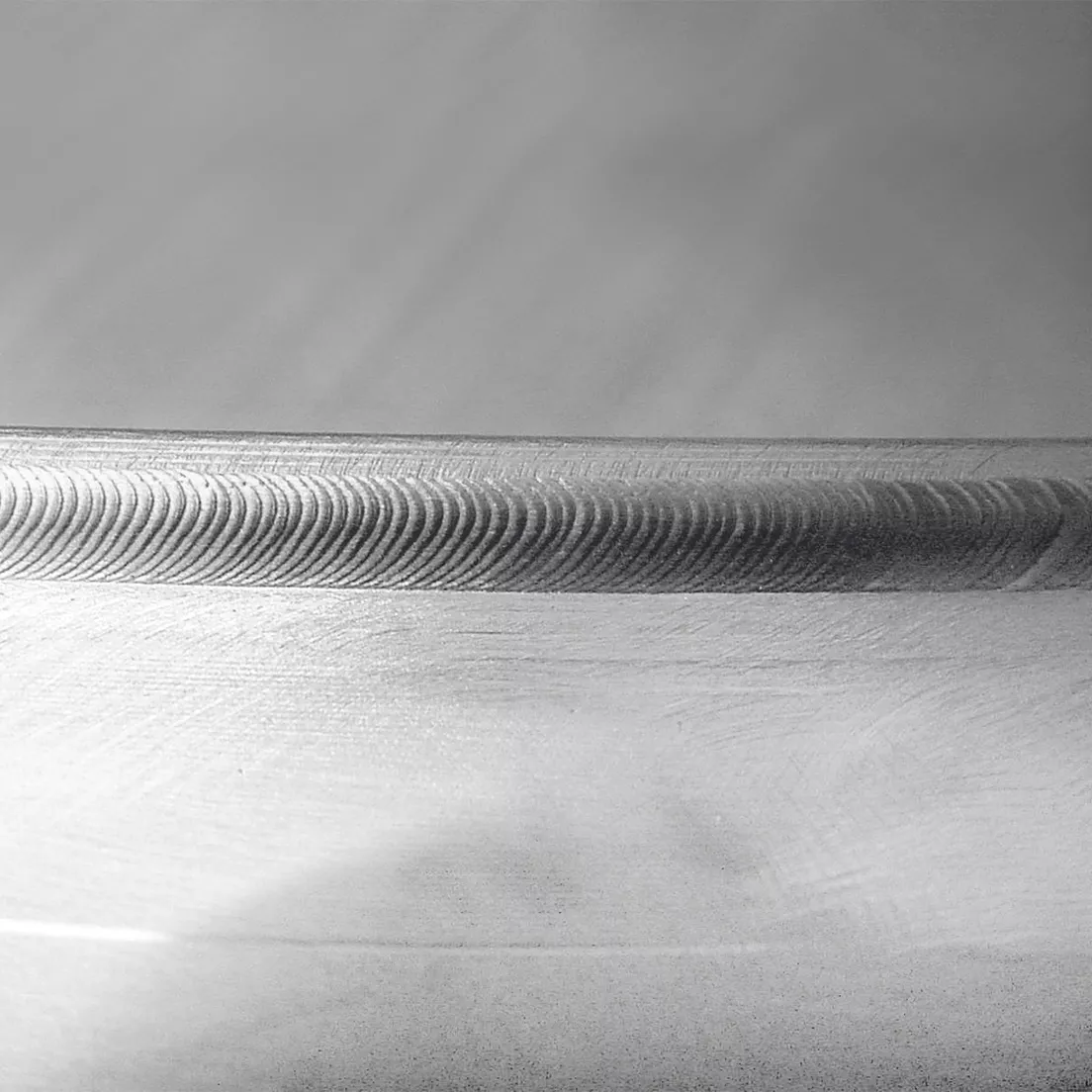

Weld seams with undesirable temper coloration
Temper coloration is produced when welding without oxidation protection (forming). At these points, the passive layer of the stainless steel has been damaged by the welding process, which can lead to corrosion. The use of forming gases is therefore necessary, especially on the inside of the pipe or on the underside of the root, where the shielding gas from the welding torch cannot create a sufficient gas shroud. This is the best possible way to avoid temper discoloration and oxidation.

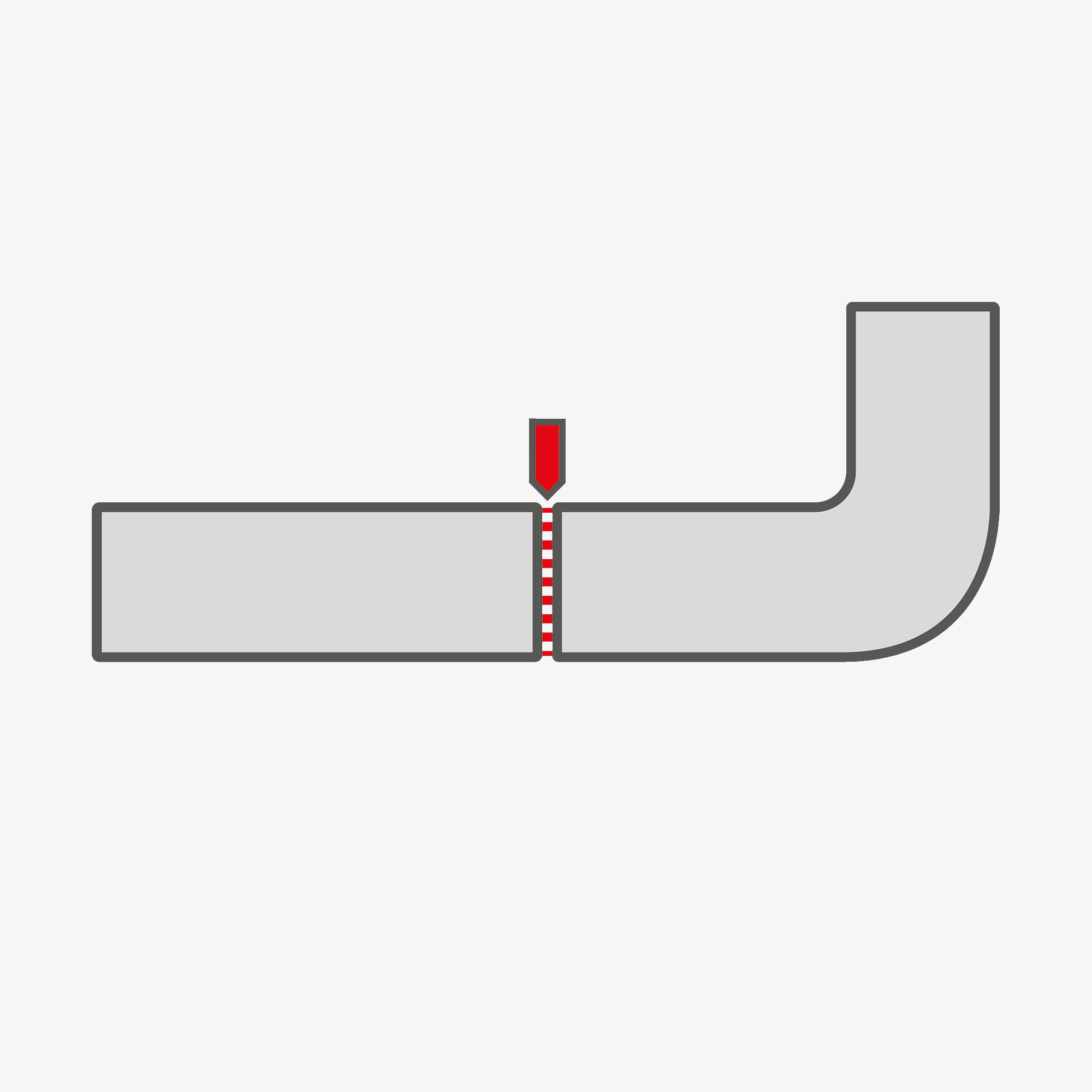

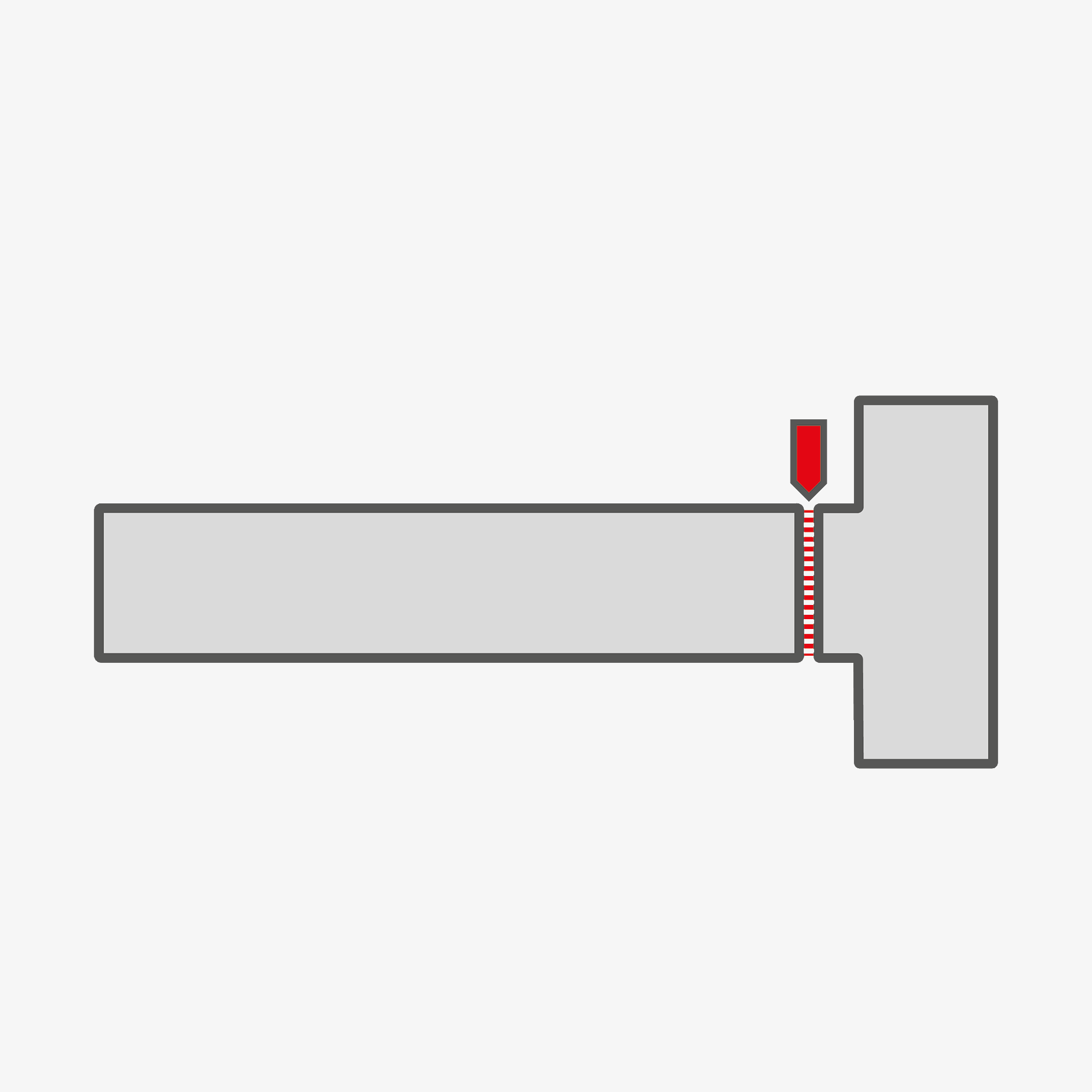

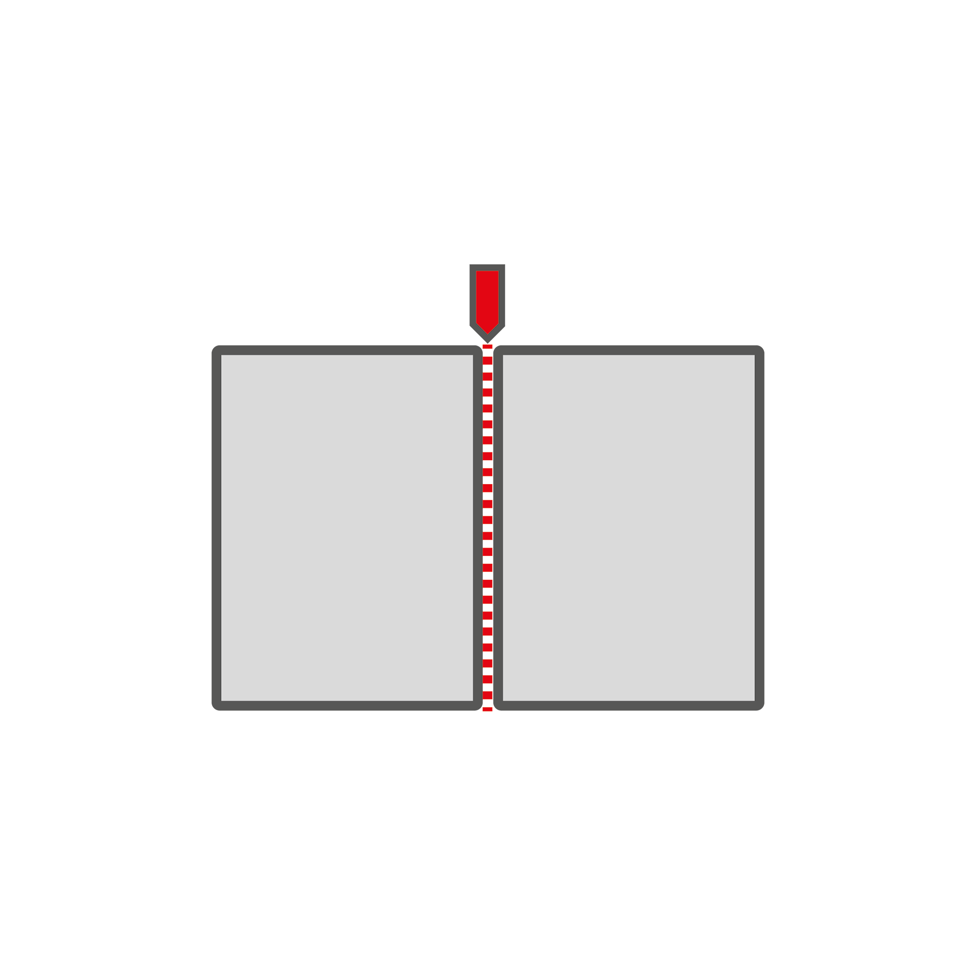

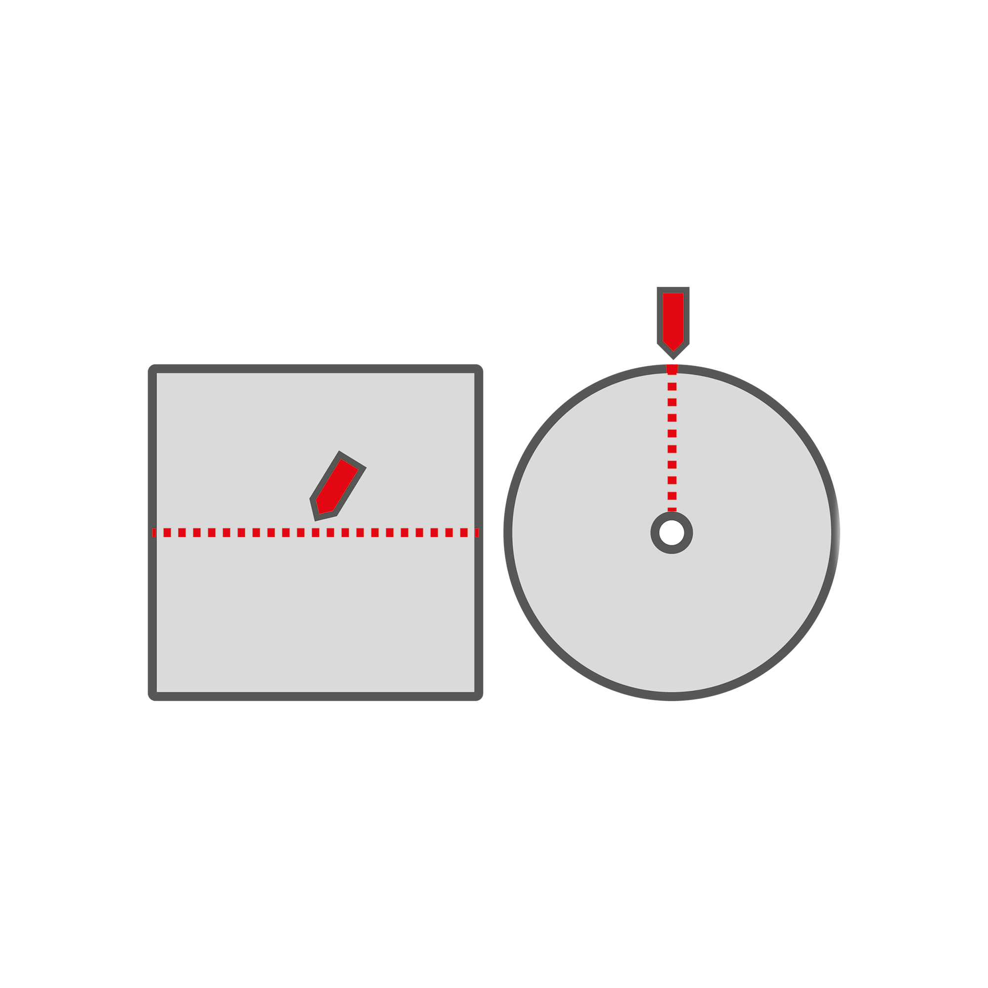

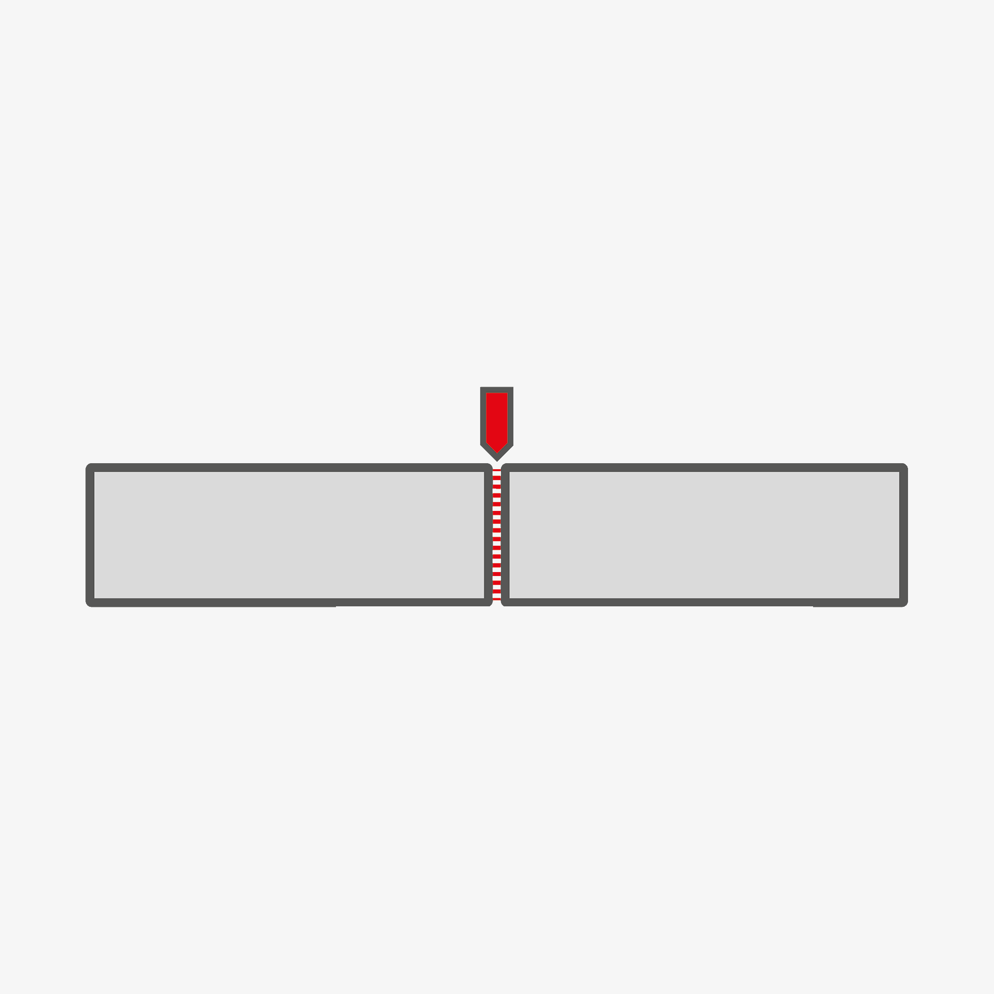

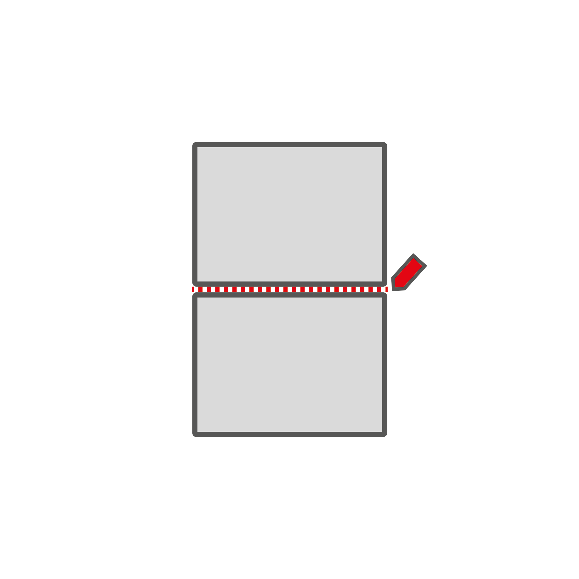

Typical seam connections

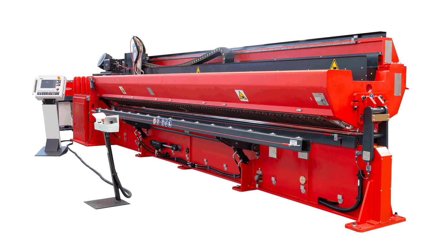

Longitudinal seam welding systems
For welding container shells
FCP 2100-2 Seam welder
FCP 2100-2 seam welder with intuitive HMI system controls, TIG, ArcTig, Plasma
FCP 6100-2S Seam welder
FCP 6100-2S seam welder with intuitive HMI system controls, TIG, ArcTig, Plasma
