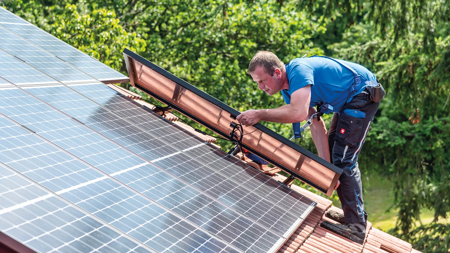

Configure even complex roofs with PV modules – SuperFlex Design makes this possible
Ürünler ve Çözümler
25.05.2021
The new GEN24 Plus impresses with maximum flexibility in PV system design. In addition to two Maximum Power Point trackers, the inverter also has a separate battery input. The high current carrying capacity of the MPP trackers and the wide input voltage range of the inverter enable both a parallel connection on one MPP tracker and the configuration of smaller, complex module areas.
Flexible string configuration
The GEN24 Plus is equipped with two MPP trackers and an additional battery input. However, contrary to popular belief, the number of MPP trackers does not make an inverter flexible. Rather, a well-adjusted MPP voltage range and a powerful MPP tracker are crucial for design flexibility.
What’s more, the inverter boasts an extremely wide and low-starting input voltage range. This means that very short strings can also be dimensioned from three PV modules so that the inverter can in turn be used extremely flexibly for angled roofs.
Complex areas such as dormer windows, windows, garden sheds, eaves mouldings or even façade modules can be easily connected to the second MPP tracker with PV modules configured.

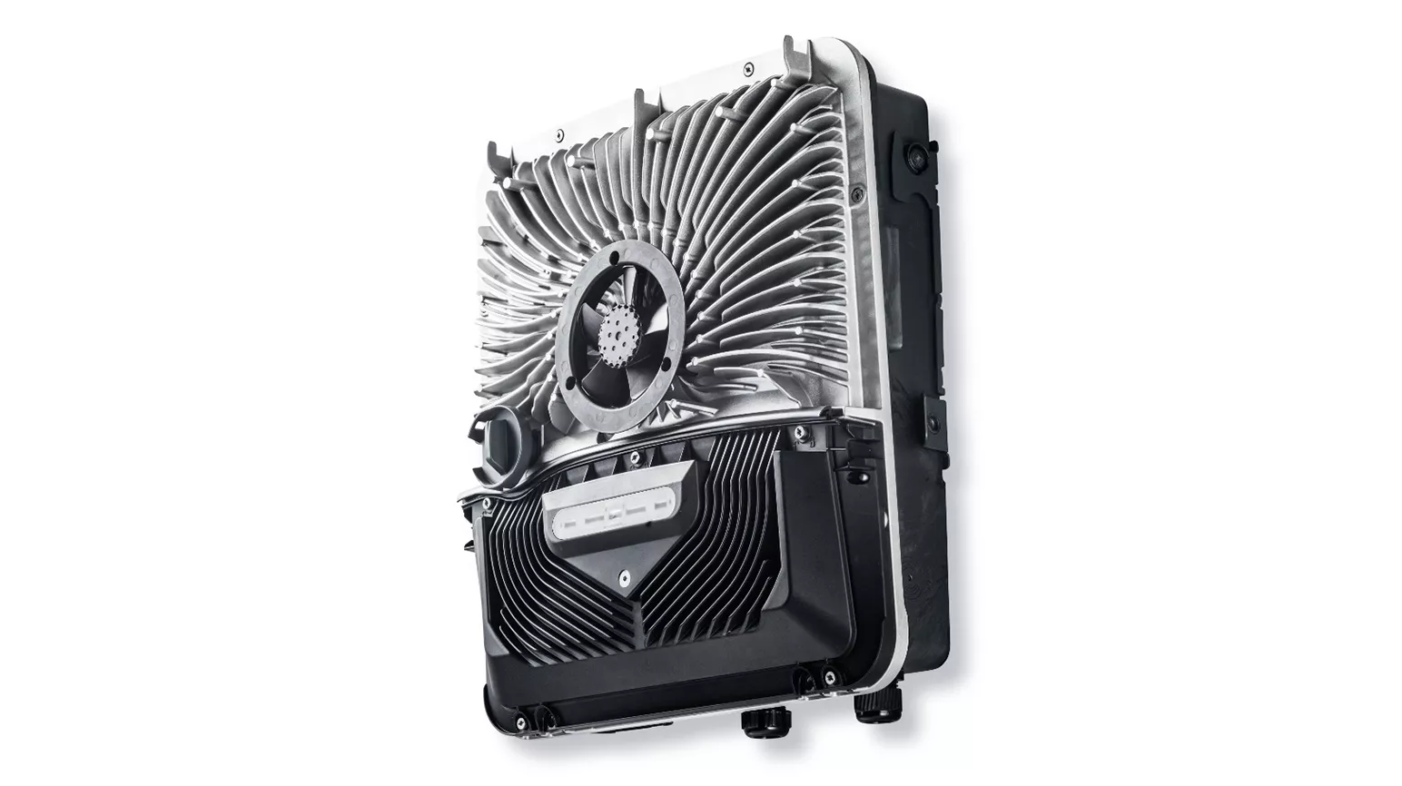

Furthermore, the maximum generator output can be overdimensioned to 150%, since the peak output of the PV generator is not reached in most cases. More energy can therefore be produced throughout the entire year.
But that’s not all: if, for example, the situation results in two roof areas with the same inclination and number of modules (for example East/West facing), then these two areas can be connected to MPP tracker 1 due to the high current carrying capacity, and the other previously mentioned small, complex area to the second.
Due to the innovative Active Cooling technology, the GEN24 Plus inverters have an extremely high current carrying capacity. This is because high currents are known for also generating high temperatures.
