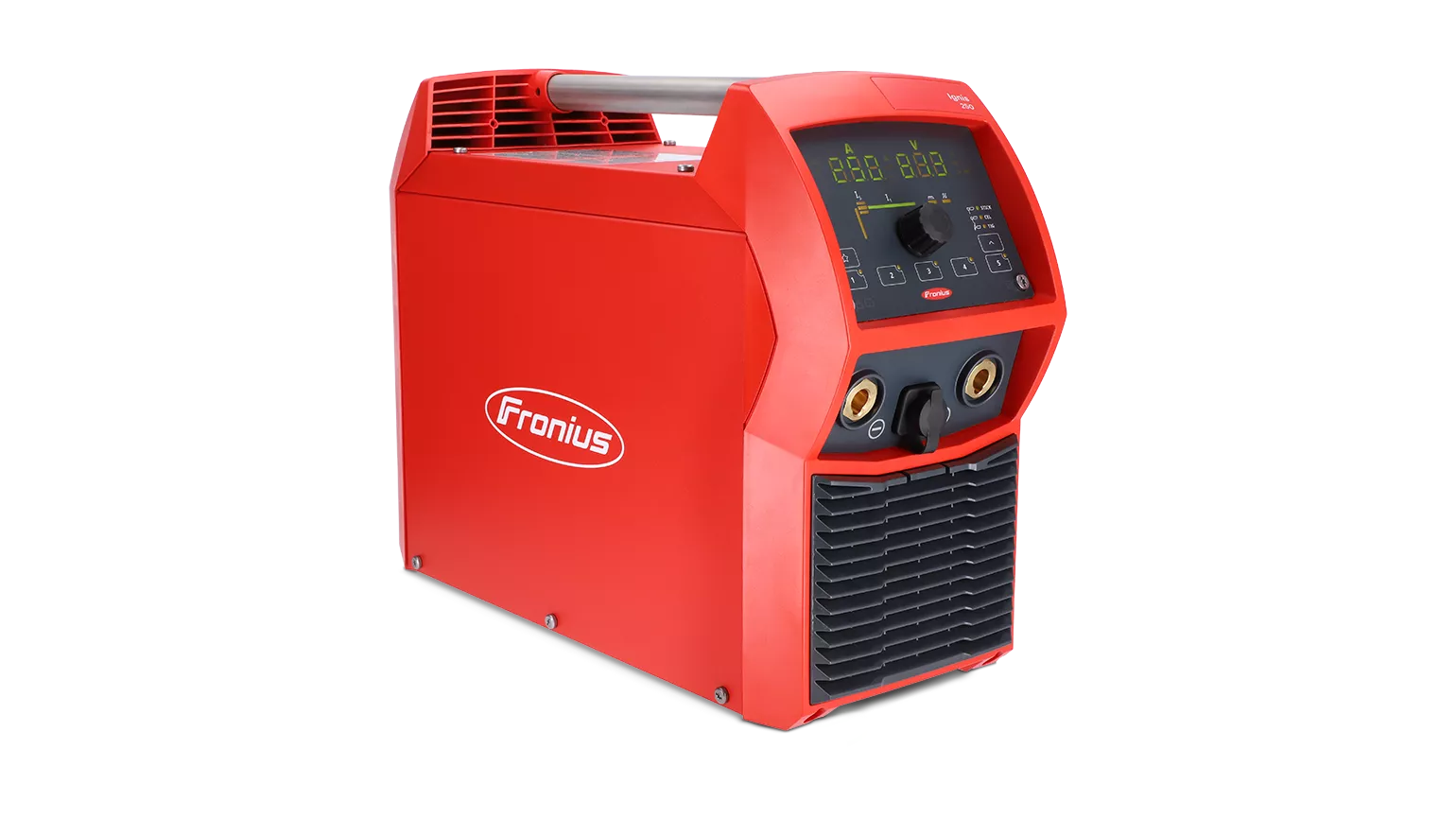

The Ignis 250 impresses with its reliable welding power of up to 250 ampere for electrode welding—even under difficult conditions such as unstable mains power or generator-powered operation. It always ensures a stable arc and perfect welding results, even over long distances.
Technical Data
General Data
| Welding current min. | 10 A |
| Welding current max. | 250 A |
| Operating voltage min. | 20,4 V |
| Open-circuit voltage | 101 V |
| Dimension / length | 488 mm |
| Dimension / width | 210 mm |
| Dimension / height | 369 mm |
| Weight | 17,96 kg |
