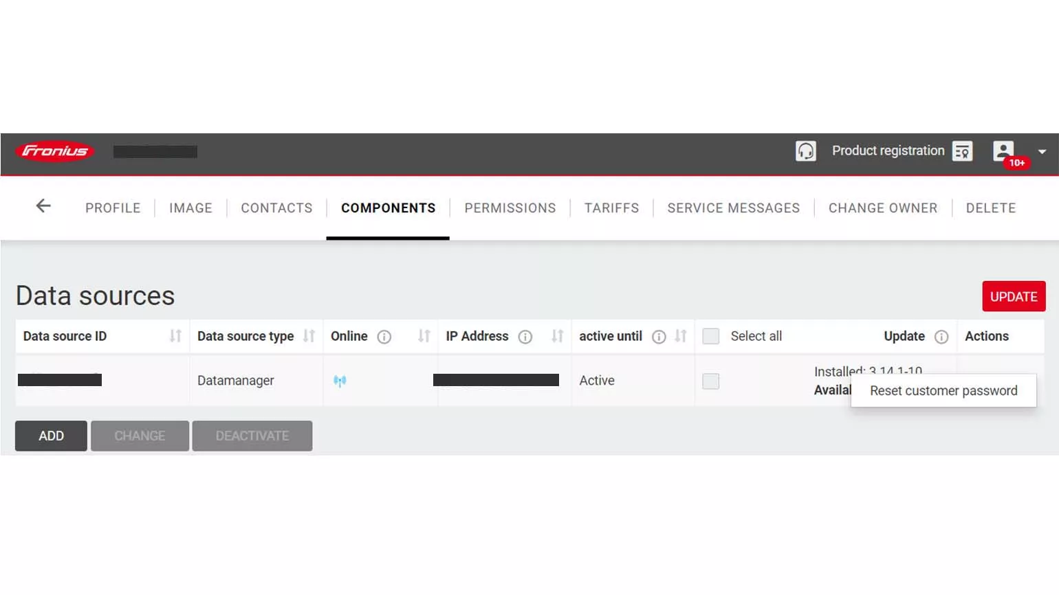

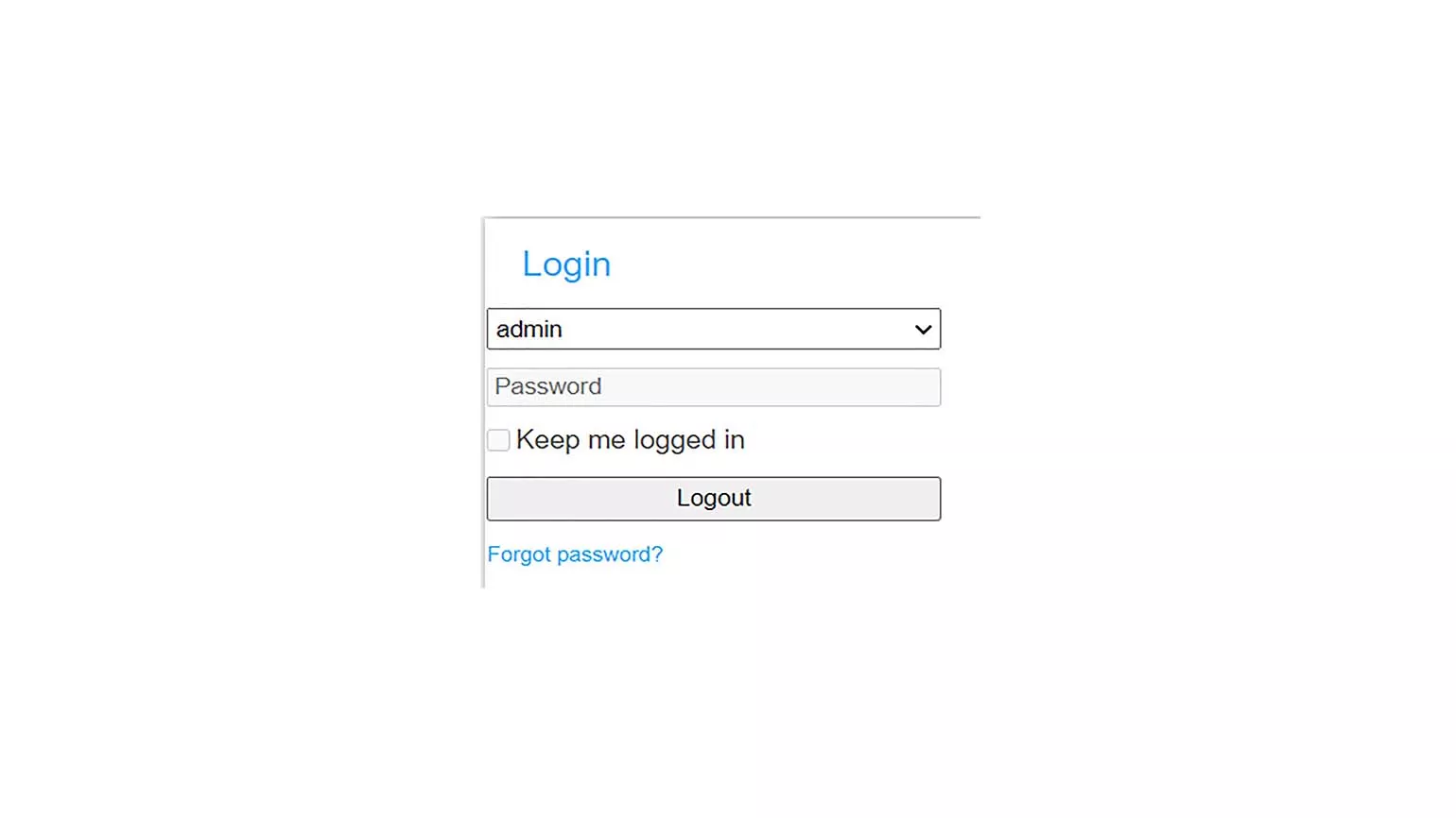

If a password for the local user interface of the SnapINverter has been forgotten, click on “Forgot password?” to generate a pin for the respective user role (“user”, “admin” or “service”). This pin can be used to generate a recovery key through which the respective password can be reset.
To reset the “admin” password, go to your system on Fronius Solar.web with the generated pin. Go to “Settings” --> “Components” and click on “Actions” for the data source of the respective inverter. Create the recovery key for your new “admin” password using the “Reset customer password” function.
Only the owner of the Solar.web system can use the “Reset customer password” function. If you do not see the function displayed, you are not set as the owner of the system. In this case, please contact the installer of your system.
1 / 5

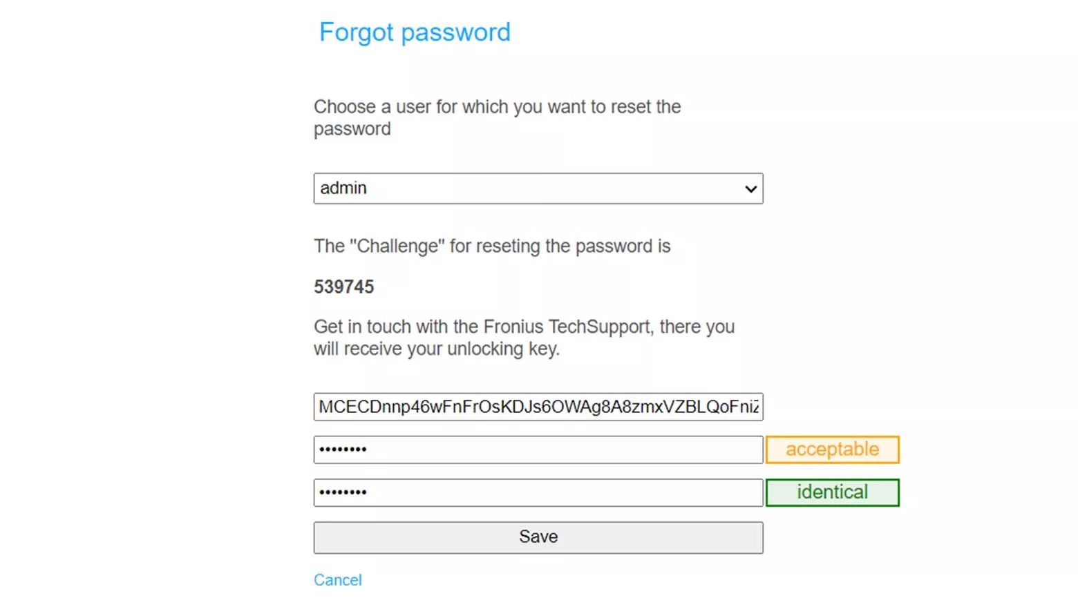

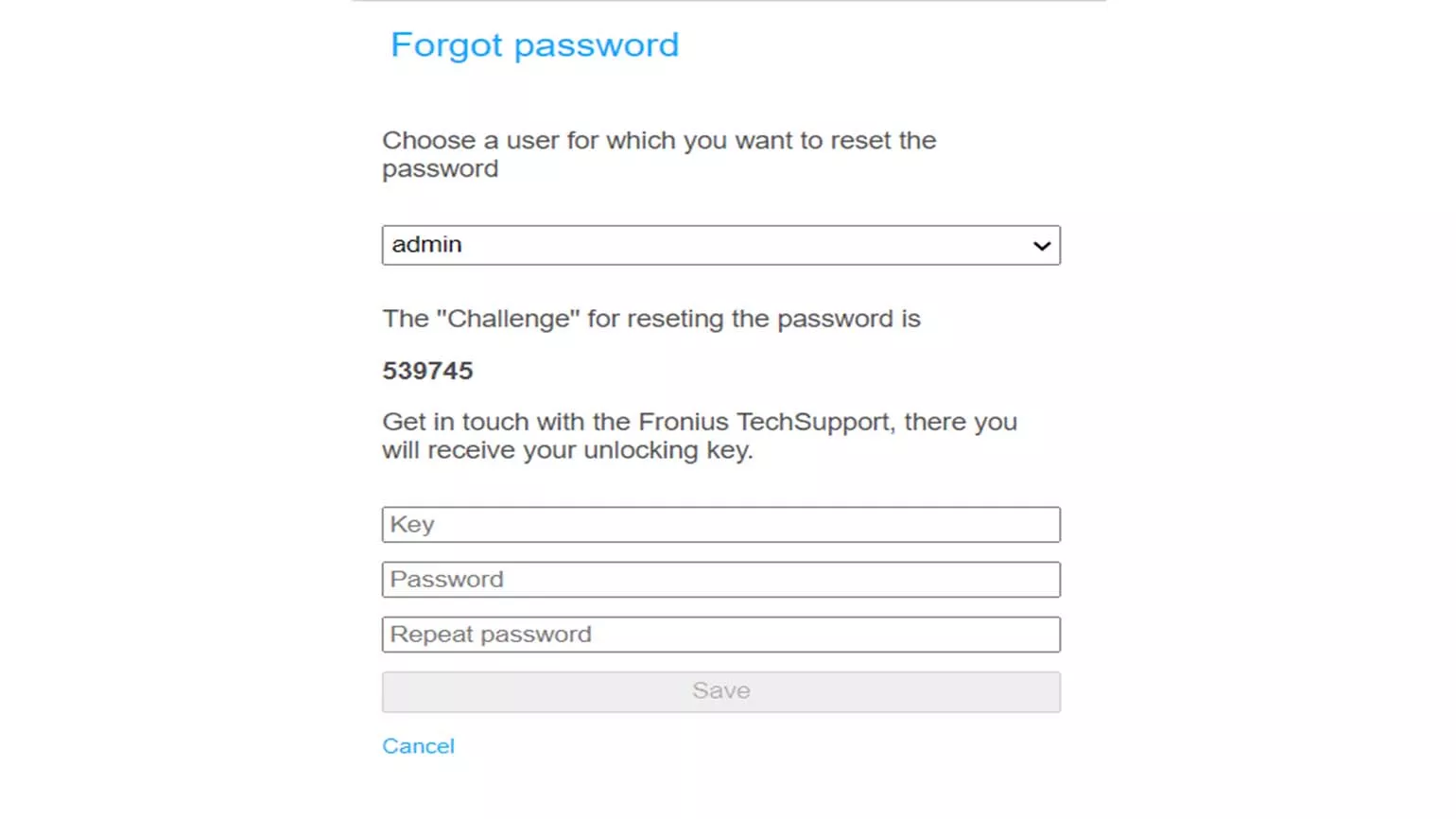

1. Click on “Forgot password” on the login page
2. Select the role for which the password is to be reset and click on “Generate”. Copy or write down the “challenge”

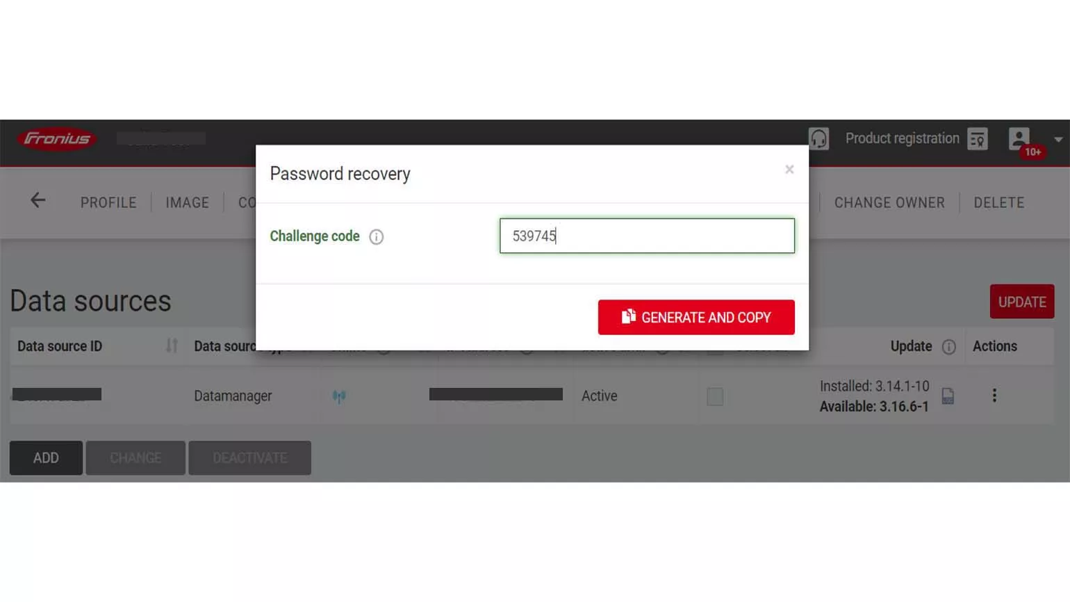

3. Go to your system in Fronius Solar.web. Go to Settings - Components. Click on the three dots under “Actions” and then on “Reset customer password” next to the Datamanager for which the password is to be reset.
4. Create a “key”, enter the “challenge” and click on “Generate and copy”. A “key” is created and automatically saved to the clipboard
5. Enter the “key” in the web interface of the Datamanager and assign a new password. Click “Save”
The "service" password can only be reset using a recovery key created by Fronius TechSupport. Resetting the "service" password is reserved for trained specialist personnel (electrician, system installer, Fronius System Partner). To reset the "service" password, please contact the installer of your system.
Please note that the recovery key is only valid as long as the corresponding pin is displayed on the user interface of the SnapINverter (Data-/Hybridmanager) when you click “Forgot password?“. After restarting the inverter or after entering an incorrect recovery key five times, a new pin is generated. In this case, a new recovery key must also be generated.
