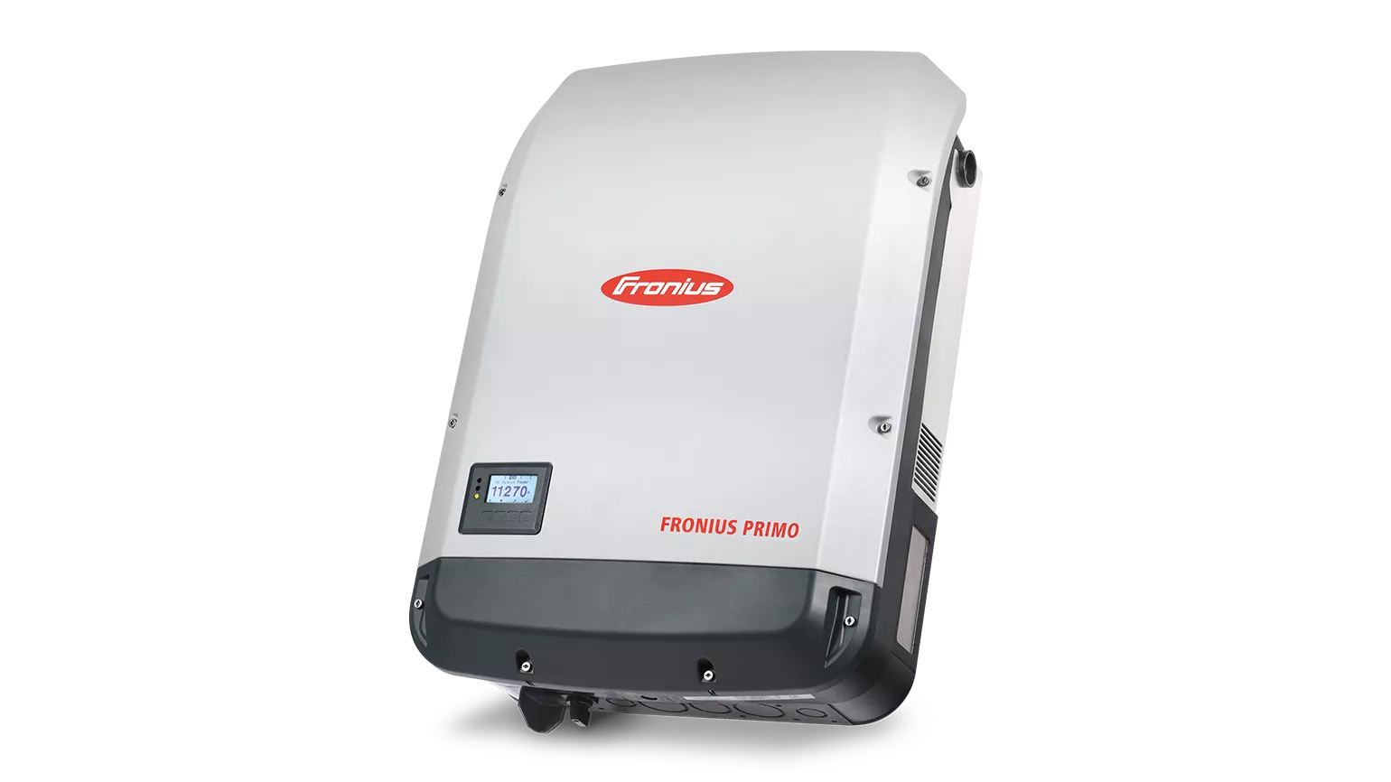

Fronius Primo UL
The communicative inverter for private households.
The tranformerless Fronius Primo is the ideal compact single-phase inverter for residential and small-scale commercial applications with power categories from 3.8 to 8.2 kW. In accordance with ESA rules for residential applications, the Fronius Primo can operate efficiently at a maximum input voltage of 600 V. And for increased efficiency and additional cost savings for commercial applications, the Fronius Primo can operate at the maximum input voltage of 1,000 V.
Industry-leading features now come standard with the Fronius Primo, including: dual maximum power point tracking, arc fault protection, integrated wireless monitoring and SunSpec Modbus interfaces for seamless monitoring and datalogging via Fronius' online and mobile platform, Fronius Solar.web.
