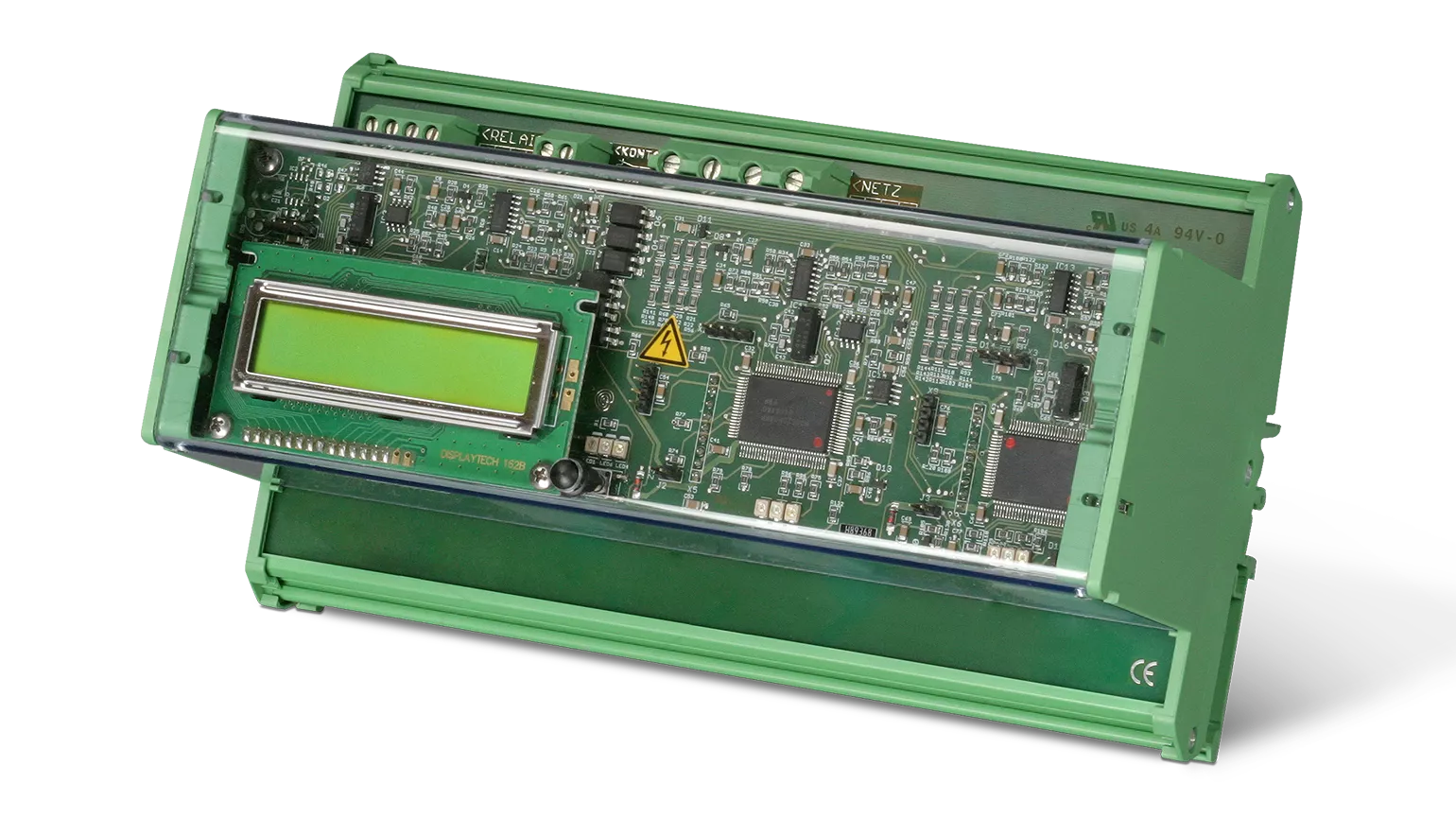

When VDE-AR-N 4105 came into force on 1st January 2012, all new photovoltaic system installations in Germany of more than 30 kVA had to be fitted with external grid and system protection. This mechanism detects overvoltages, undervoltages and frequency deviations at the feed-in point and, if necessary, disconnects the inverter from the grid. The inverter is reconnected automatically when the grid is within the permitted limits again.

Dimension / width105 mm
Dimension / height90 mm
Dimension / depth69 mm
Weight0,25 kg
Switching capacityDepends on which contactors are assigned
Degree of protectionIP 30
Ambient temperature range-20°C - +55°C
Humidity10 - 90% relative humidity, non-condensing
HousingPlastic, for mounting on DIN rail
Maximum feed-in currentAccording to the switching capacity of the contactors
