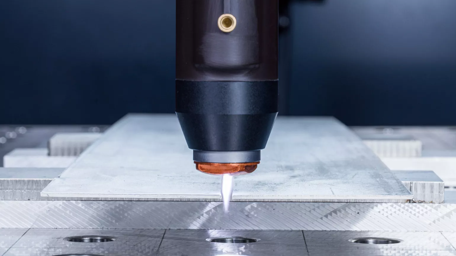

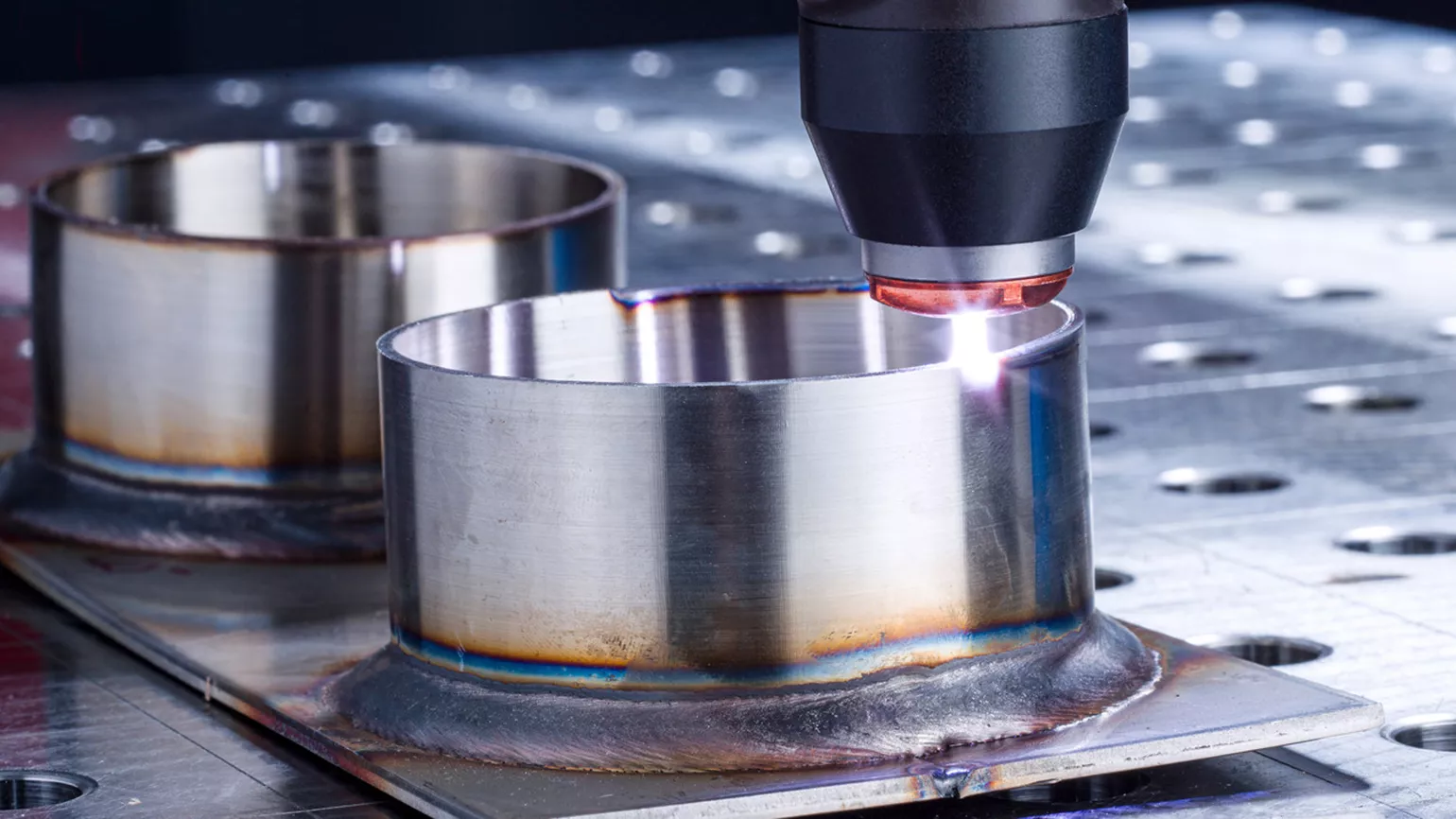

A technology developed by Fronius can help: hot active plasma removes residues quickly and effectively with pinpoint precision. The application areas range from aluminum and steel through to plastic, glass, and ceramic. The Acerios system generates a plasma flame with a temperature of up to 1,000 degrees Celsius, while a robot guides the welding torch over the surface at speeds of roughly 6 meters per minute.
Depending on requirements, entire surfaces or specific areas can be treated. This significantly increases efficiency, as instead of cleaning as much of the surface as possible, Acerios cleans only those areas that actually need cleaning. This immediately conserves resources, again emphasizing the environmentally friendly aspect of this technology due to the absence of harmful cleaning additives.
Fronius develops atmospheric pressure plasma
By using plasma in its welding technology, Fronius has extensive expertise in this area. The company has also been researching possible applications for plasma in surface treatment for almost ten years, the key to this eventually being found in the generation of atmospheric pressure plasma. This is a hot, gaseous, and energy-intensive mixture of atoms, molecules, ions, and free electrons.
When the hot active plasma comes into contact with a surface, the gas flow mechanically cleans while the plasma and resulting heat trigger a chemical process. This combination of a chemical and mechanical process reliably removes organic residues and film impurities.

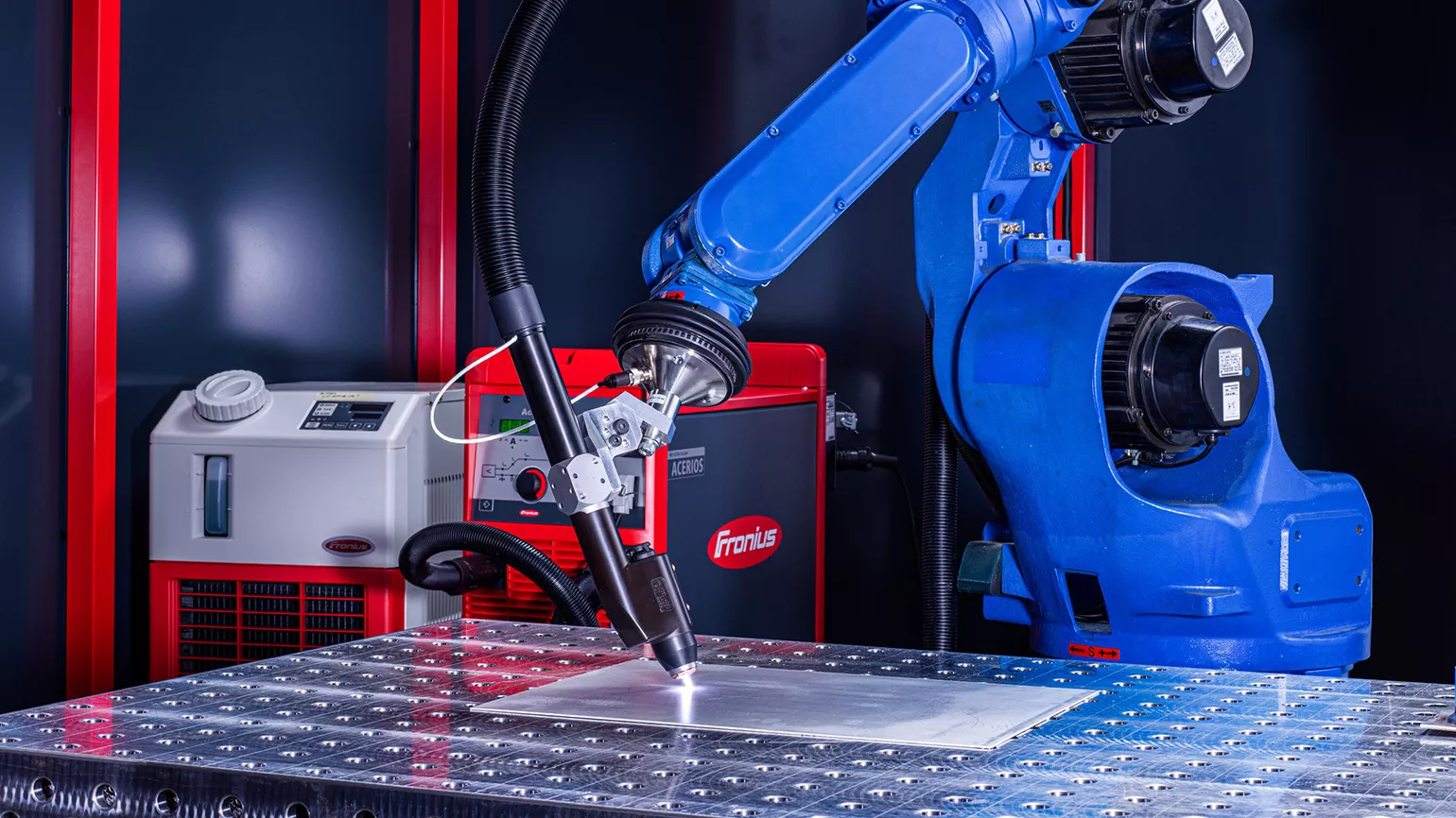

Easy integration and simple system design
The Acerios system consists of just a few components:
  • Plasma torch with active cooling
  • Power source with a power range from 35 to 200 amperes
  • Industrial robot which guides the welding torch
  • Active process gas control
  • Cooling system with varying performance depending on the operating mode (from spot to continuous operation)
The system is compact and can be easily integrated into automated systems and production lines thanks to different interface variants. Pre-defined job settings shorten the training phase and make the device intuitive to use. Acerios is therefore a simple, affordable, and environmentally friendly technology for surface treatment.
