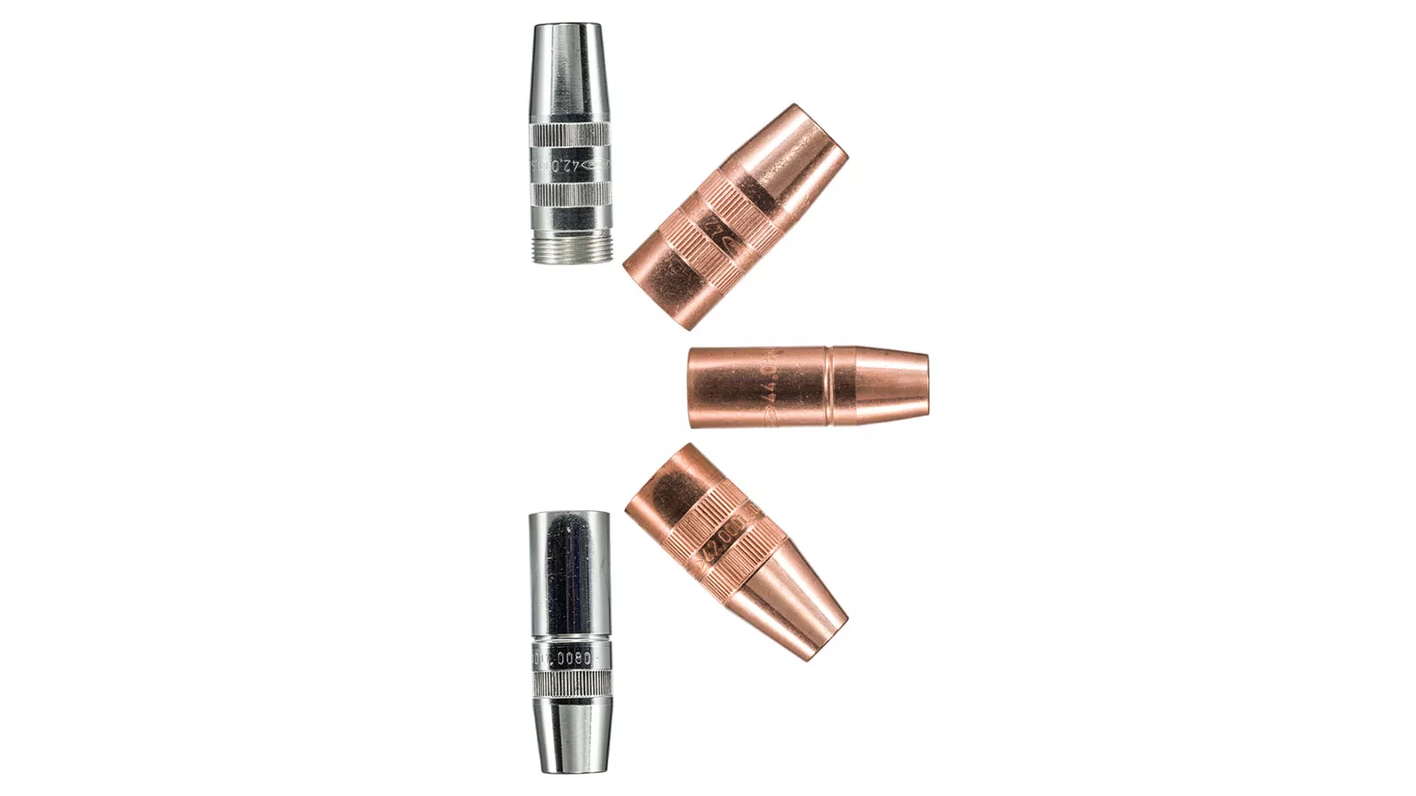

Long wearing part lifetimes
Each wearing part is designed and manufactured to deliver the longest service life and for optimal heat dissipation. For example, a high-quality copper alloy (CuCrZr) is used for the contact tips in order to extend their service life.

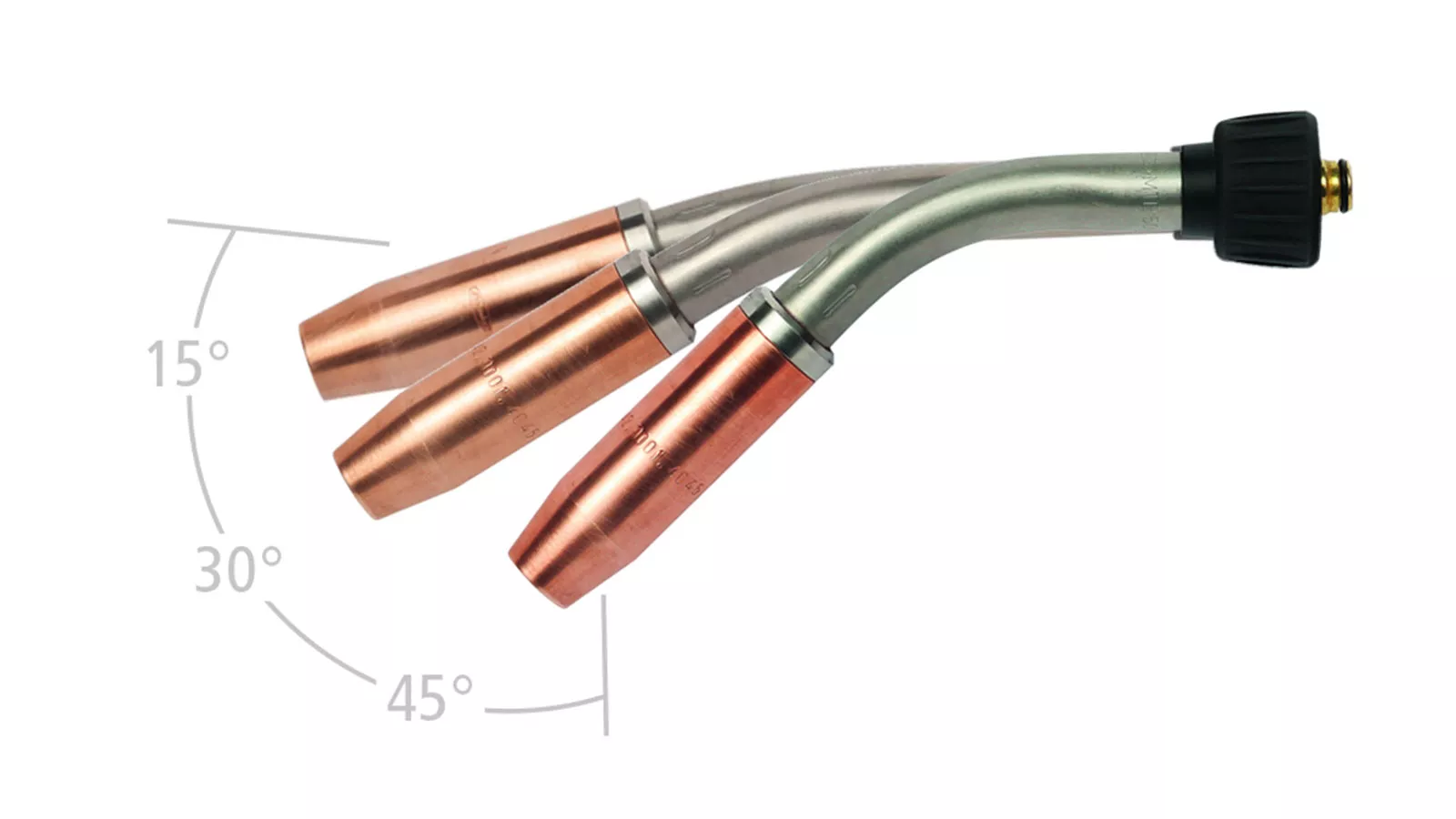

Flexible
The Multilock System leaves you with a wide choice of over 80 different torch bodies of different lengths and angles, affording the welder even greater flexibility. Torch bodies can also be produced to customer-specific requirements at lengths of up to 3.9 ft and angles from 0-90°.

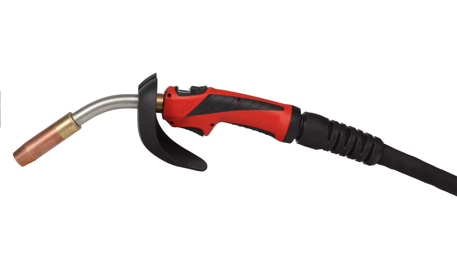

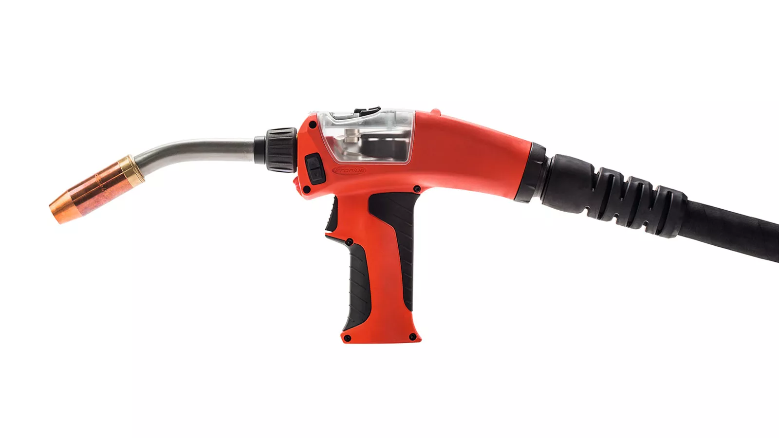

    MTG
    • The welding torches in the MTG product family are gas-cooled MIG/MAG manual welding torches with an output of up to 530 A.
    • The ergonomically shaped grip, a ball joint and optimum weight distribution allow for effortless operation.
    • Their robust design makes the welding torches reliable partners for all applications.

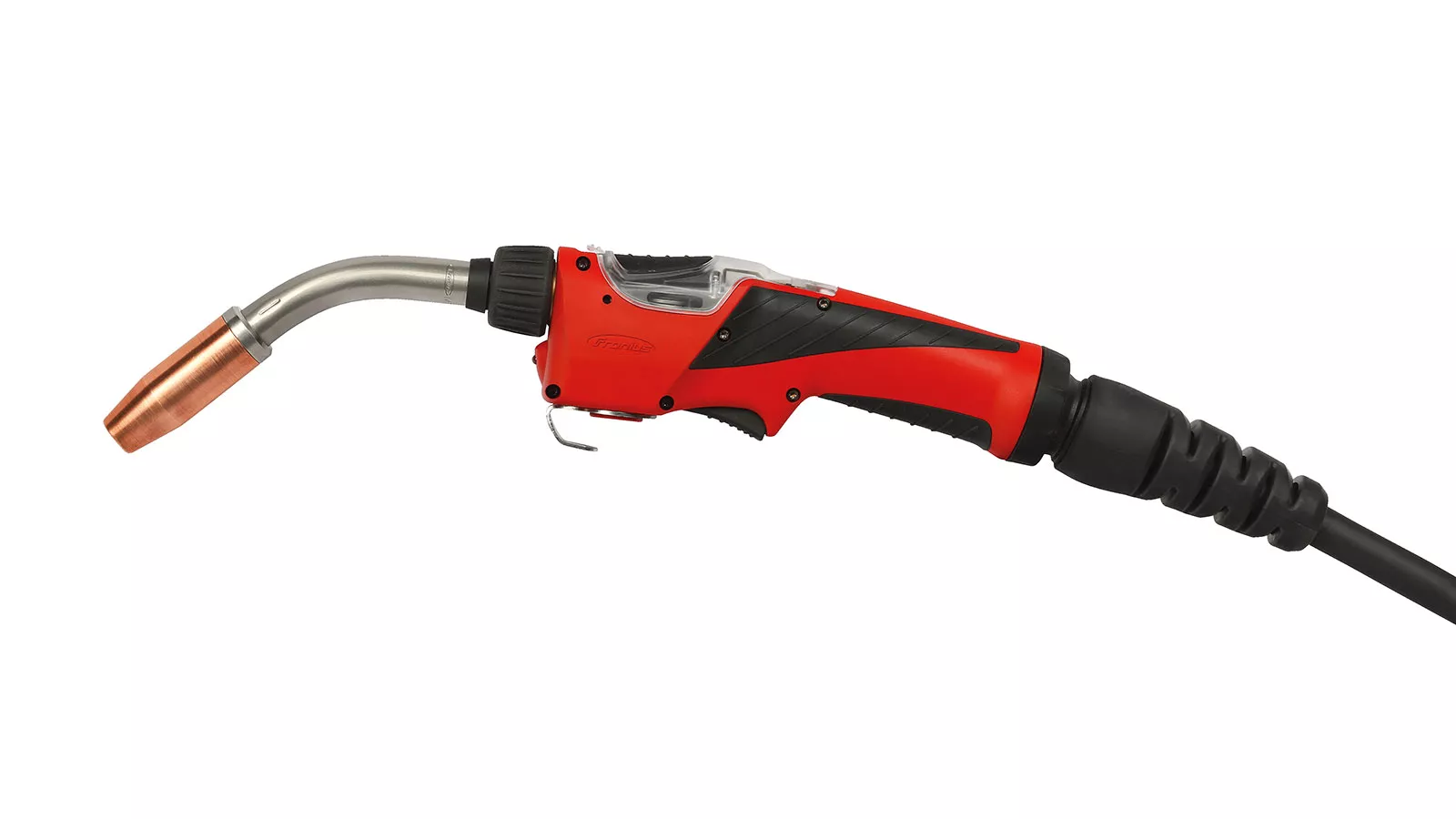

    MTW
    • The welding torches in the MTW product family are water-cooled MIG/MAG manual welding torches with an output of up to 700 A.

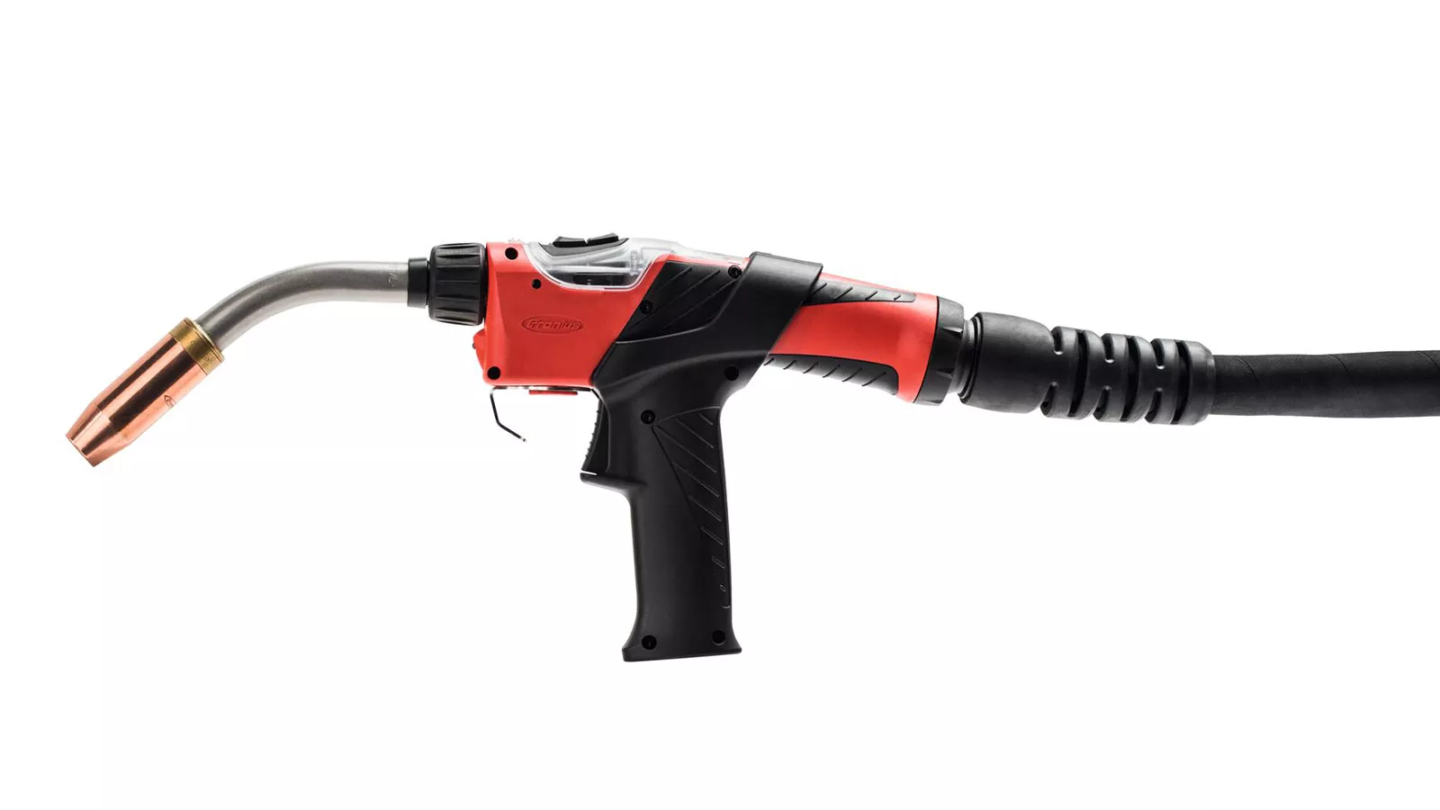

    PullMig
    • The PullMig welding torch from Fronius weighs only around a third as much as comparable models.
    • The design is so compact that there is hardly any noticeable difference in size from conventional, manual welding torches – yet the torch delivers unrivalled precision.
    • The Multilock torch body, which can be rotated through 360°, serves as the base of the torch, with a stainless steel outer pipe and integrated water stop in the hosepack.

    Perfectly cooled
    Video: Cooling
    Cost efficient through robustness
    The gas-cooled MIG / MAG welding torches get the most out of any application. Perfect cooling can also maximize the service life of  components and thus improve cost efficiency.
    Water cooling system
    On water-cooled systems the cooling system has been brought forward and outward as far as possible. The shape of the contact tip means that less radiant heat is now absorbed. This alone brings a temperature reduction of up to 70 °C for the wearing parts.

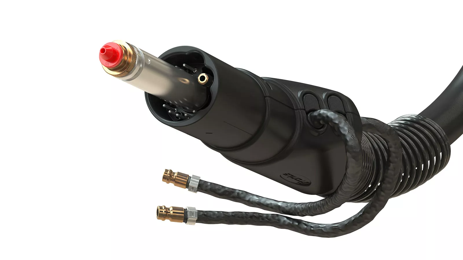

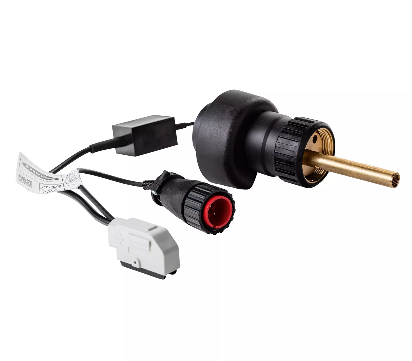

    FSC - One connection for all media
    The Fronius System Connector (FSC) serves as a central connection for all media. This ensures the hose pack to be connected easily and safely to the wire feeder in less than 10 seconds - without tools. For welding equipment from other manufacturers, 4 different central connection variants (suitable for Euro, Lincoln, Miller, Hobart) are offered to guarantee the highest possible compatibility. For this purpose standalone hose packs with corresponding connectors or adapters for existing hose packs are offered. You can get more detailed information from our sales consultants.

    With a range of more than 80 different torch bodies available, the perfect combination of angle and length can be selected for components with challenging geometries. In addition, individual solutions are possible to meet customer-specific requirements.

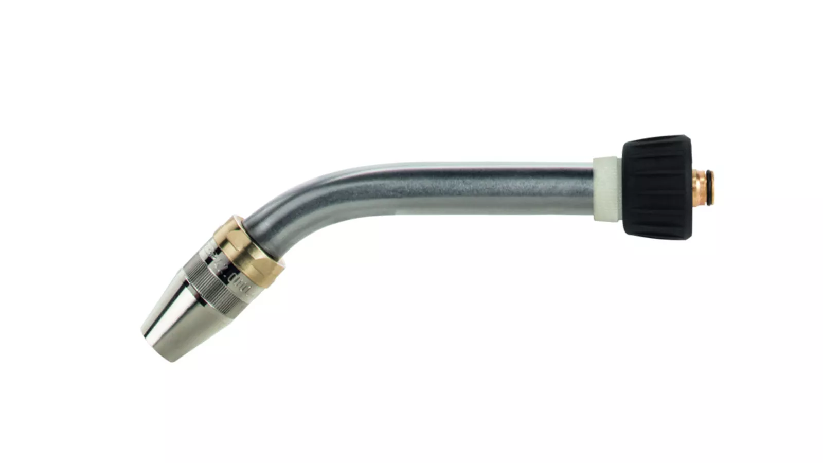

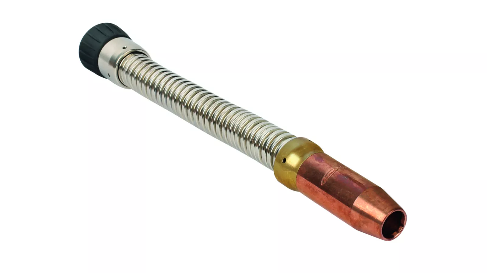

    MultiLock - Patented interface
    The MultiLock system enables the torch body to be changed quickly without having to replace the entire hose package. This enables flexible adaptation to the respective welding challenge.
    • 360° | The torch body can be turned through 360° to permit the greatestpossible welding flexibility on components with challenging geometries.
    • | The 0° position is fixed by an antitwist device.
    • Integrated water stop | Prevents water from escaping when the torch body is removed.

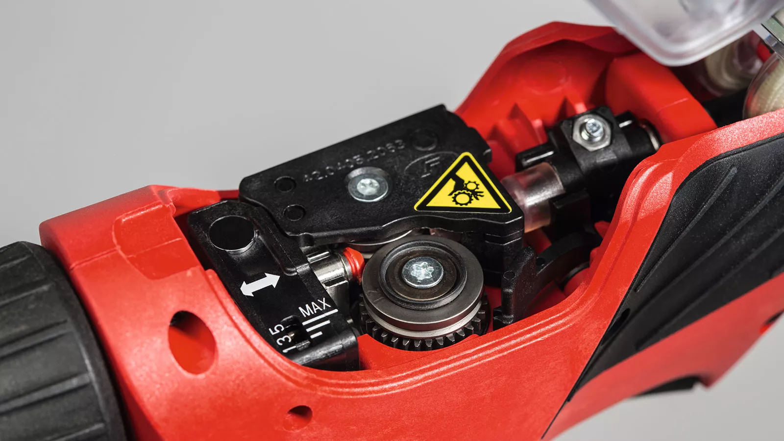

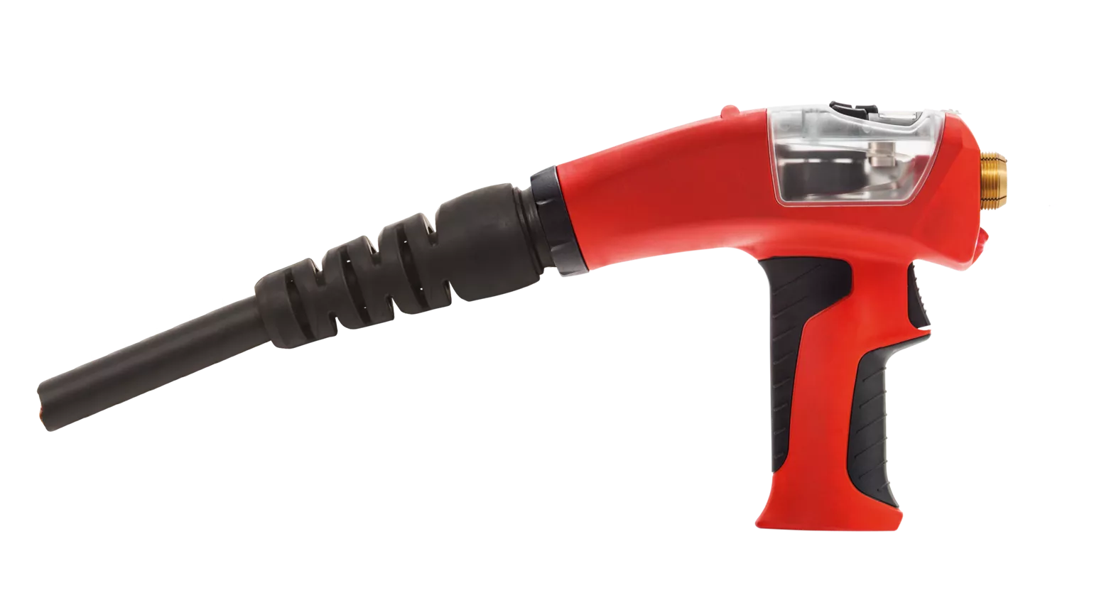

    At a working height of 3.3 ft, the PullMig welding torch weighs just 3.5 kg and is therefore 30% lighter than comparable models. Its compact design means there is barely any size difference to conventional welding torches. The PullMig is a favorite for aluminum applications and where long hosepacks is required (up to 49.2 ft) – situations in which a reliable and precise wirefeed is essential.
    For the CMT welding process Fronius specially developed the PullMig CMT welding torch with a highly dynamic drive motor.

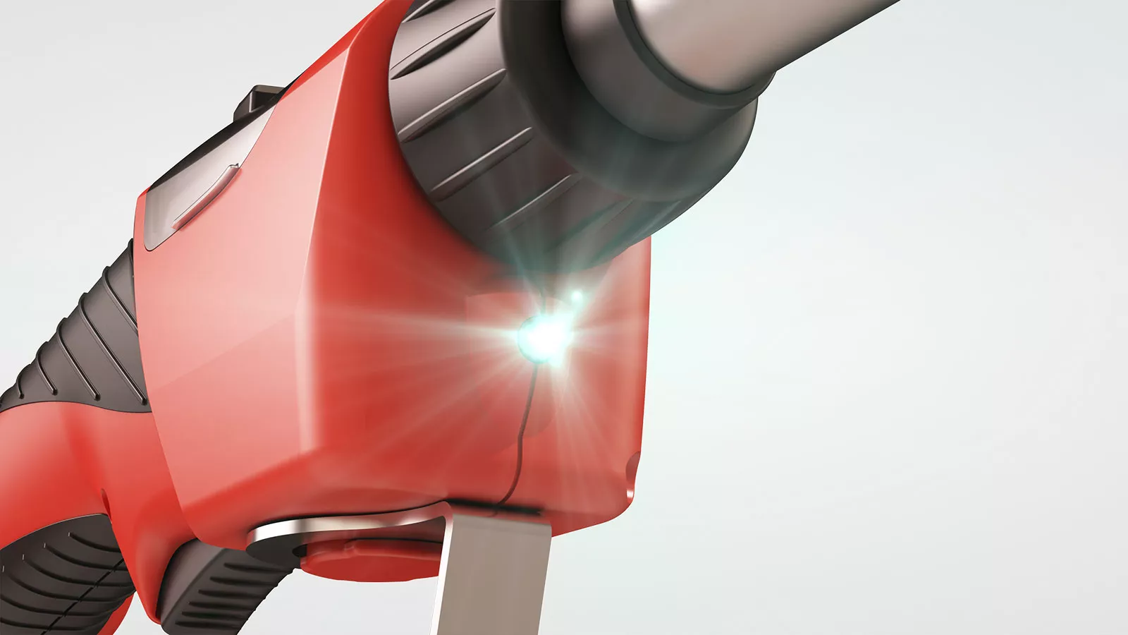

    LED-lighting

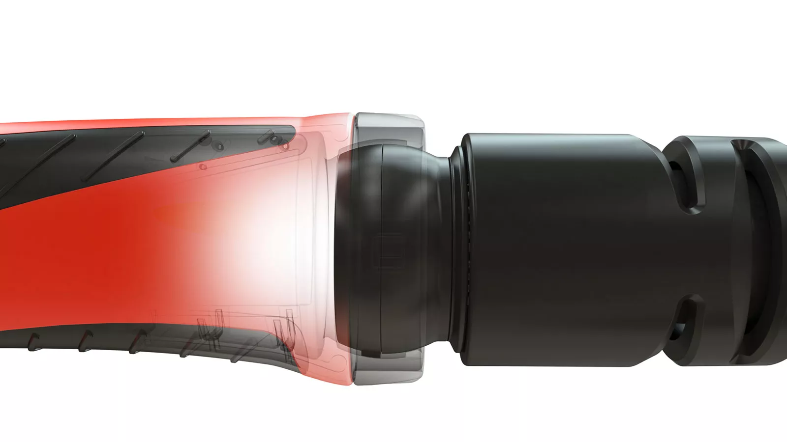

    Optimized for professional use

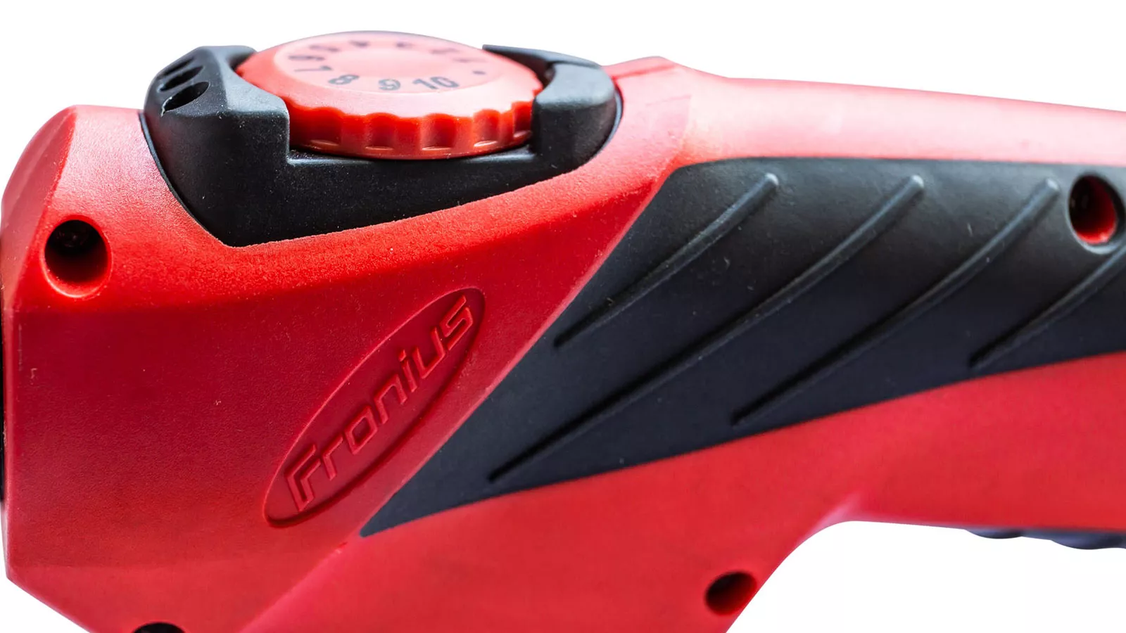

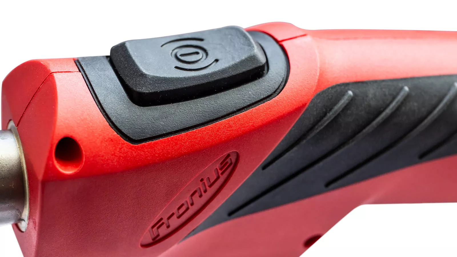

    Fronius welding torches represent the perfect symbiotic relationship between technology and ergonomics. The ergonomic handle with anti-slip components lies comfortably and securely in the hand, allowing the torch to be guided with ease. The ball joint and optimal weight distribution prevent fatigue during welding.

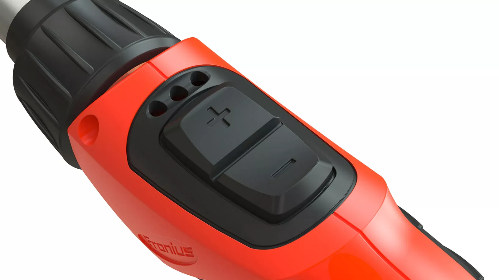

    JobMaster: Everything is under control
    With JobMaster welding torches, the welder can use the remote control with color display integrated in the handle to get a quick overview of important welding parameters such as welding power, wire speed, and previously stored jobs, and can adjust them to the desired value.
