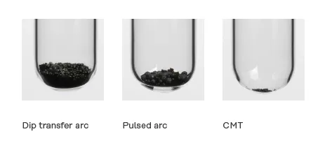

High-speed, low-heat input, virtually spatter-free welding
Wherever adhesive or solder was used before, CMT (Cold Metal Transfer) welding can be used instead. CMT has revolutionized welding technology and expanded the range of possible applications with its reversing wire movement.
The back and forth movement (reversing) of the welding wire—at up to 170 Hertz—produces an exceptionally stable arc. This results in a 33% reduction in heat input and a welding speed almost twice as fast as with conventional dip transfer arc.

Welding does not inevitably have to mean welding spatter and rework. CMT promotes controlled droplet detachment during the short circuit, while the current is kept low. The result is virtually spatter-free material transfer.

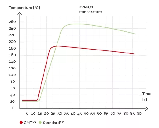

Heat input at the lowest level: as soon as the short circuit occurs, the wire is pulled back again during the CMT process. This means that the arc only introduces heat for a very short time.
As a result, CMT enables continuous regulation of the heat input from cold to hot. In addition, higher welding speeds and a wider range of applications* are possible with maximum weld quality.
Reduced heat input
* Compared with standard dip transfer arc

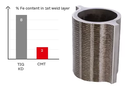

The characteristic for cladding with low penetration, low dilution, and wide weld seam flow for better wetting
More information on cladding
CMT cladding: 75% less dilution of base and filler metals
In conventional overlay welding, the arc fuses a relatively large amount of the base material.
The typical dilution and mixing of base material with filler material reduces the corrosion resistance of the applied layer. However, the base materials are melted to a lesser extent due to the lower heat input of the CMT process. This results in up to 75% less metallurgical mixing of the base and filler materials, and reduces costs for overlay welding.

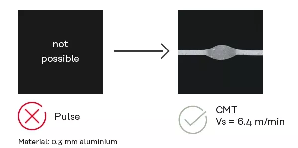

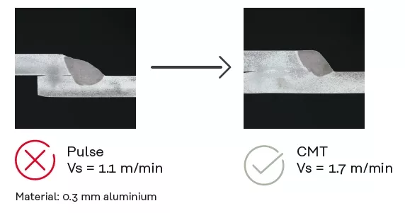

Light gauge (≤ 1 mm) aluminum sheets can be welded.
The low heat input of this process means that weld-pool support isn't necessary to keep the weld from dropping through.
