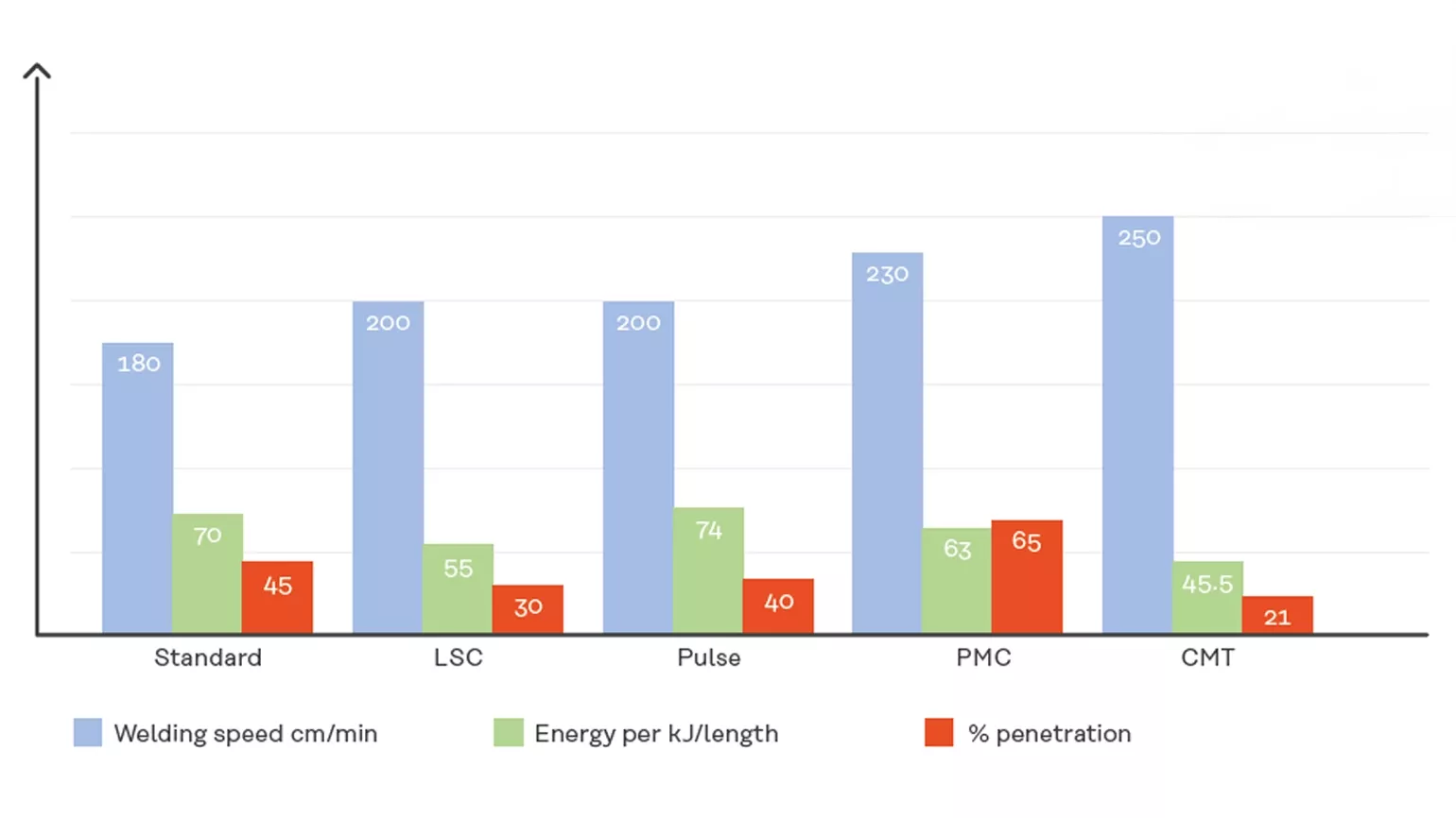

/ 15% higher welding speed*
/ 15% less energy input*

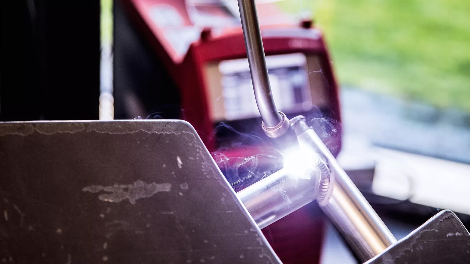

The PMC characteristic for visually impressive seams. The result is elegant seam jointing with a TIG aesthetic. However, the speed is significantly higher than with TIG—thanks to the optimally coordinated pulse process, combined with defined pause times.

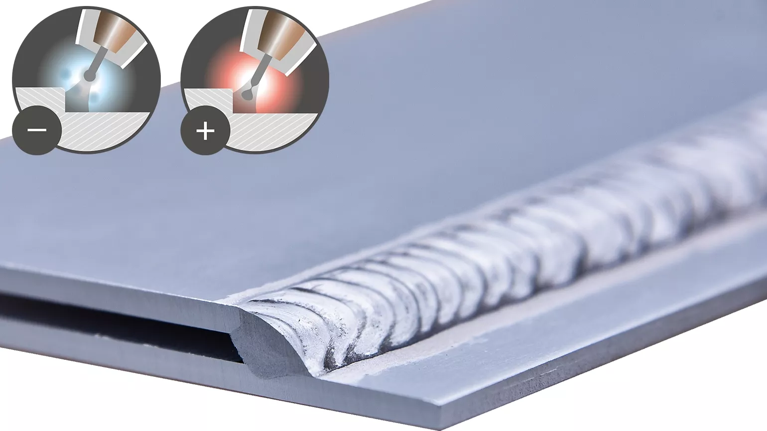

PMC AC*
Reverse polarity of the wire electrode
Optimal for welding thin or ultra-light gage sheet joints: the PMC AC process enables remarkably low heat input at a constant deposition rate. The special thing about this technology is that the positive and negative component can be easily adjusted with the help of correction parameters. The result is precise control over the heat input.
The benefits:
/ Low heat input
/ Excellent gap-bridging ability
Easy arc handling for manual and automated welding
Gleaming welds due to reduced magnesium oxides (for AlMg wires)
Lower welding fume emissions
PMC AC is available on the iWave AC/DC with Multiprocess Pro.

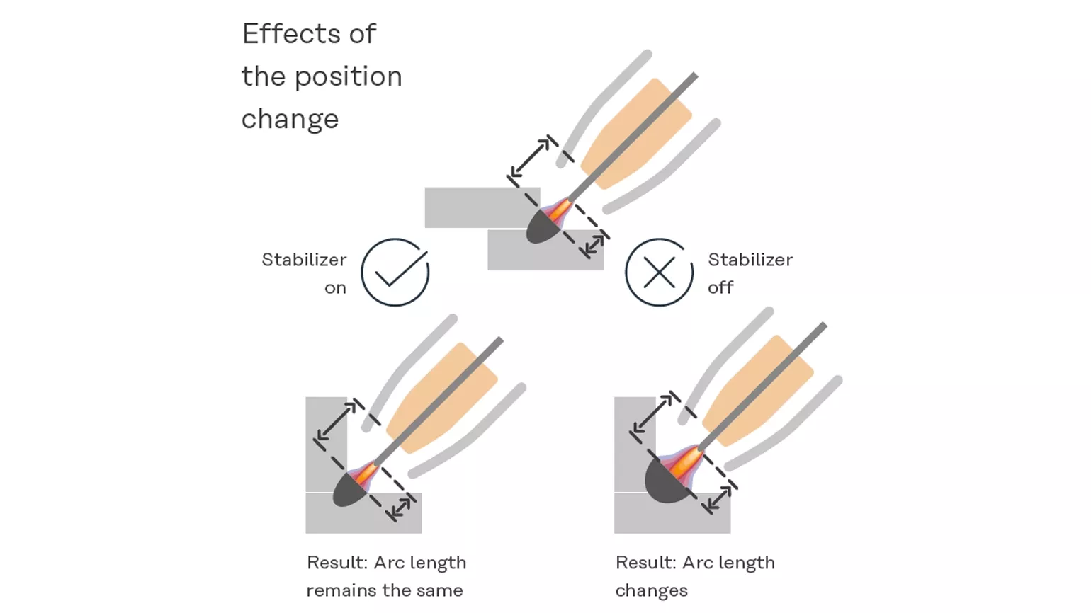

Arc length stabilizer
for a constant arc length
Automatically compensate for irregularities— the arc length is kept constant regardless of the welding voltage. This results in the seam quality remaining unchanged even if the torch position changes or the component tolerances vary.
Optimum support for the following circumstances:
/ Dynamic, changing position of the torch
/ Component tolerances: changing sheet thicknesses or gaps
/ Irregular heat dissipation
/ Changes in speed
The benefits:
/ No need for the welding operation to be interrupted or for manual readjustment of the arc length when the torch position changes
/ Reduced risk of undercuts
/ Quick determination of parameters
/ Focused arc
/ Higher welding speeds
