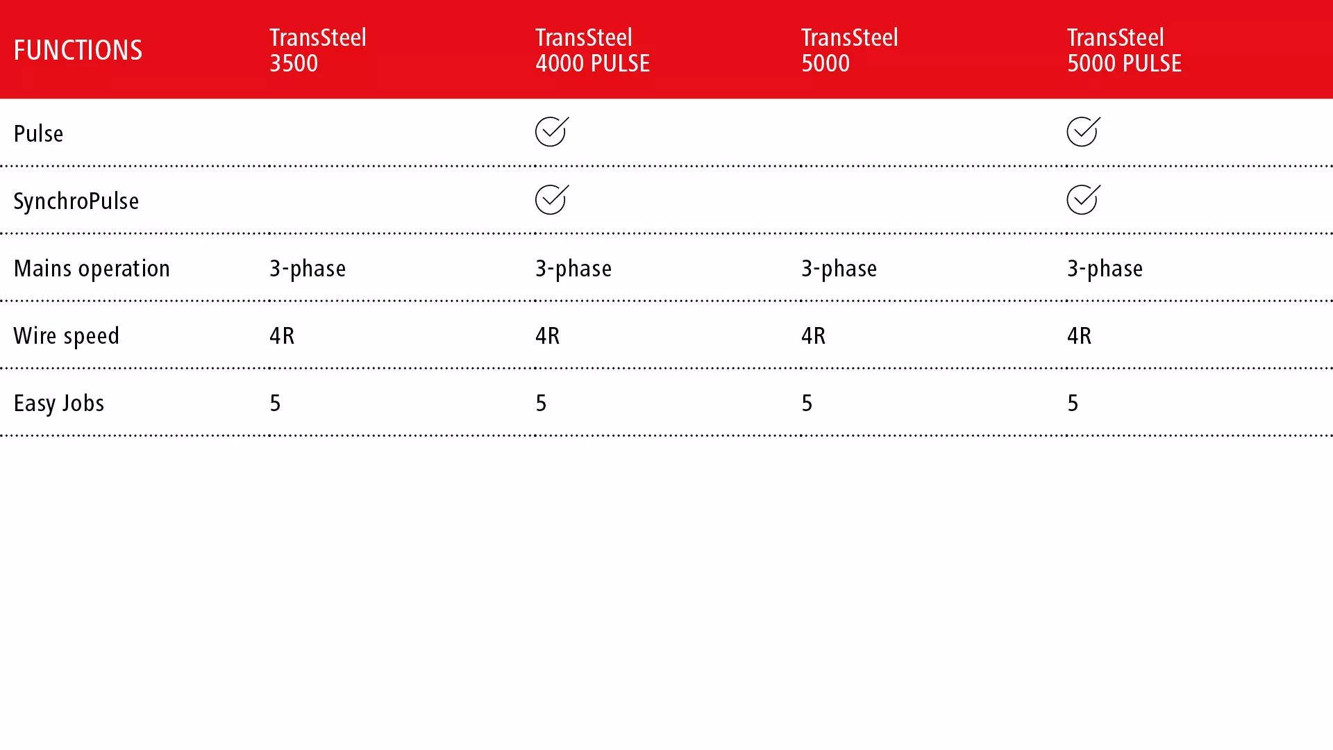

    The MIG/MAG welding functions
    Pulse
    Welding controlled and fast
    The new TransSteel 4000 Pulse and TransSteel 5000 Pulse mark the arrival of the pulsed arc in the TransSteel series. Controlled welding in the intermediate arc range together with optimum weldability when working with aluminum are now part of the basic package.

    SynchroPulse
    Seam rippling for aluminum alloys
    The “SynchroPulse” option is recommended for the welding of aluminum alloys when a rippled seam appearance is required. This effect is achieved by modifying the welding power between two operating points.
    SynchroPulse works in Standard Synergic and Pulse Synergic mode – but only on the TransSteel 4000 and 5000 Pulse.
