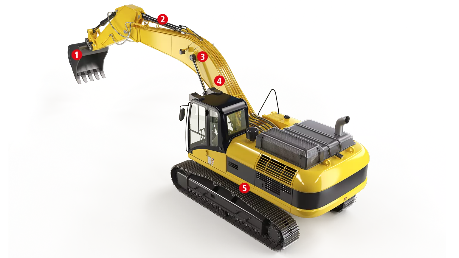

Excavator
Overlay welding
Challenges
  • High deposition rate
  • Robust equipment
Solution
TPS 600i single wire
  • Welding speed: 60 cm/min
  • Deposition rate: 8 kg/h
Circumferential weld
Challenges
  • Deep penetration
  • Low heat input
  • Little welding spatter
Solution
TPS TWIN CMT
  • Material thickness: 10 mm
  • Deposition rate: 12 kg/h
Fillet weld
Challenges
  • Welding speed
  • Low-spatter
Solution
  • Welding speed: 25 cm/min
  • Deposition rate: 11 kg/h
Fillet weld
Challenges
  • Deposition rate
  • Welding speed
  • Gap-bridging ability
Solution
TPS/i TWIN Push
  • Material thickness: 15 mm
  • Deposition rate: 18 kg/h
Butt weld
Challenges
  • Deep penetration
  • Single-pass welding
Solution
TPS/i TWIN Push
  • Deposition rate: 20 kg/h
Challenges
  • Stable ignition
  • Robust welding torch
  • Interval welding
Solution
TransSteel 3500
High-quality weld seams are absolutely essential when manufacturing components for excavators. Enormous forces act on the individual components such as the frame, boom, or bucket. Perfect weld seams are an important safety criterion.

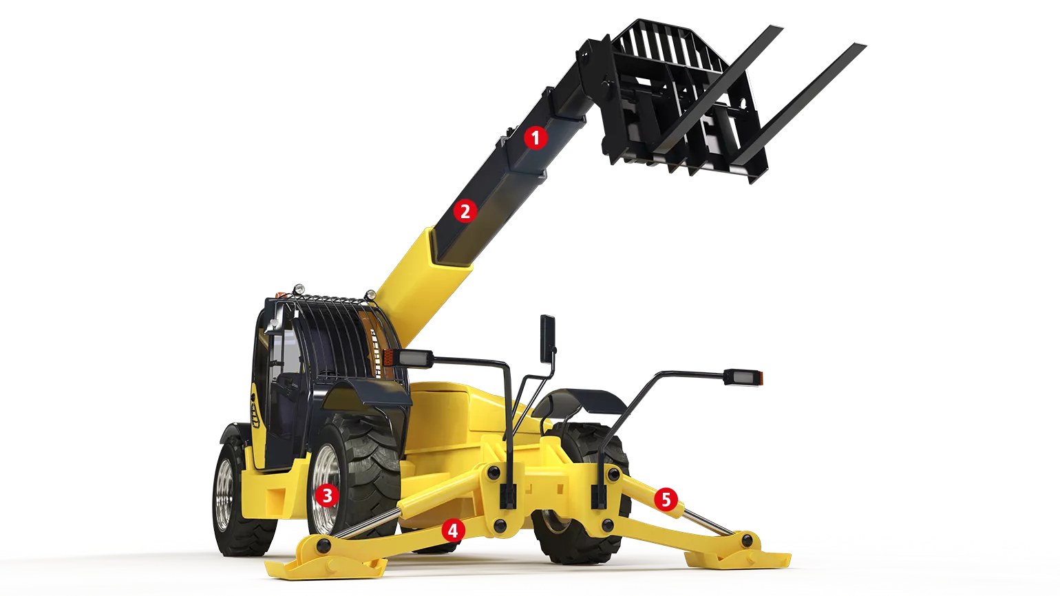

Telescopic handler
Fillet weld
Challenges
  • High welding speed
  • Low heat input
Solution
TPS TWIN CMT
  • Material thickness: 8 mm
  • Welding speed: 150 cm/min
  • Deposition rate: 13 kg/h
Butt weld
Challenges
  • Horizontal position
  • Single-layer welding
  • No backing
Solution
LaserHybrid
  • Material thickness: 6 mm
  • Welding speed: 180 cm/min
  • Deposition rate: 4 kg/h
Challenges
  • Low-spatter
  • High-quality weld seam appearance
  • Excellent gap-bridging ability
Solution
TPS/i TWIN Push
  • Welding speed: 100 cm/min
  • Deposition rate: 22 kg/h
Fillet weld
Challenges
  • Stable ignition
  • Robust equipment
Solution
TransSteel 5000
Root pass
Challenges
  • Optimum weld seam quality
  • No pores
  • Start-stop overlap
  • Root pass
Solution
ArcTig
  • Material thickness: 10 mm / 5 mm root face
Telescopic handlers are predominantly used in the construction and agricultural industry. Depending on the design, the construction machine must be able to bear loads of up to 30,000 kg. The weld seams must also be able to withstand this weight, which is why the quality of the welded joints is of utmost importance.
