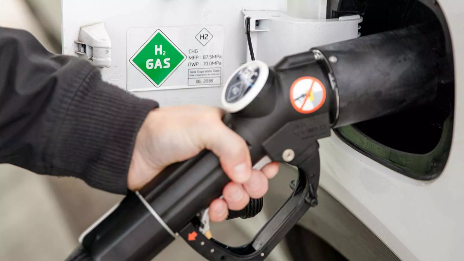

Running vehicles on green hydrogen
Local production of green hydrogen with the Fronius Solhub makes running your own fleet of zero-emissions H2 vehicles affordable and sustainableWhen the fuel cell vehicles convert the hydrogen into electricity and heat, the only by-product is water vapor.

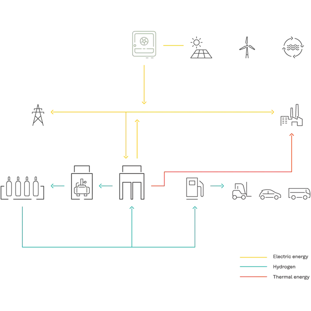

Fronius Solhub: How it works and the advantages As a system solution for producing, storing, distributing and reconverting green hydrogen from solar energy, the Fronius Solhub offers you many possibilities.
Green hydrogen Green hydrogen is produced from solar energy (alternatively wind energy or hydropower) by means of electrolysis.
1
Inverter
2
Compressor where the hydrogen is brought to the appropriate pressure level
3
Seasonal storage so that surplus hydrogen can be readily stored – and for longer periods of time
4
Reconvention + elektrolyseur If required, the green hydrogen is converted back into electricity and heat by means of a fuel cell.
5
Reuelling of H2 vehicles
6
Use of heat e.g. for low-temperature heating
7
1
Green hydrogen
2
Inverter
3
Compressor
4
Seasonal storage
5
6
7
Use of heat

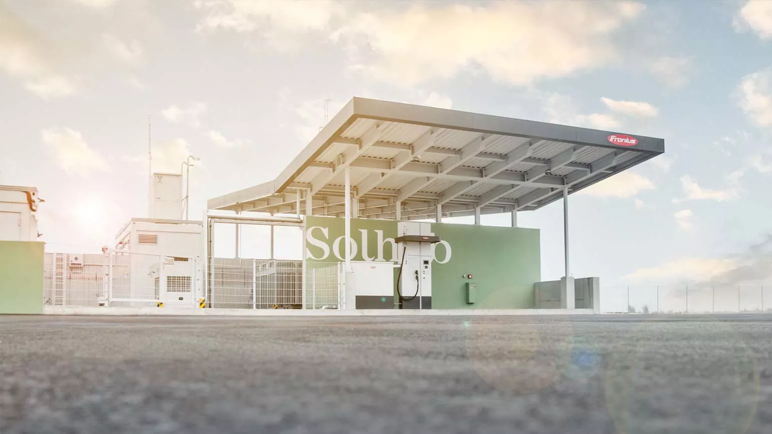

GREEN HYDROGEN CUSTOMER PLANT IN AUSTRIA
As a pioneer in the field of renewable energies, the first Solhub customer, SAN Group in Herzogenburg, will in future be using hydrogen as an energy carrier and produce up to 100 kg of green hydrogen a day with its own solar-powered plant.The ground-breaking ceremony for this pioneering project took place at the end of May in the presence of local politicians.
