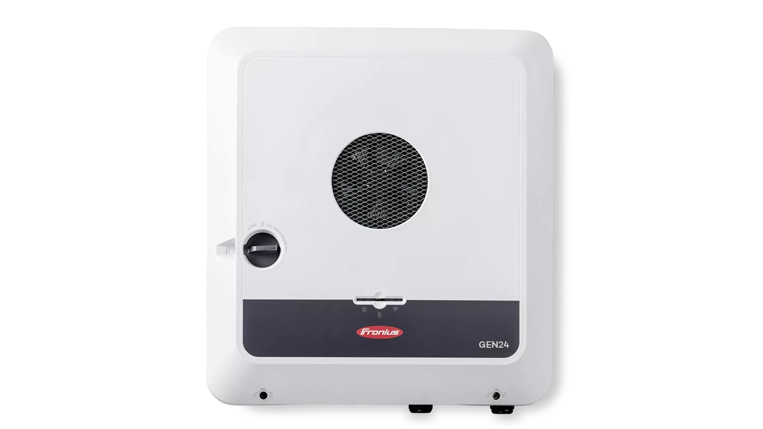

Fronius Primo GEN24 UL
Residential inverter with integrated backup power
Our single-phase inverter is the ideal heart of residential PV systems. The Fronius GEN24 combines smart solutions, intelligent software, and thoughtful engineering to achieve maximum yields.
With PV Point, the Fronius GEN24 offers an integrated basic backup power supply: Connected devices are supplied with backup power through a designated socket as long as the sun is shining.
With its diverse features, the Fronius GEN24 enables economic sustainability for long-term energy self-sufficiency. Discover the key advantages for installers and their customers:
