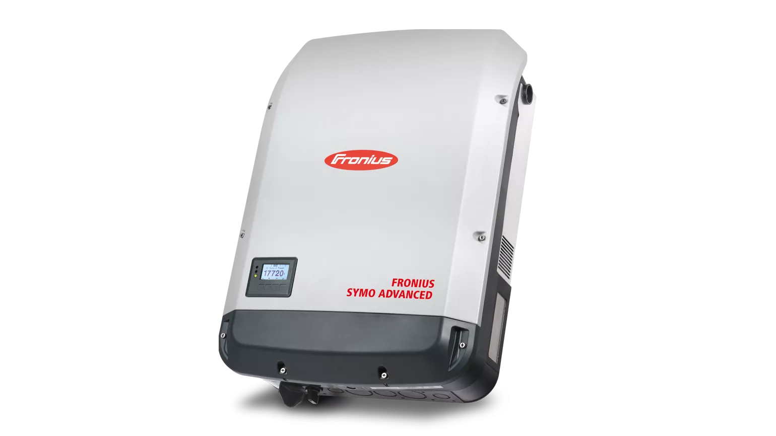

Fronius Symo Advanced UL
SPECIALLY DEVELOPED FOR THE REQUIREMENTS OF TOMORROW
Featuring models ranging from 10 kW to 24 kW, the Fronius Symo Advanced is the ideal inverter for commercial applications. The new Advanced versions combine the benefits of the Fronius Symo with additional features zero tilt mounting, light weight and field serviceability.
