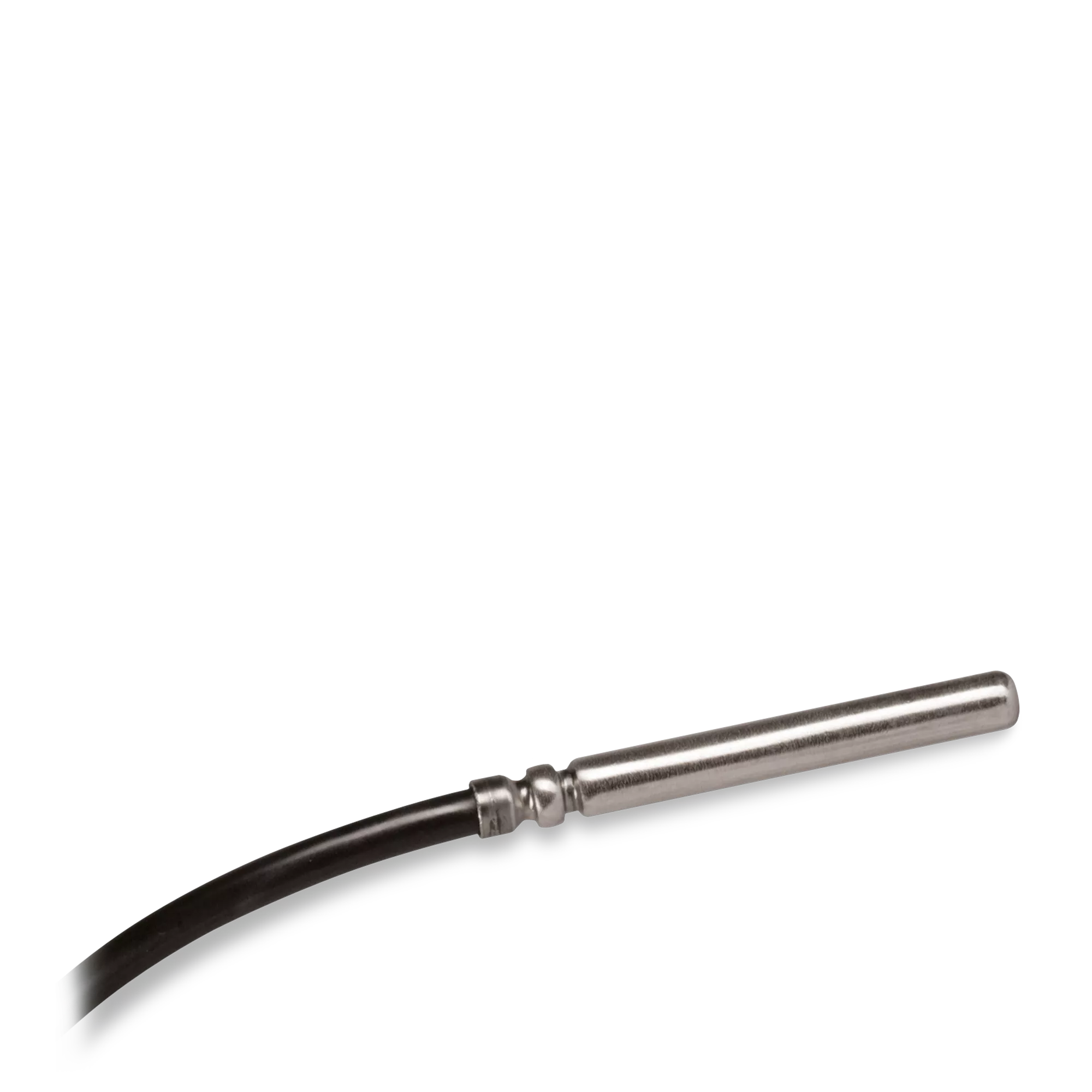

Integrating sensors into a PV system enables additional measured values, such as irradiation and ambient temperature, to mention just a couple, to be recorded.
This sensor is used to measure irradiated energy and is normally attached to the module frame.  Comparing the irradiated power to the inverter power provides a simple indicator as to whether the PV system is working properly.
