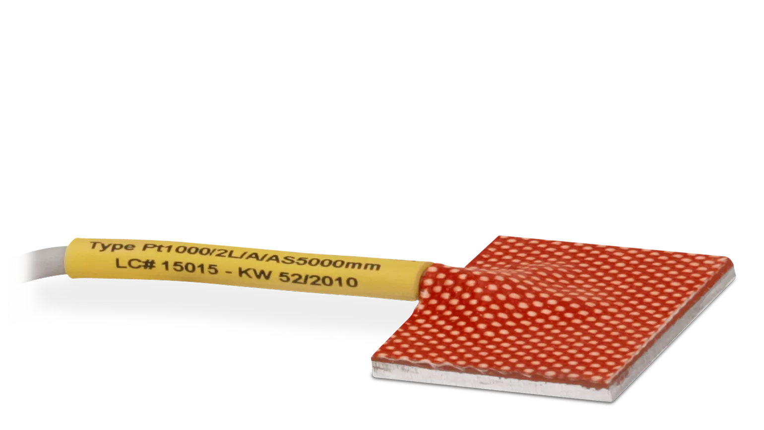

Integrating sensors into a PV system enables additional measured values, such as irradiation and ambient temperature, to mention just a couple, to be recorded.
This sensor is generally used for measuring the temperature of surfaces. The module temperature can be measured by fastening the sensor to the rear of the solar module. The temperature of a solar module plays a crucial role in determining its output. Monitoring the temperature allows estimates to be made on the nature of the output curve.
Technical Data
General Data
Length | 50 mm |
Sensor | PT1000 |
Measuring range | -20°C - +150°C |
Tolerance | ±0.8°C (from -20°C to +100°C) |
Design | Self-adhesive sensor for measurements on surfaces, two-wire technology |
Connection cable | 3 m Cu cable, silicone-insulated, exposed ends, ferrules, UV-resistant |
Max. cable length (distance: Sensor Card/Box to sensor) | 3 m |
