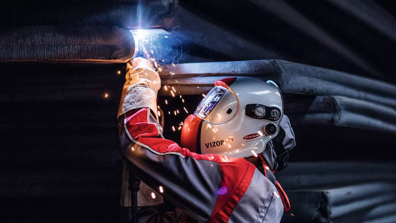

Fronius is developing VizorConnect together with OPTREL AG , a supplier of active anti-glare products. The welding helmet communicates with the power source via Bluetooth, leading to significant improvements in workplace safety – and establishing the foundations for future functions. Peter Eicher, Chief Sales Officer and Member of the Executive Board at OPTREL, explains in an interview the demands that protective equipment must satisfy and highlights the advantages of the new welding helmet.
Overhead welding with the welding helmet of the future

Current trends in development are clearly heading towards increased comfort and efficiency, as a welder’s job description is going to change in future. Metal constructions are being designed to be thinner and thinner in order to support efficient and cost-effective manufacturing processes. This increases the pressure on the quality of the weld seam. Only those who have perfect vision during and after welding will be able to provide the required results in terms of time and quality. The intelligent VizorConnect welding helmet that we developed together with Fronius is a completely new solution. It is the first helmet that automatically connects and communicates with the power source via Bluetooth. When the welder activates the arc ignition on the welding torch, the helmet is sent a signal to darken its visor. Even before the arc is actually ignited, the eye protection switches from open to closed mode. This has many advantages. It eliminates the bright flash at the start of the welding process, which drastically reduces fatigue. Reliable glare shield operation is always guaranteed, even at the lowest welding currents and with bright lighting in the workplace. Accidental darkening of the helmet, for example due to a neighbouring arc or sudden opening when welding out of position, is now a thing of the past.
Do you have a vision for the perfect welding helmet of the future? If yes, what features would it have? Is there anything missing from current welding helmets that is not yet technologically possible?
In future, welding helmets will be able to do far more than just protect. They will be intelligent enough to integrate seamlessly into production processes and to simply “be there”, almost unnoticed. Furthermore, metalworkers of the future will also need to have an eye on numerous parameters during the joining process. What could be closer to this requirement than having this information directly superimposed on the welder’s field of vision? With our VizorConnect welding helmet, we have taken the first steps in this direction. It fulfils all the prerequisites of being able to display various welding parameters or other information on the visor, meaning it is equipped for many future functions.
