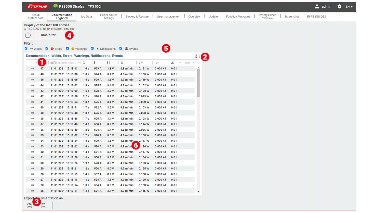

    Functions

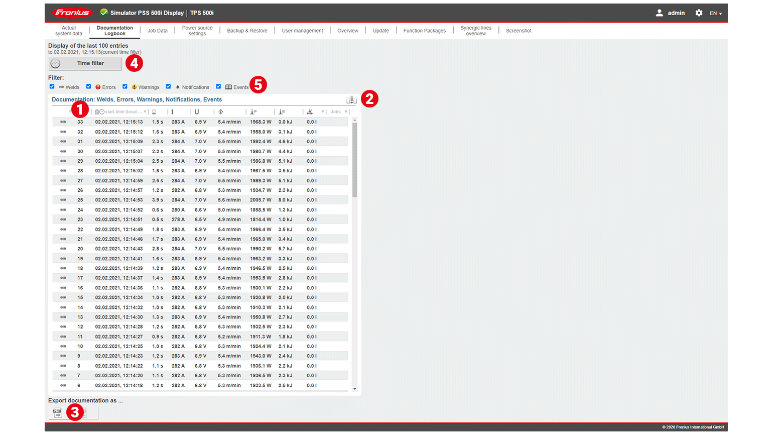

    Data documentation
    1. Mean values of every weld seam are recorded: time, duration, current, voltage, wire speed, power.
    2. Add columns
    3. PDF export
    4. Restrict results using time filters
    5. Filters for welding operations, faults, and events

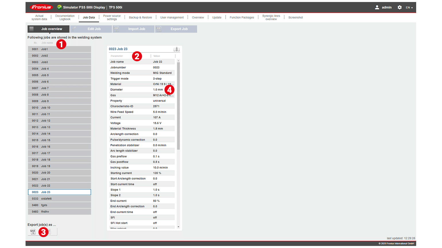

    View jobs
    1. Display of stored jobs
    2. All parameters of a selected job are shown.
    3. PDF export
    4. Comparison of jobs: differences are highlighted in red

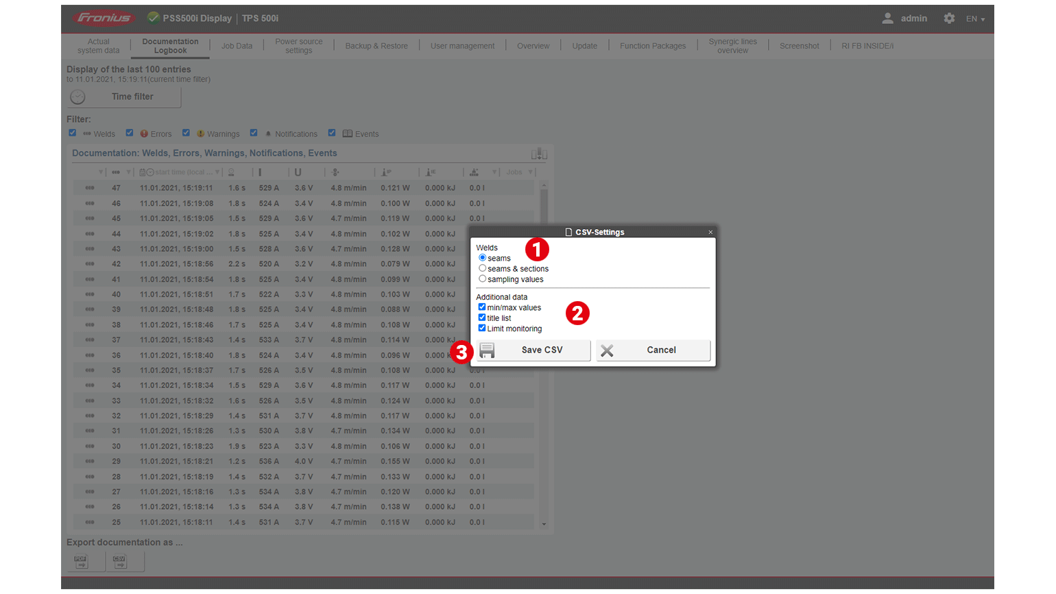

    Possibility of export via CSV
    1. Ability to export weld seam data (average value or sampling rate based)
    2. Additional parameters can be exported if needed
    3. Save CSV files
    Enlarge screenshot

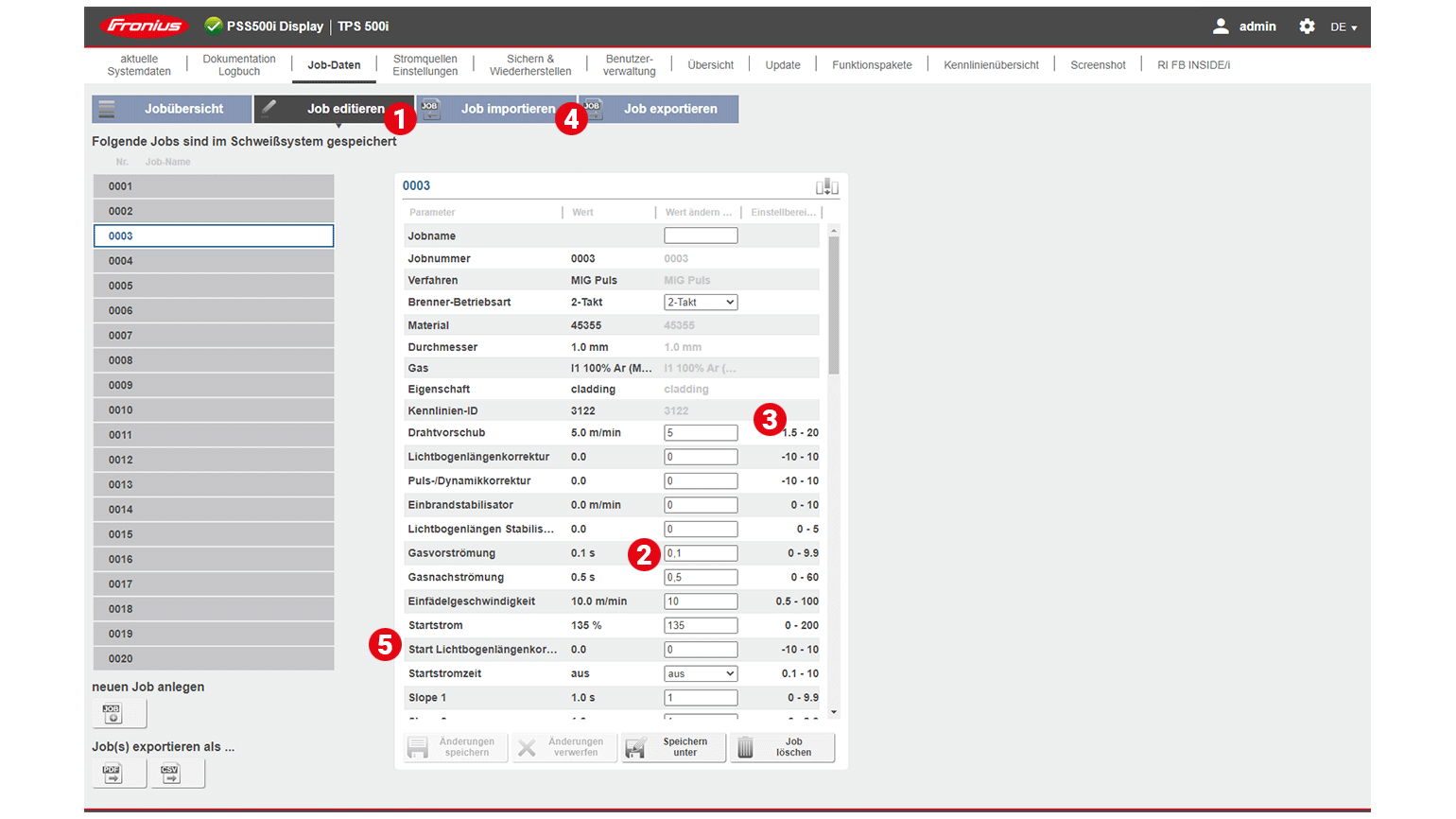

    Edit jobs
    1. Edit jobs
    2. Values can be directly changed
    3. Display of possible adjustment range
    4. Jobs can be exported and imported on other devices
    5. Upper and lower limit values can be set for the basic parameters (A, V, Vd)
    Enlarge screenshot

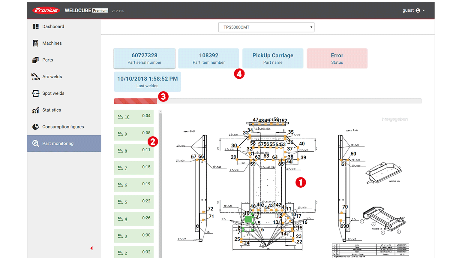

    Workpiece monitoring in real-time
    1. Traffic light system for every weld seam with position
         Yellow = Not yet welded
         Red = Faulty due to limit violation
         Green = Correct
    2. Details on every weld seam directly accessible
    3. Status bar displaying component progress
    4. Information on component
    Enlarge screenshot

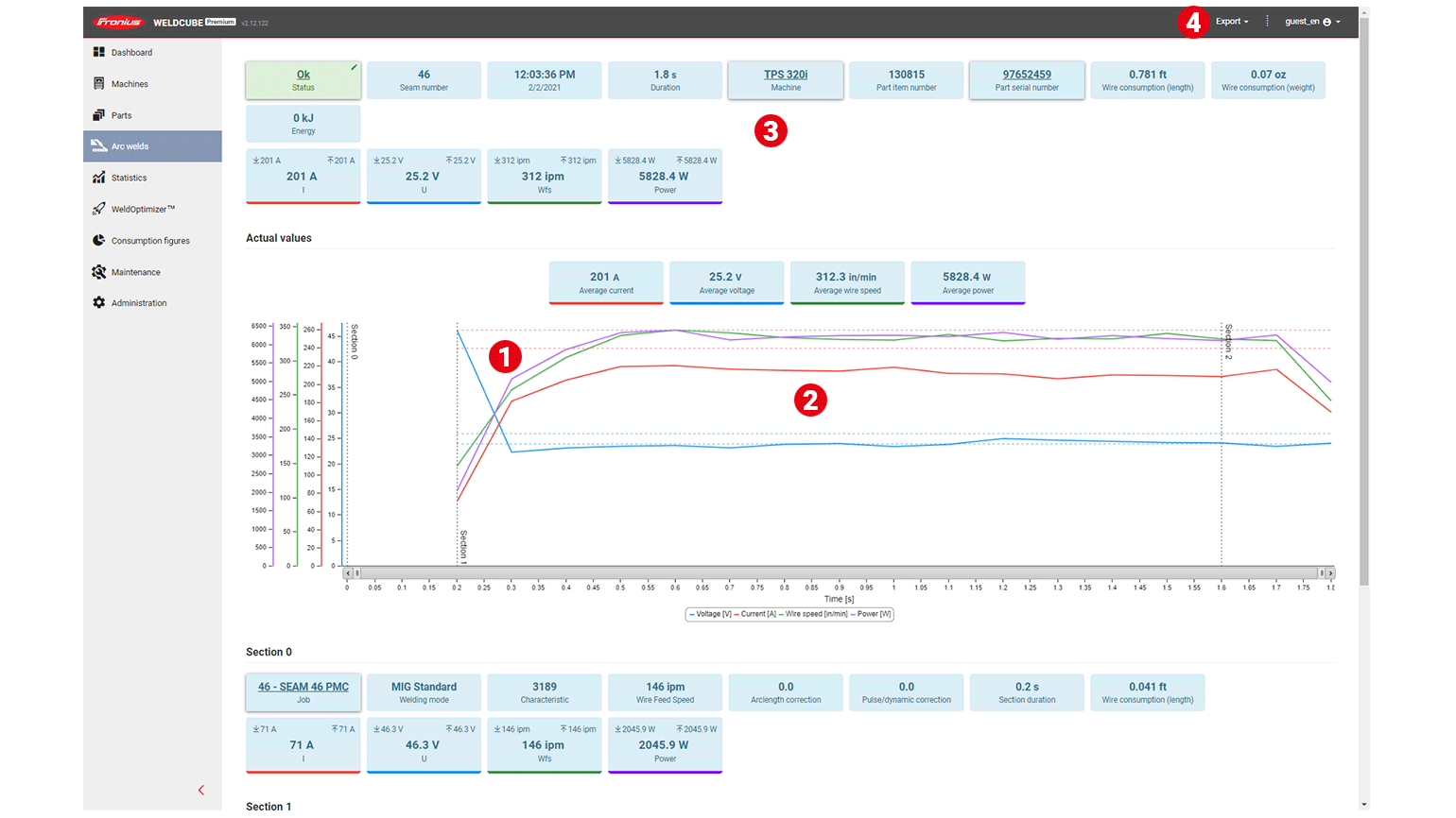

    1. Actual data at selected time
    2. Overview of actual data across the entire weld seam
    3. All information on selected weld seam
    4. PDF export with all data on selected weld seam

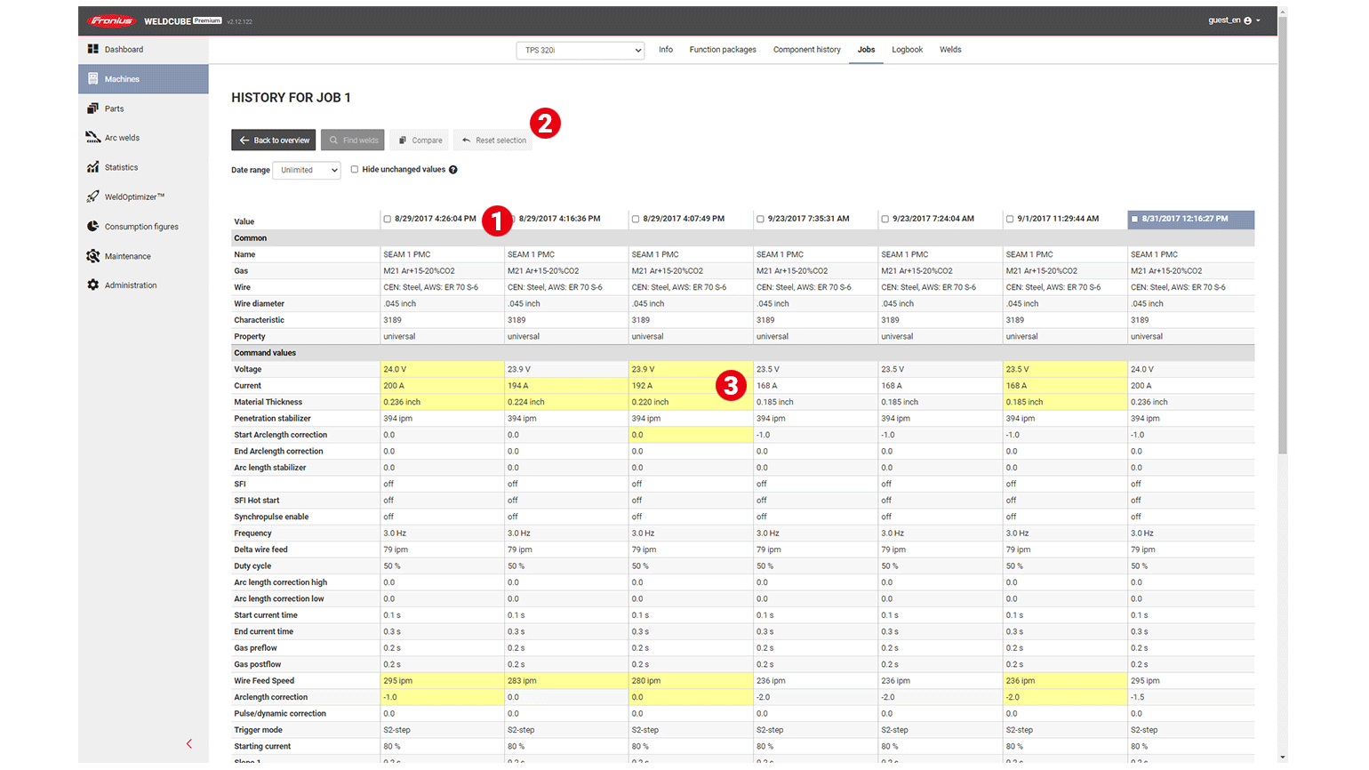

    Job-history
    1. Every change in the job is traceable down to the finest detail
    2. The selected job can be restored at the click of a button
    3. Changes in the job are highlighted
    Enlarge screenshot

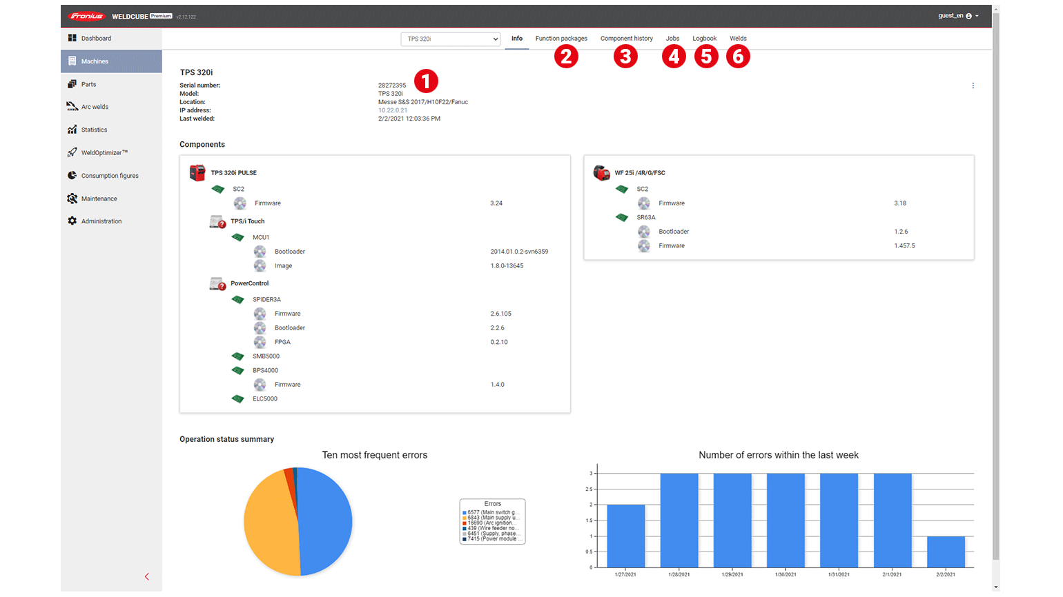

    All information of the welding machines
    1. Information on selected welding system with direct link to device
    2. Overview of available and installed function packages
    3. History of installed hardware
    4. All jobs on the selected welding system can be edited and distributed to other devices
    5. Error messages are saved in the log book
    6. Access to all weld seams produced by this device
    Enlarge screenshot

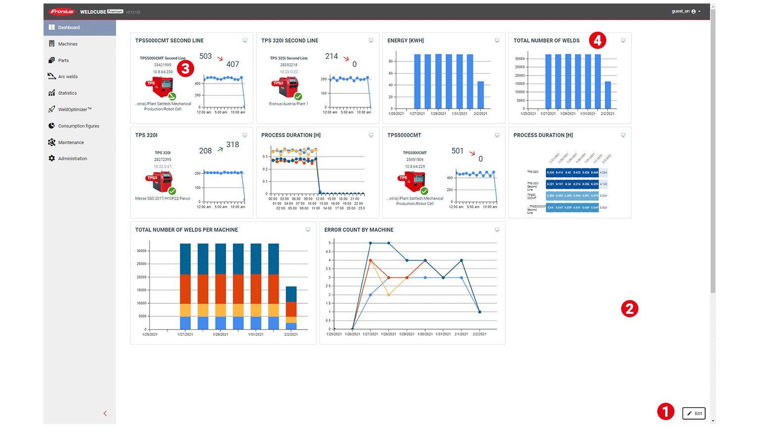

    Customizable dashboard
    1. Customizable dashboard
    2. Widgets can be placed on the screen
    3. Status of welding system
    4. Statistics on the total number of welding operations performed
    Enlarge screenshot
