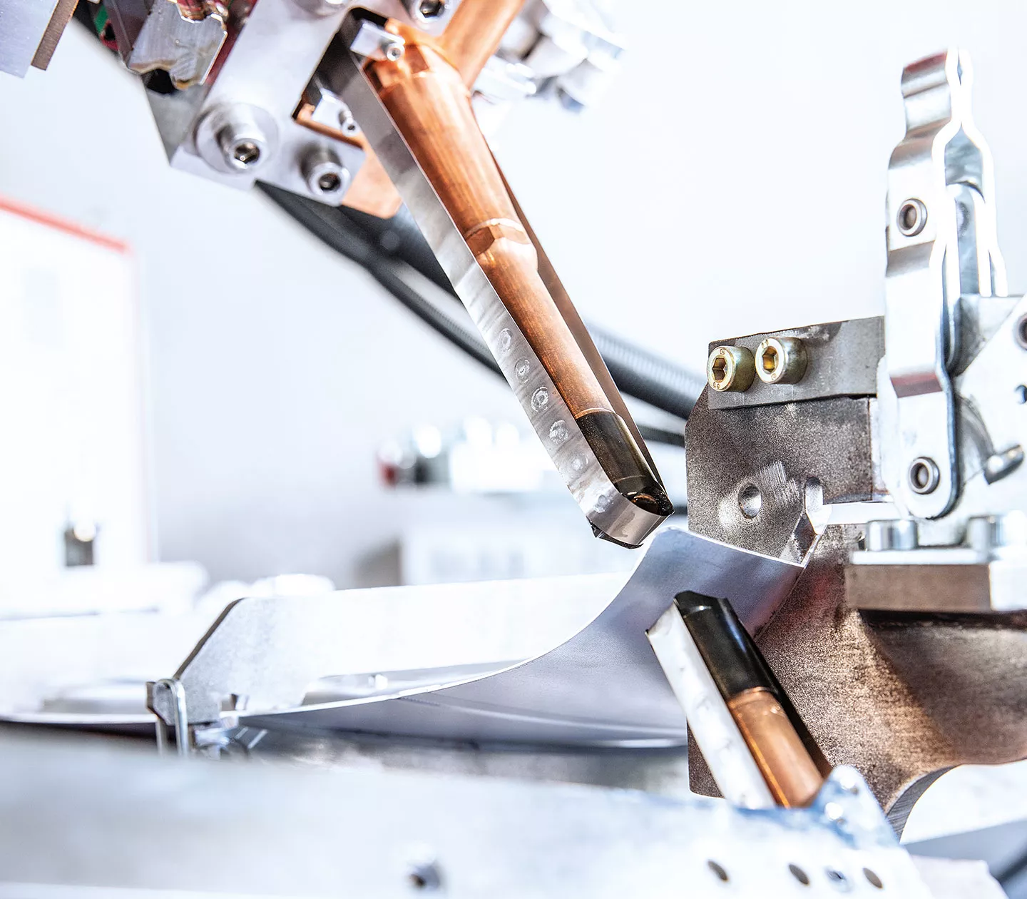

Perfect welding results “spot by spot”. There’s simply no other way to describe the DeltaSpot system from Fronius Perfect Welding. The resistance spot welding process is not only suitable for aluminum and steel, but also for other materials, and is mainly used for demanding sheet metal joints. The continuous process tape, which runs between the electrodes and the sheets to be joined, is the system’s most characteristic feature. Its constant movement results in a continuous welding process of consistently high quality. The outcome: Precise and reproducible welding results.
The process tape transmits the welding current and protects the contact surfaces of the electrodes from contamination. This significantly increases the service life of the electrodes, making up to 20,000 welds possible (depending on the application). Each welding spot is 100 percent reproducible, allowing users to benefit from the high process reliability. Since there is no direct contact between the electrode and the metal sheet, the welding spots are spatter-free, and the time-consuming re-milling of the electrodes is no longer necessary. Up to 7,000 spots can be welded without interruption with a single process tape.
Due to the high electrical resistance of the process tape, additional heat is conducted from the outside to the inside during the welding process. In aluminum applications, in particular, this means that up to 50 percent less energy is required – making the process very efficient. In addition to aluminum compounds, DeltaSpot can also be used to join titanium, magnesium, stainless steel, coated steel plates, and high-strength steels. Multi-plate joins are also possible without any problems. The user can simply swap the process tape in order to process a different material composition with the same spot welding gun. This makes DeltaSpot a versatile resistance spot welding system with clear process advantages in numerous applications

The continuous process tape of DeltaSpot ensures that each welding spot is absolutely precise and reproducible.
