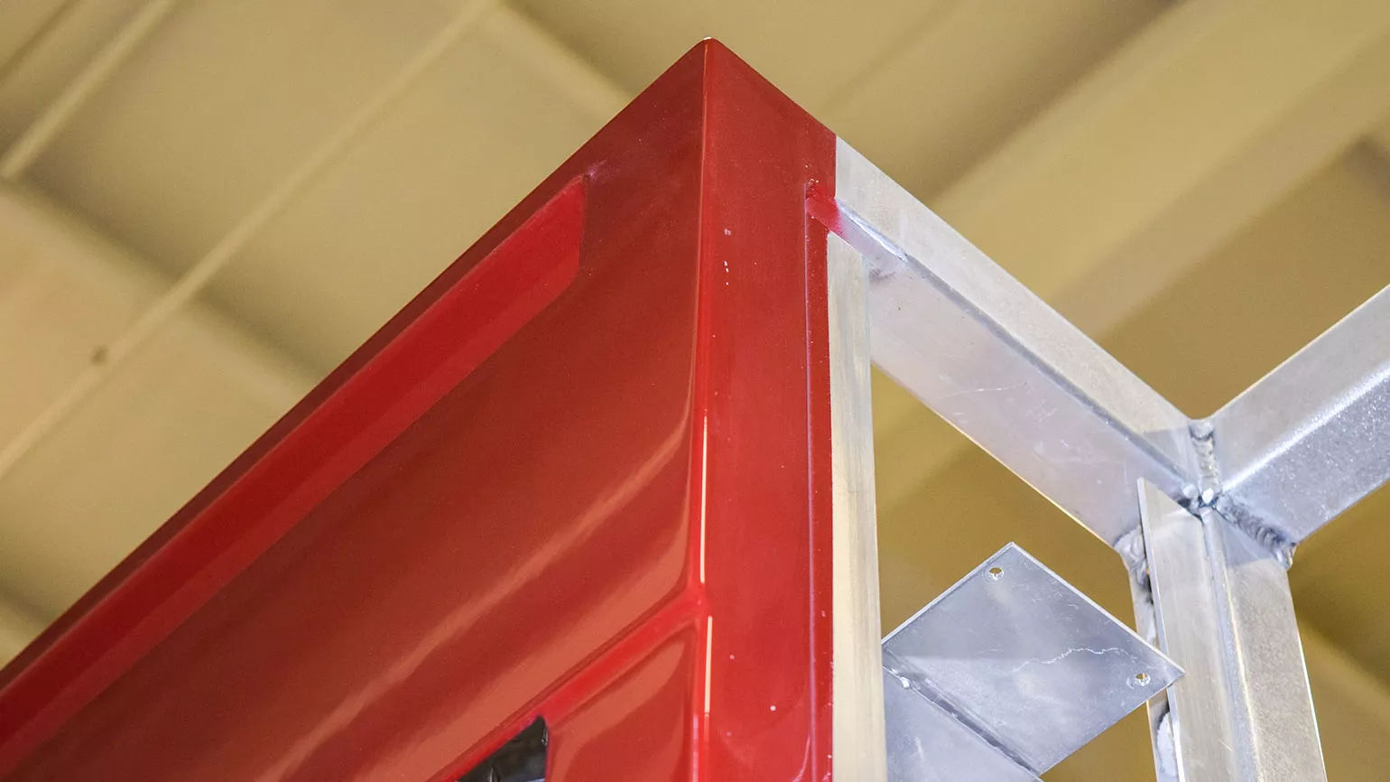

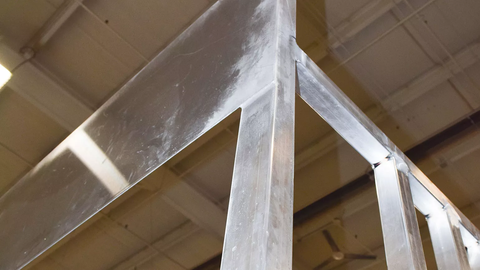

Beginning with a 3-D digital model, the frame is configured to the proper specification. Each piece of extruded aluminum tubing is cut and welded in-house. Next, the sidewalls are attached. This step presents the weld radius that has caused so much time in rework: where the sidewalls attach to the frame. On a flat surface, any pits in the weld could be filled in and painted over but, here, any type of filler would flake off with usage and weather. This edge has to be solid metal.
With the MIG equipment Spencer previously used, the actual welding took only minutes compared to the hours of grinding, routering and sanding to get a solid, paintable corner. “One truck, two walls, used to take 16 hours,” said Grant Spencer, head of the company.
Even with all this work, the company wasn’t highly confident about each of those welds. With the Fronius TPS 320i Compact welding system, however, Spencer has been able to reduce the time on this one application by 75 percent.

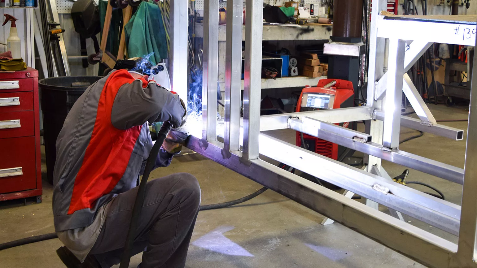

Spencer Manufacturing began working with the TPS 320i Compact just a few months ago. For this application the company is using primarily Synchropulse, a pulsed gas metal arc welding (GMAW) process.

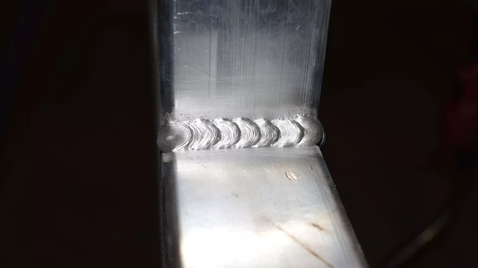

The most significant time savings was in the reduction of rework. The TPS/i has spatter-free ignition and an intelligent arc that adjusts during welding according to set parameters. Overall there is less spatter, proper penetration and a good bead profile. The resulting seam is solid and requires little to prep for primer and paint. “With the new process, we can do both walls in four hours,” Grant pointed out.
Another advantage came from the smart design of on-torch controls. Spencer found these to be incredibly helpful when moving in and out of the framework. “With competing weld systems you have to move around to see your machine. Having the controls right on the torch saves time. No need to look at or mess with the machine.” The on-torch controls give the user the ability to change weld settings such as hot start, tac and crater fill. These features are especially handy for welding aluminum in order to get through the oxide layer and end the bead cleanly. The Fronius TPS/i also offers assistance to novice welders by using waveform control to make the process easier. This concept makes the welding system more versatile, allowing one machine to weld aluminum, steel or any other metal.
