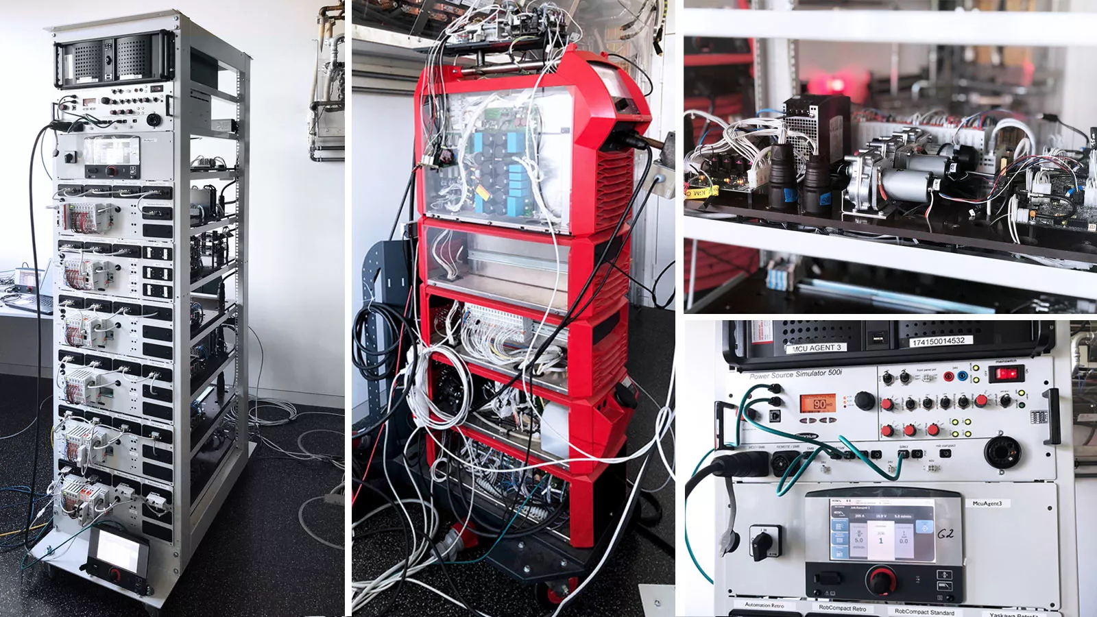

AUTOMATED TESTS 24/7
Before delivery, all Fronius welding systems undergo comprehensive tests – at hardware and software level. Automatic stability tests, for example, are taking place on different systems in the Fronius research department 24/7. Simulation boxes are used to carry out realistic welding processes, and the results are saved to servers and analyzed.
The automatic tests help Fronius developers to design increasingly complex software that is safe, reliable, and user-friendly. “Ensuring our products are tested in line with how they will ultimately be used by the customer is important,” explains Allerstorfer. “The manual tests are therefore just as important as the automatic ones. They make it easier to grade the quality, as you are working directly with the product.” This is the only way that specialists can find out whether operation and functionality are in line with the user’s needs, and whether the Fronius welding system can be delivered to the customer with a clear conscience.

We derive different test cases based on customer requirements, and try to cover every conceivable scenario. But because there are so many, we automate them, so that we have to spend as little time as possible carrying out tests.
