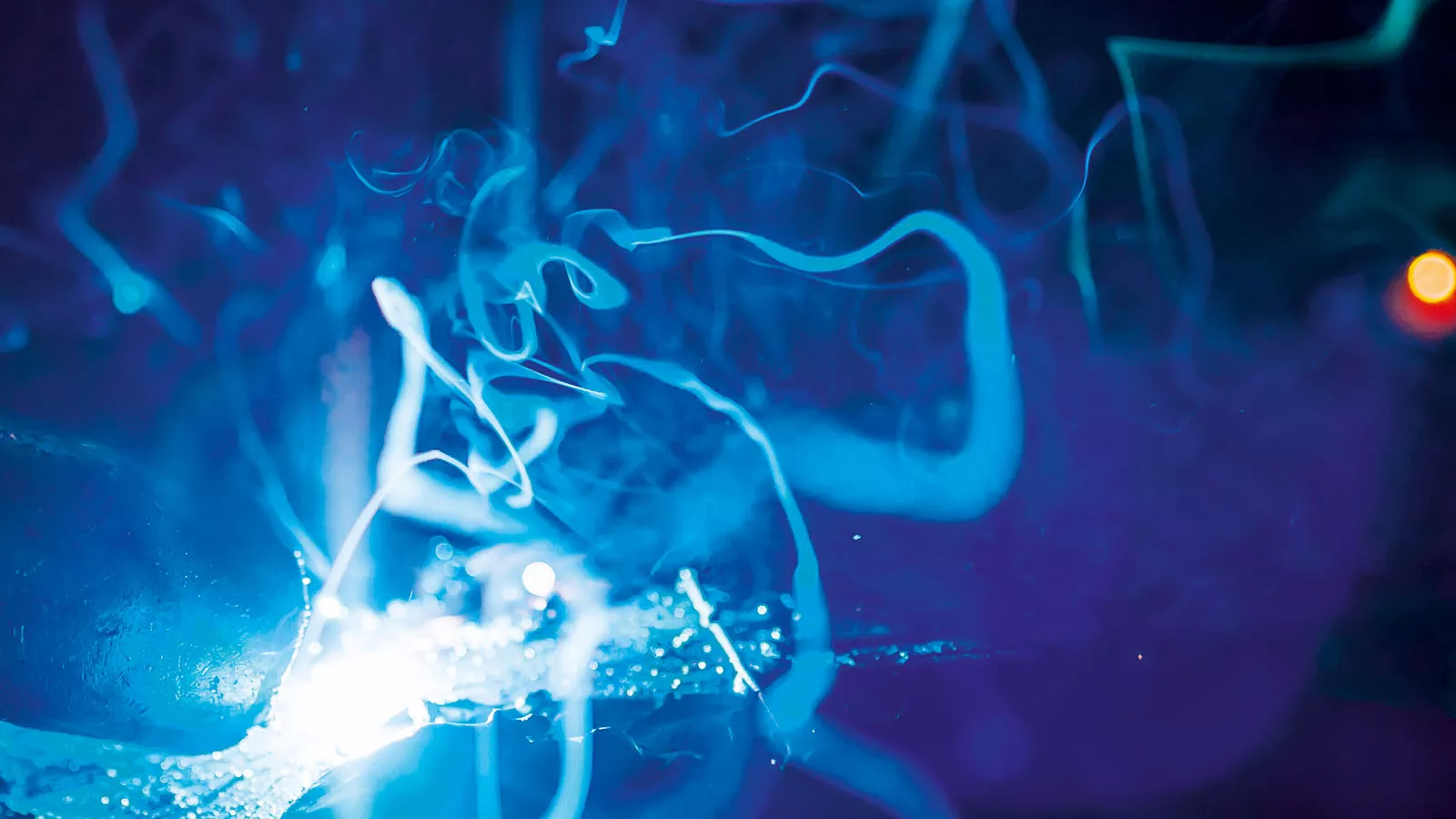

The International Agency for Research on Cancer (IARC) has recently published Monograph 118. Welding fumes are included here as a Group 1 carcinogen – a topic which has elicited discussion and concern in manufacturing industries. Fronius was keen to look at this area more closely. With this in mind, Geoff Melton , Chair of the Occupational Health and Safety Committee at the International Institute of Welding (IIW) and expert in arc welding processes was invited for an interview.

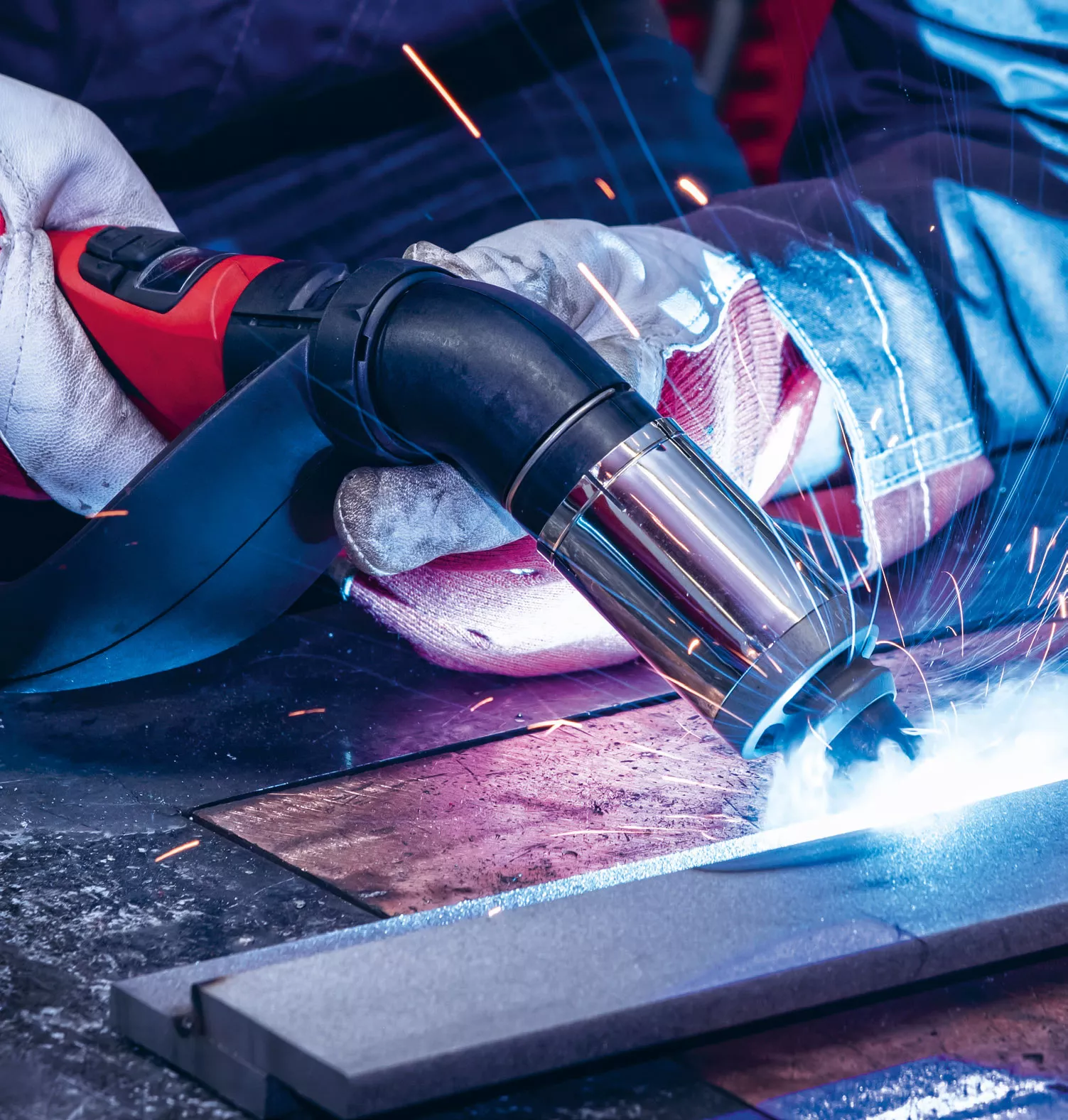

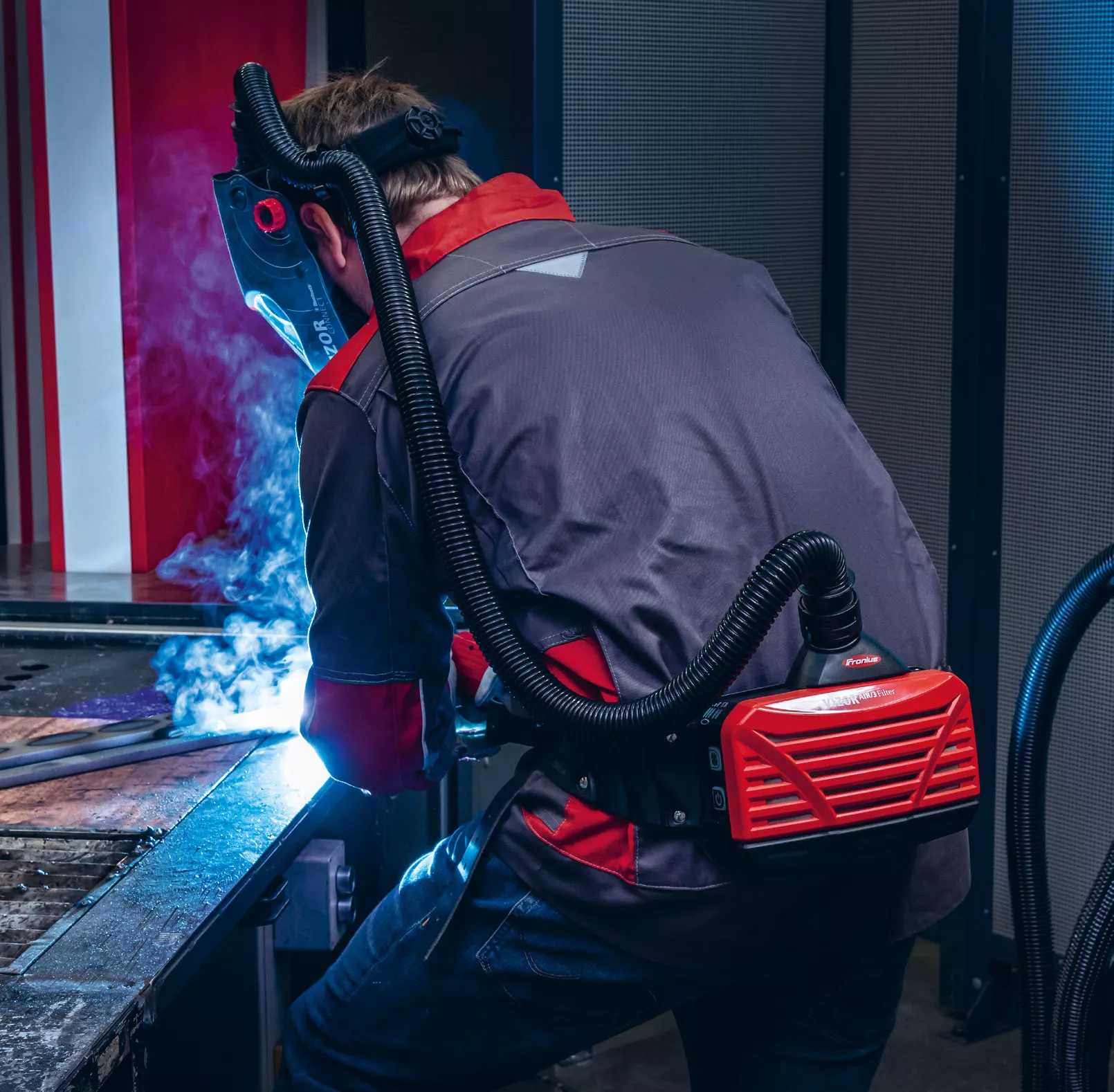

Nevertheless, welding fumes will always be unavoidable to a certain degree. For this reason, we offer a wide range of products such as welding helmets with a fresh air supply and fume extraction torches. However, not everybody uses them. Why do you think this is the case?
I think that fume extraction torches have a bad reputation, so companies do not see them as a viable method to control welding fume. There are concerns that they disturb the shielding gas, leading to poor quality welds, and the original designs were heavy and bulky. Manufacturers such as Fronius need to convince their customers that the new generation of extraction torches are a good alternative to local exhaust ventilation (LEV).

Our company is already well-positioned in terms of robotic welding systems and automation. Nevertheless, there are still many manual welders around the world, and this will surely continue to be the case. What can we do to protect these People?
The most important thing is to raise awareness among welders about the hazards they face. We need to be more involved at the training stage and the trainer needs to inform participants about any risks as effectively as possible. This is the best way to reach young welders and ensure that health and safety measures are implemented in both theory and in practice.
My personal feeling is that welders are actually quite knowledgeable about the subject. Young welders are already recognizing the hazards and insisting on appropriate safety measures. For Fronius as a manufacturer, apart from producing improved fume control methods, there is still the need to refine welding processes to produce less fume at source.
