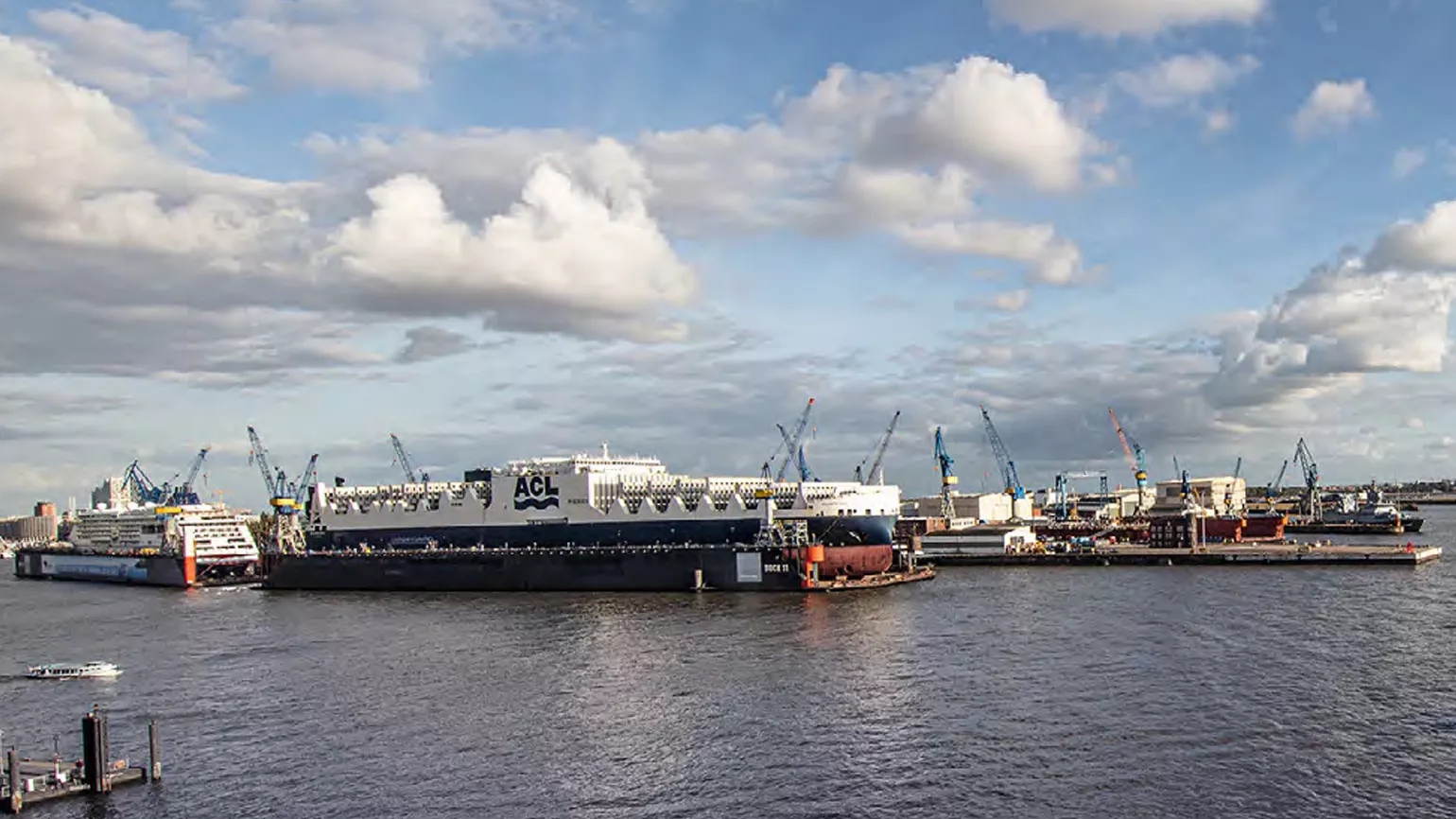

The Port of Hamburg is a world-famous landmark of the Hanseatic city, as well as its gateway to the world. It is also home to Blohm+Voss, which has been a cornerstone of Hamburg since it was founded in 1877. The company has shaped the appearance of the docks south of the Elbe tunnel from St. Pauli and continues to do so today – from the venerable administration buildings and huge cranes to the enormous workshops and docks, which regularly house the largest passenger and cargo ships in the world.
In 2016, Lürssen, a family-run business from Bremen, took over Blohm+Voss, which currently employs over 600 people. The company not only specializes in shipbuilding but also repairs, refits and maintenance – everything from yachts and merchant ships to giant international cruise liners. “Around 25 to 30 ships come to our docks each year,” explains Herbert Lembcke, welding engineer at Blohm+Voss.
Time in dock costs money
The largest dock is around 350 meters in length, making it large enough to accommodate the cruise liners that arrive for maintenance and repairs: “The time pressure is particularly high,” describes Lembcke. “Each day that a vessel spends on dry land costs the shipowner a huge amount of money. Yachts can stay docked for longer, but cruise ships often have to be up and running again within a few days.” Operations in the shipyard are therefore meticulously planned.

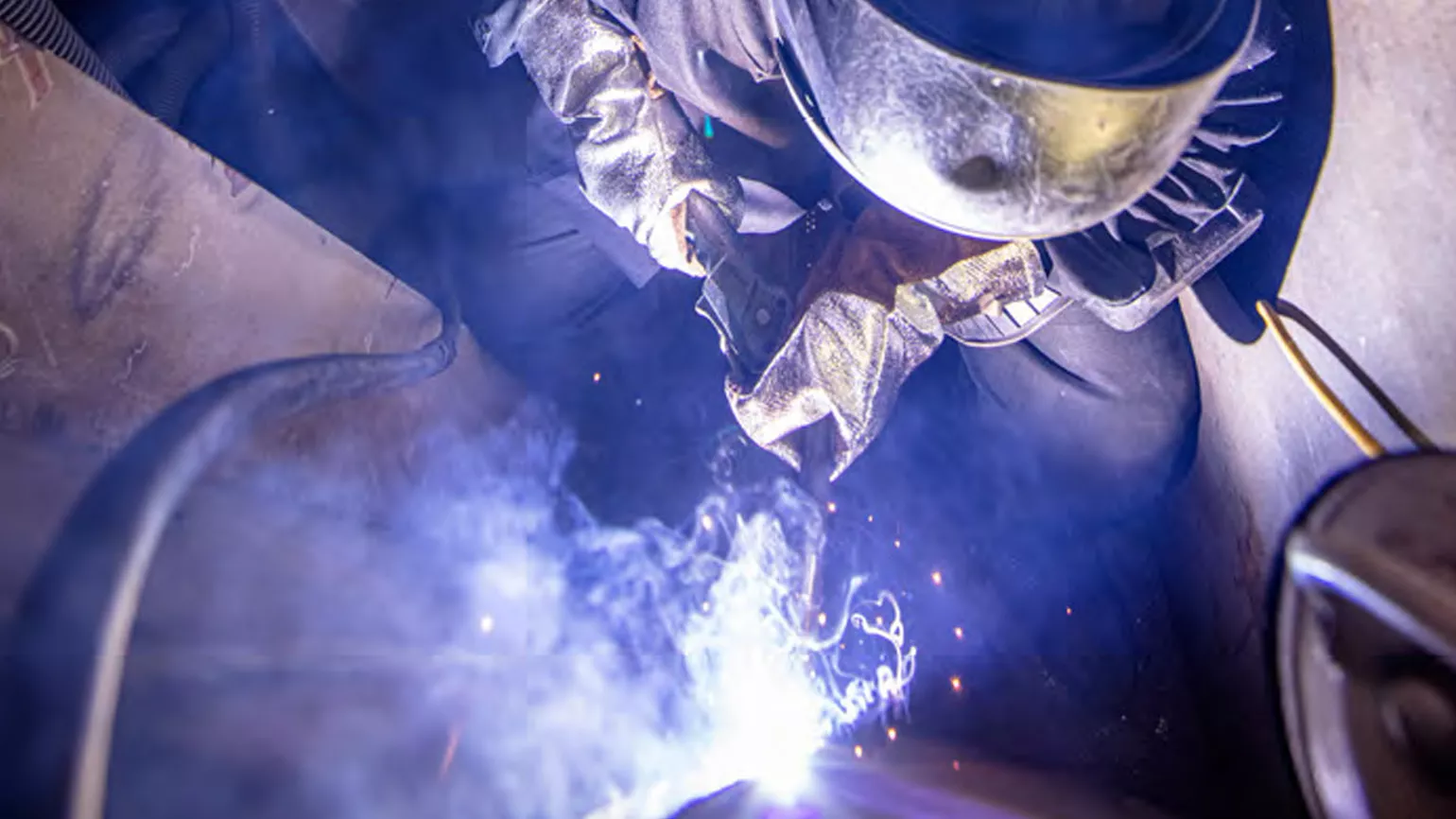

Welding is a fundamental part of ship repair and so welders have around 700 different power sources at their disposal: “We primarily deal with steel applications but also with aluminum and other metals in all material thicknesses,” explains Lembcke. “The majority of work is performed manually, as the procedures are often too specialist to make automation worthwhile.”
Strict verification for welding processes
Flux-cored wire welding is by far the most commonly used welding process at Blohm+Voss, but the ship construction specialists also use electrode, submerged arc, and TIG welding. “The robustness of the joint is always the most important factor,” stresses Lembcke. “It is vital that the weld seams are thick and are able to hold - everything else is secondary.” Since the safety of the crew and passengers is of the upmost importance on ships, all work is rigorously checked. In the case of the weld seams on underwater sections of the outer hull, these checks are conducted partly with the help of vacuum or ultrasound tools. “We are also liable for the basic verification of the devices and processes that are used – both our welding certifications and the entire shipyard are audited every three years,” explains the welding engineer.
Work on tanks, supporting constructions, interior fixtures, rudders, and propellers is also commonplace, which makes for the most diverse welding challenges: “Sometimes these can involve very thick materials of up to 100 millimeters or more that have to be joined,” explains Lembcke. “Besides that, we frequently encounter restricted spaces and high temperatures. Our employees must also weld under tough conditions at times.” To prevent exposure to welding fumes, the welders wear helmets with a built-in air filtration system. “On top of that, we also have tight time pressures to contend with. For this reason, we need welding systems that are effective, safe, and error-free.”
