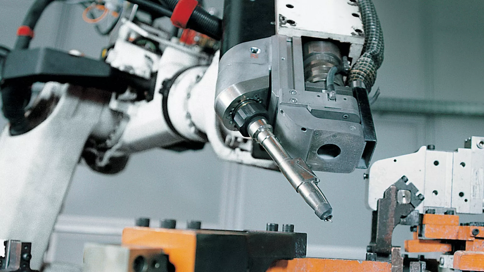

LaserHybrid Welding Head, Fronius

Fronius LaserHybrid welding combines the laser welding process with the MIG welding process. It exploits the advantages of each process to the full to create synergies. The high welding speed and concentrated energy of the laser can be effectively combined with the MIG arc in two ways: either through maximum welding speed when joining light-gauge sheets, or maximum penetration on thicker materials.
HOW LASERHYBRID WELDING WORKS
As soon as the laser beam hits the surface of the workpiece, it heats up this spot to vaporisation temperature, resulting in deep, narrow penetration. In the LaserHybrid process, the use of expensive laser energy is limited almost exclusively to this deep-weld effect, which also permits thicker sheets to be joined. The remaining energy requirement is met by the cheaper MIG/MAG process, which exhibits an improved gap-bridging ability due to the consumable electrode. As both processes focus their energy on the same process zone, the weld depth and speed are significantly increased compared to the individual processes.
