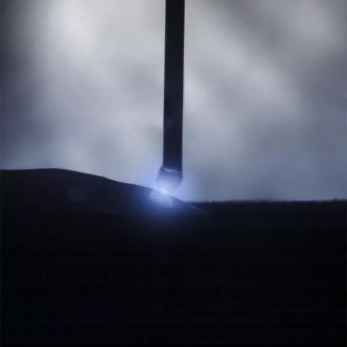

DIP TRANSFER ARC PROCESS: EXTREMELY LOW-SPATTER AND STABLE
With the LSC process, Fronius has developed a modified dip transfer arc with extremely high arc stability. The user can achieve high-quality weld seams with minimal spattering and an increased deposition rate, as the LSC principle is based on the short circuit occurring at a low current level. This leads to soft reignition and a stable welding process; a significant contrast to the standard dip transfer arc. Control over the arc has been improved significantly thanks to the development of the TPS/i power source platform. The TPS/i recognises the process phases occurring during the short circuit extremely quickly and reacts to them. The user can therefore achieve outstanding results in conjunction with the new stabilizers.
