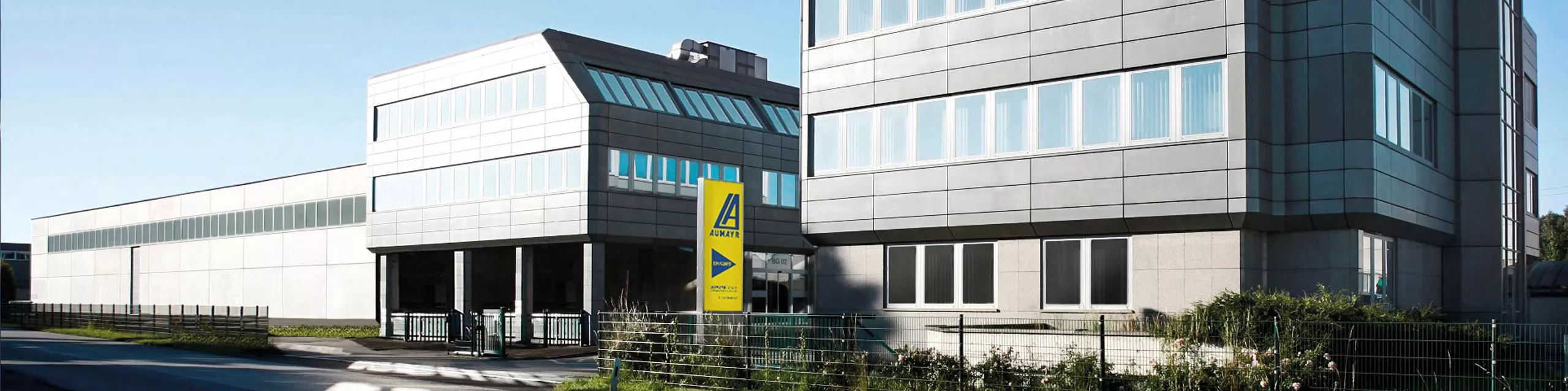

Three hundred employees at three different sites in Austria and the Czech Republic: Aumayr GmbH, based in Steyregg near Linz, manufactures ventilation pipe systems tailored to the customer’s specifications. Large prestigious projects, such as their work on the Landestheater Linz [Linz State Theater] – the most state-of-the-art music theater in Europe – show just what Aumayr can do: they manufactured 1,000 running meters of ventilation pipe components for the project!

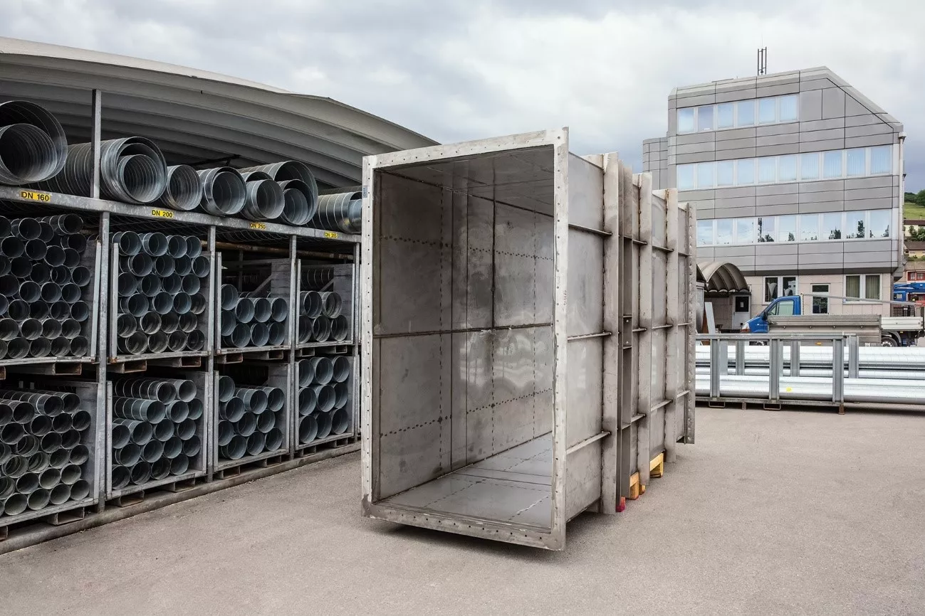

Welded stainless steel air ducts

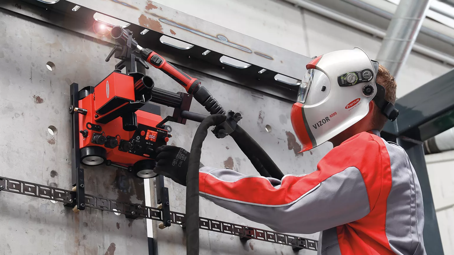

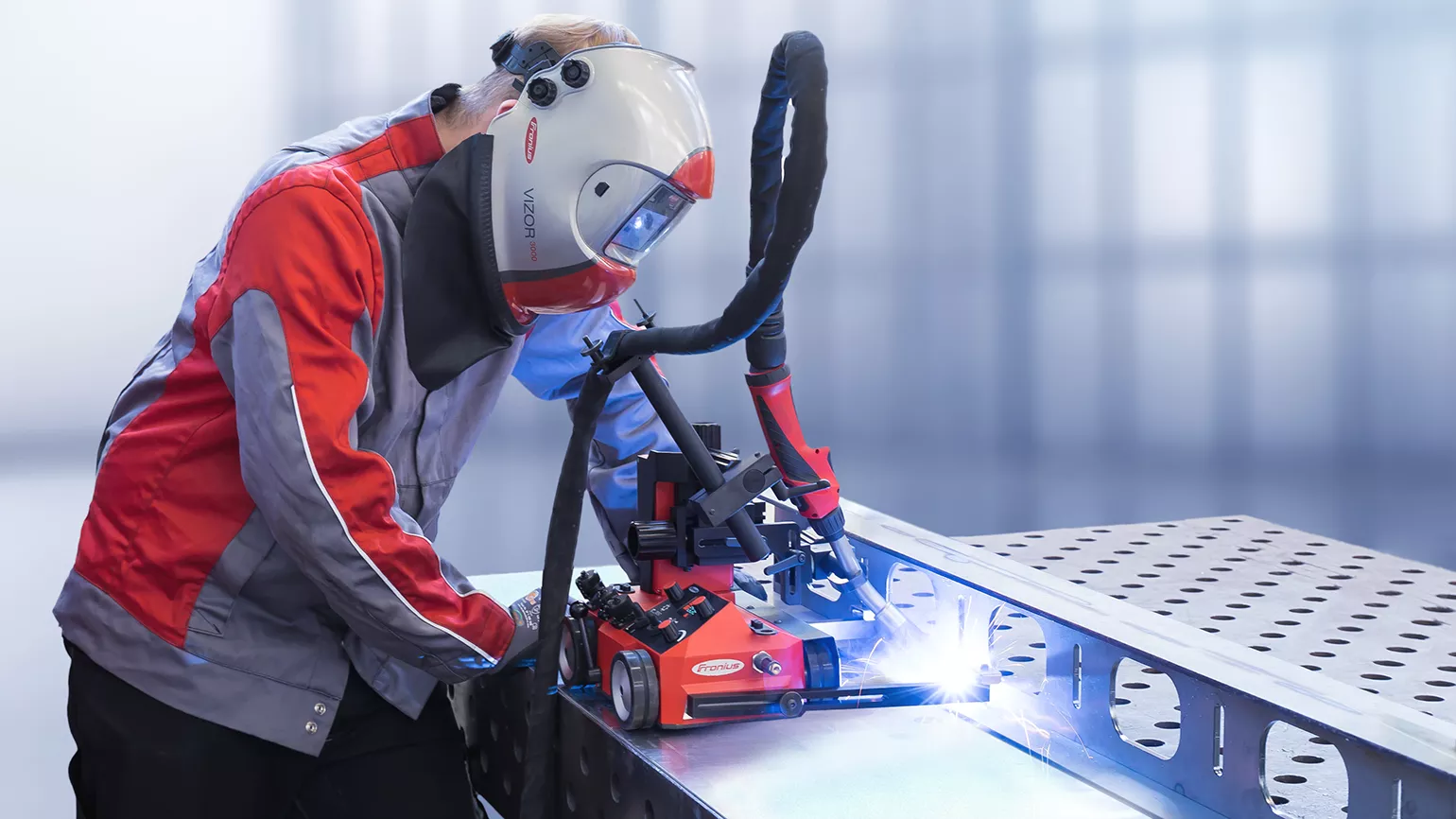

At the beginning of 2018, the company received a large order for welded stainless steel ventilation pipes – Aumayr GmbH anticipated a number of significant challenges: the project involved creating several kilometers of weld seams. Sheet metal thicknesses up to four millimeters needed to be welded without warping and with a consistently high quality. It quickly became clear that this project would push manual welding to its limits. The only way to ensure the cost effectiveness of the project was to use a mechanized welding process.
Increasing welding speeds and eliminating the need for rework were therefore essential in order to optimize costs. In addition, the company was also looking for systems that were compatible with their existing Fronius welding systems so that these systems could continue to be used.
Solution
Stock

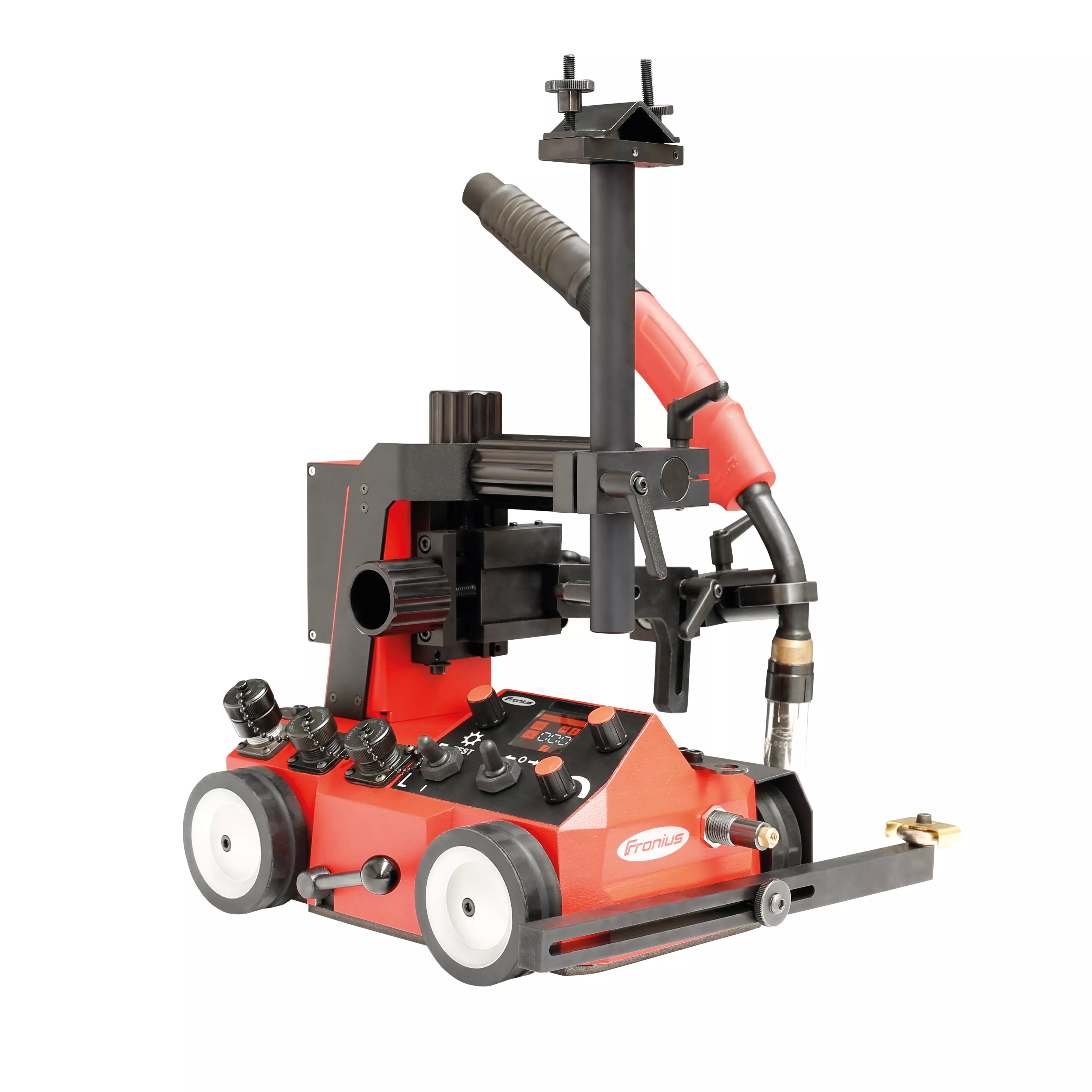

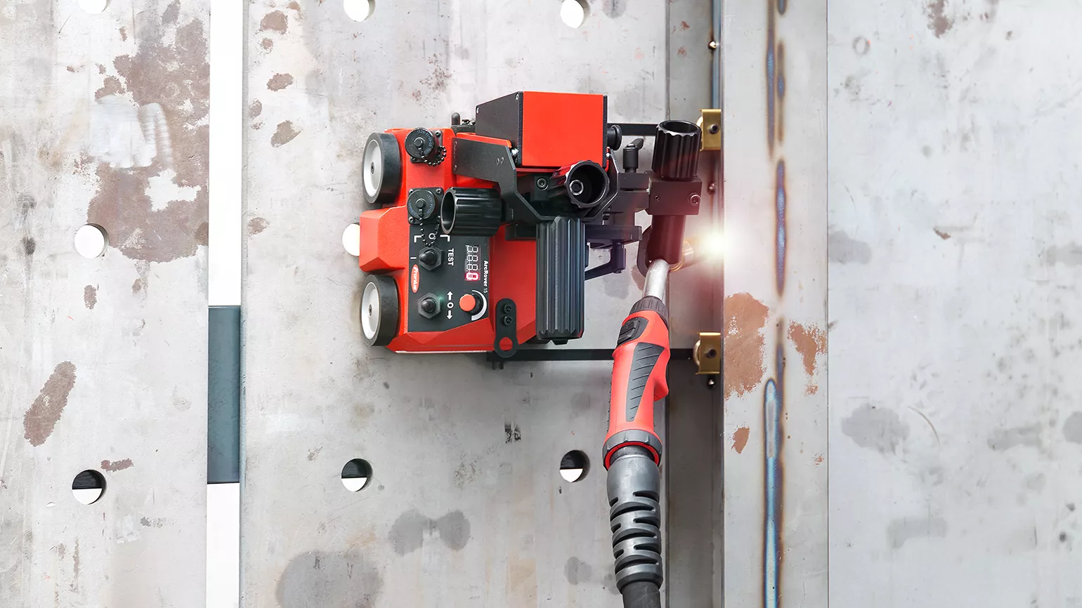

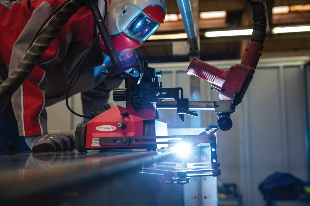

The ArcRover 22. Aumayr chose this exceptionally robust and equally flexible Fronius welding carriage, not least because of the fact that it could be used in combination with their existing Fronius TPS 5000 CMT and TPS/i 500 welding systems. The compact welding carriage and its ease of use helped to completely convince the Aumayr specialists. Using this system results in perfectly welded, virtually spatter-free metal connections with zero distortion.
Kunst is particularly keen to highlight “the constant travel speed and the accompanying high – and most importantly, reproducible – welding quality.” In addition, production times have also been significantly optimized.
